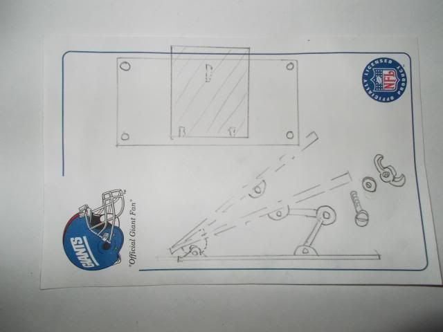

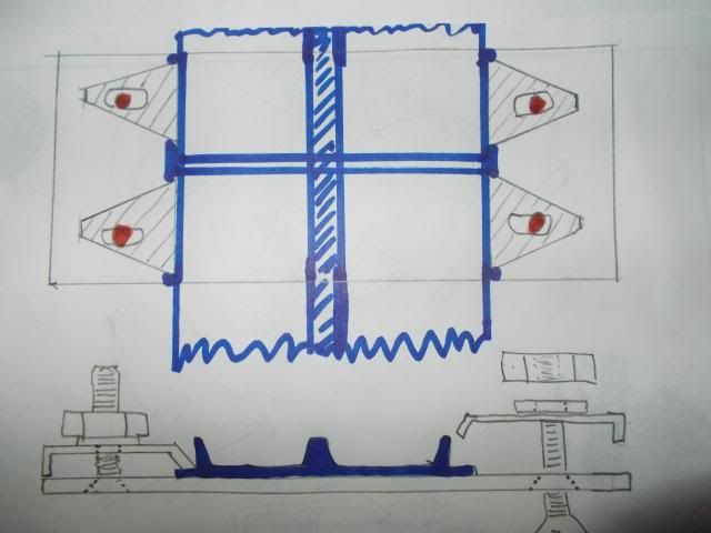

what track are you transferring to ? ... steel clamps /slots [later "crushed" with vise-grips onto the blue track's edges ] are welded on one end of a steel plate, with hot wheels track retainers [washers] welded on the other end ?
optional holes are for 6-32 countersunk screws, if you need more hold down in the center of the blue track lanes...
send me a 1/2" bisection of blue track for measurements, i'll make you a steel union....what we Smiths do !
Actually trying to make smooth transition from the 18ft piece of blu track to a 7ft piece of blu track..... will send you a sample.

Any ideas on how I could make a smooth seam between my 2 sections of track......
