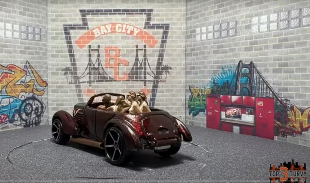

I add more diecast using 190° low temp casting alloy
or, brass strips drilled, tapped and screwed together
but, as people will attest, my cars are a bit different
American diorama girls add 5 grams each
the gasser at 905 has a 15g cast parachute
22 grams of girls here
(FYI, I am the reason for the bikini rule...lol)
