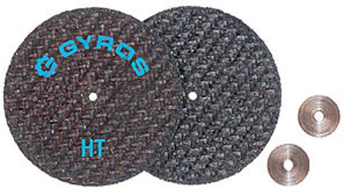

I've never used the #119 but it looks quite handy for cuts maybe. And while I'm sure it's the "wrong" bit to use, I use one of the Gyro disc bits when I have to like cut out chunks or squares or something. They get chewed up quick but it does the trick. (I use it because it came with my Dremel set, never bothered to try others)
