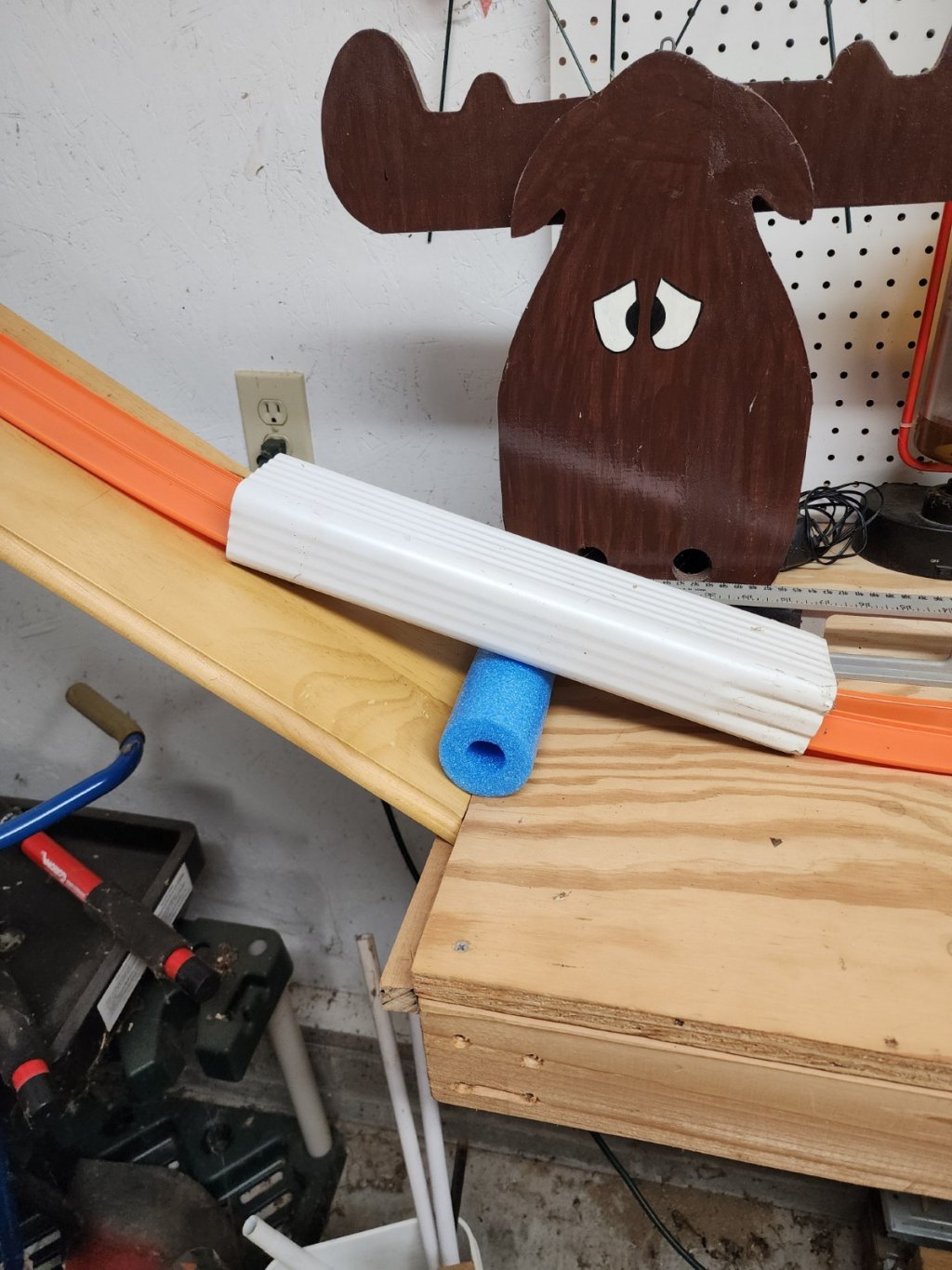

- Very true. If you ever run heavyweight or super heavies, they'll make the track flex where it is not supported well. — redlinederby
- looks like your bench is not happy with that setup! lol — Stoopid_Fish_Racing
- Lol! Those screw holes do look like a face. — Dutch_Clutch_Racing
It's maybe a little hard to see in the photo but I used a some flexible panel board to give support at the transistion. There are 2 small screws you can't see off to the left where that panel board is attached to the shelf board. The 2 long screws you can see in the pic have a spring between the panel and base board that gave it some strength. It also let me adjust the levelness of the curve by loosening/tightening the screws. Probably over-engineered it a bit but it worked pretty well overall.

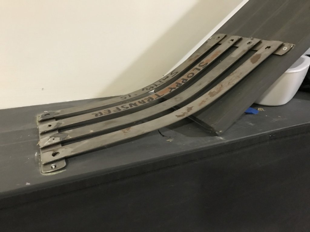

Aha...through that other thread found another thread showing a point in my tracks life where it had a welded steel transition support that member put together for me. Smitty was a fabricator and probably made it with his eyes shut. He sent it to me flat so I could bend it to my needs. I'm not sure my bend was even but damn did that thing hold the track solid. Wasn't no car gonna make it budge.

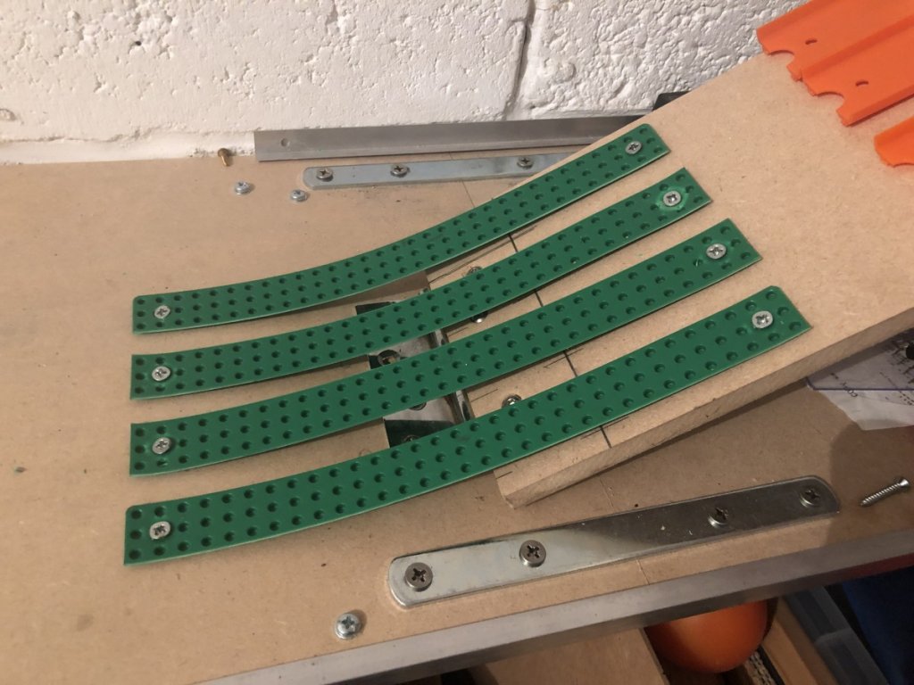

And yet another whump solution...Lego! Similar to the steel thing above but much easier to create.
No whomp or sag with this.
