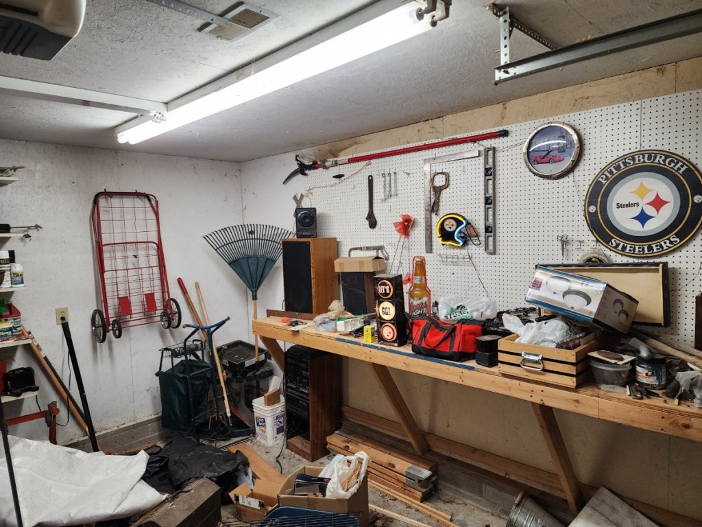

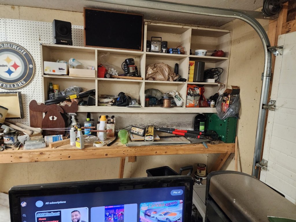

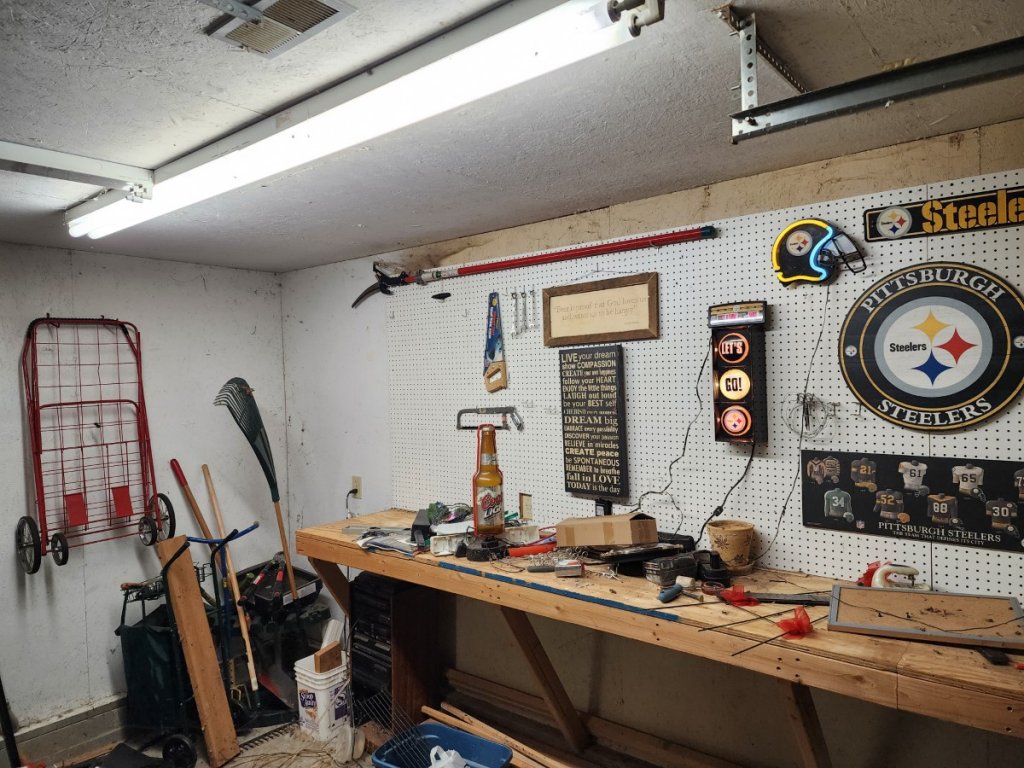

I am thinking of building my 1st track. Mainly for testing my cars at first and maybe racing in the future. Looking for a scale 1/4 mile. Bench I would build on is 19 feet. Adding a drop hill from the end of the bench would make everything approximately 23 feet. Allowing for some finish line cushioning. Just not sure where to start after the bench is cleaned off. Track would run left to right if that matters. Any tips, tricks, advice, pointers, help, etc would be greatly appreciated.

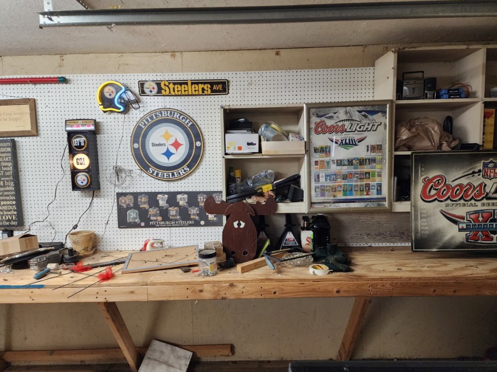

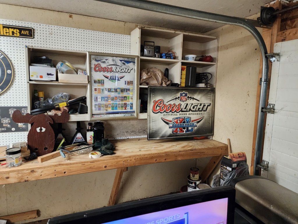

Little by little, I'm slowly making progress.

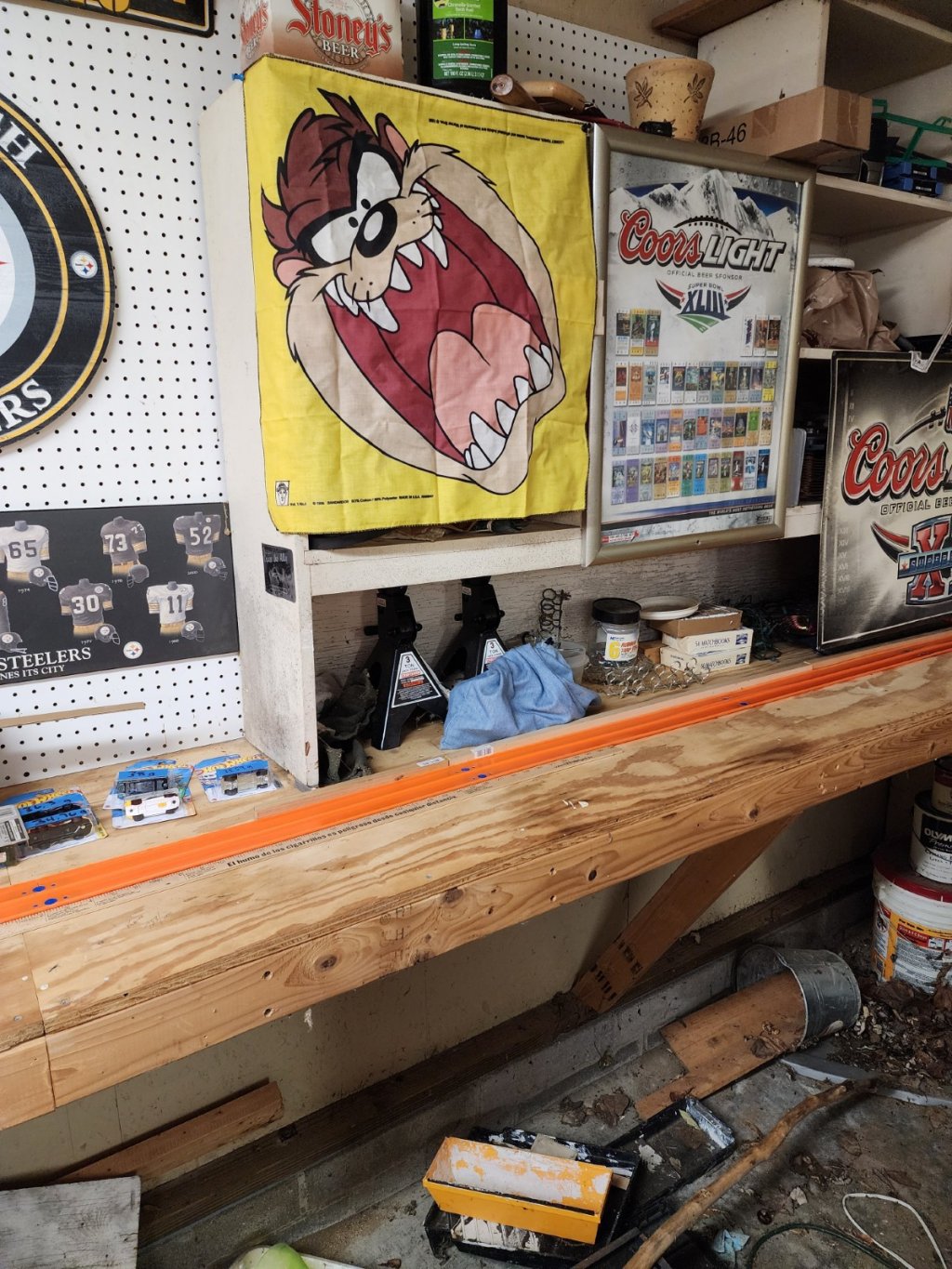

- Coors decorations really bring it together. I like the vibes — ConMan_Customs
- Progress is progress! — JBlotner42

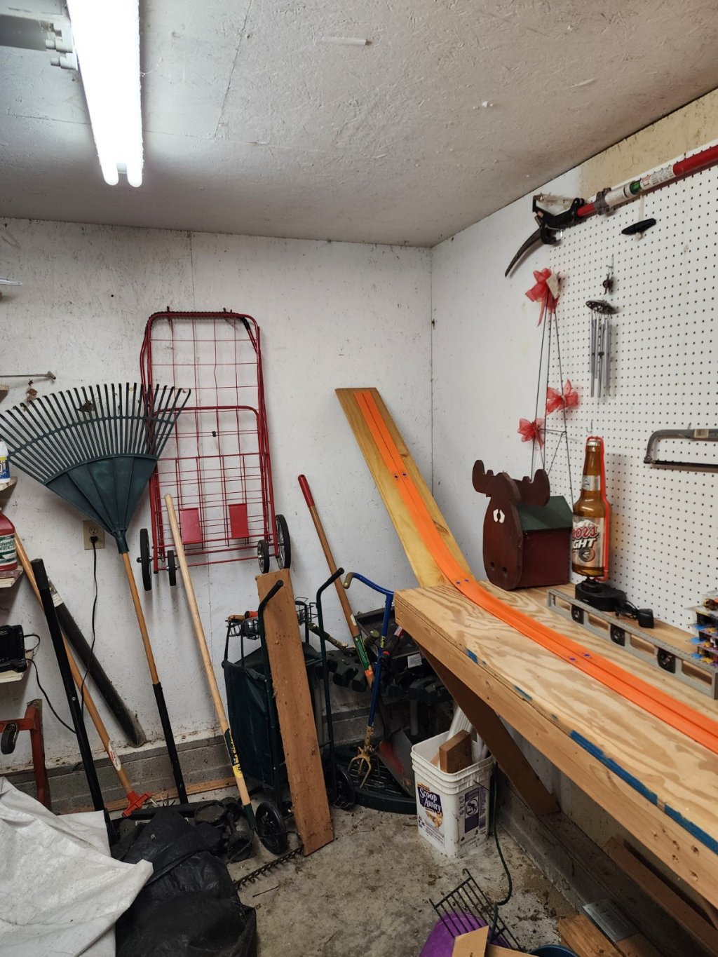

Thanks. Coors Light signs are from the bar that I used to own. Plus it's my preferred beer of choice. Probably going to the store tomorrow to get what I need for the drop hill and the track to lay down.

My track pieces should be here Friday. Don't know that I will get it built this weekend since I have to work all weekend, 12 hour shifts. Will be doing a couple videos with my progress so far, cars from my childhood that are probably 40 years old and what I found when I was out hunting today. Check my YouTube channel this evening for those.

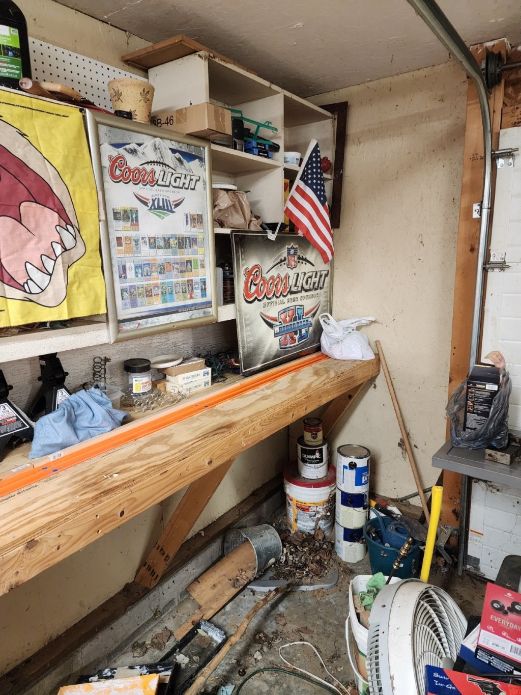

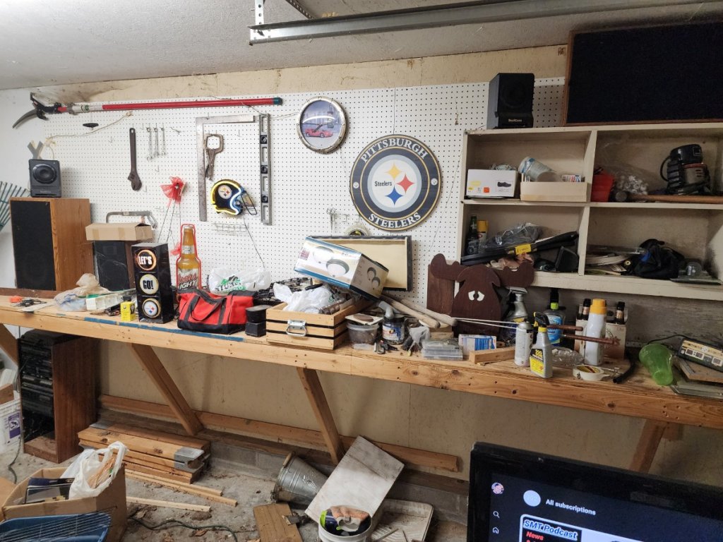

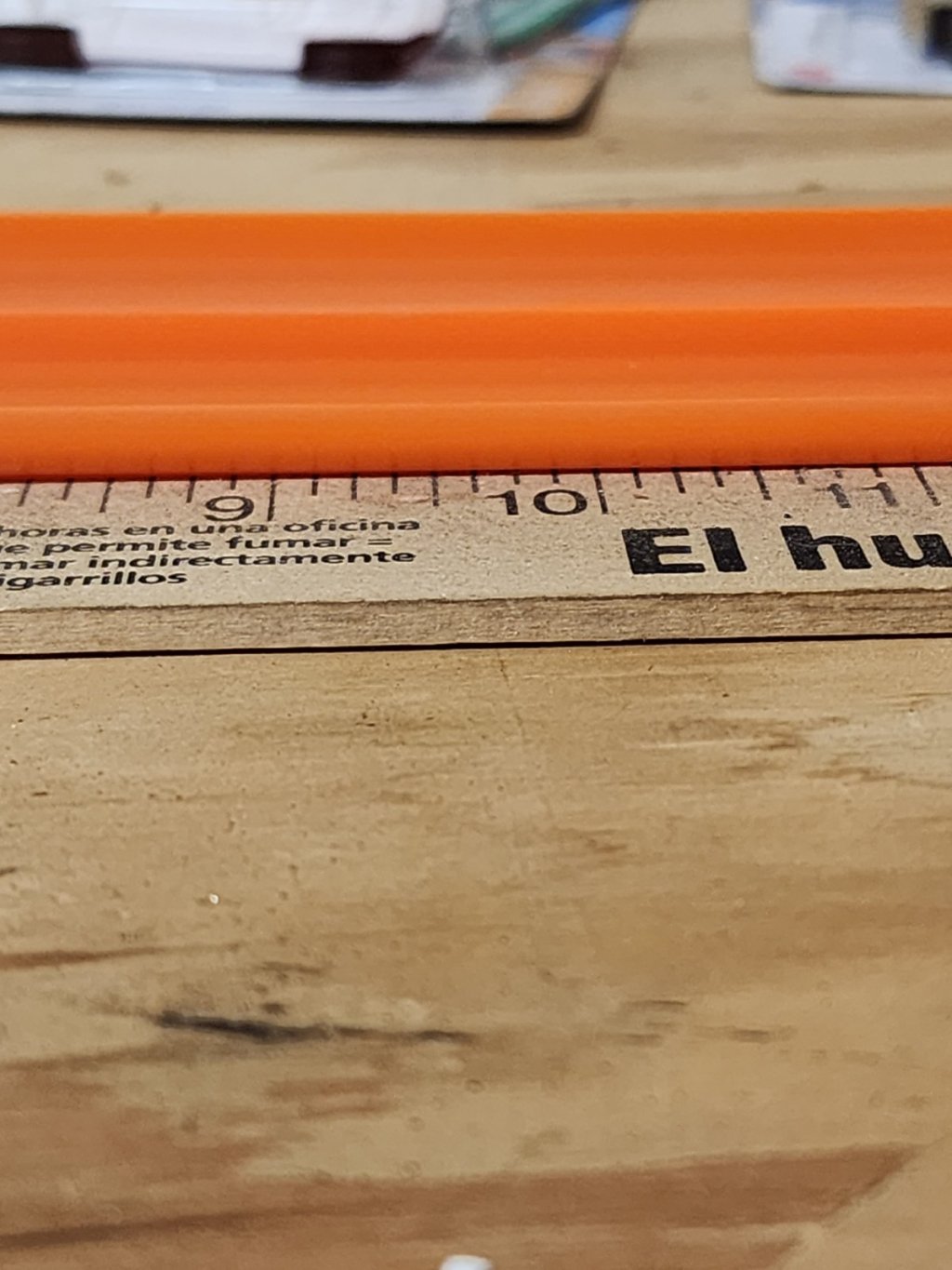

Making more progress. Still need to decide on a start gate and finish line. Don't know if i want to start cheaper and upgrade later or go straight for the upgrade. Think im going to use yardsticks screwed to the bench to hold the track in place.
- 3/4 inch square pieces of velcro work pretty well to hold track in place and is fairly inexpensive. — Dutch_Clutch_Racing
- Does the velcro affect the flatness of the track any? — SteelCityMafia895
- Yes it does. I figure it same size velcro in same locations on the track it's as fair as it can be. And of course alternate lanes. Seems 1 lane is always faster than the other. — Dutch_Clutch_Racing
- Velcro before and after the "whomp" helps keep things the same from 1 lane to the other also. — Dutch_Clutch_Racing

- I've found out that the track strip pieces are not cut equally. Small difference in lengths, but noticeable over a long length of space. — SteelCityMafia895

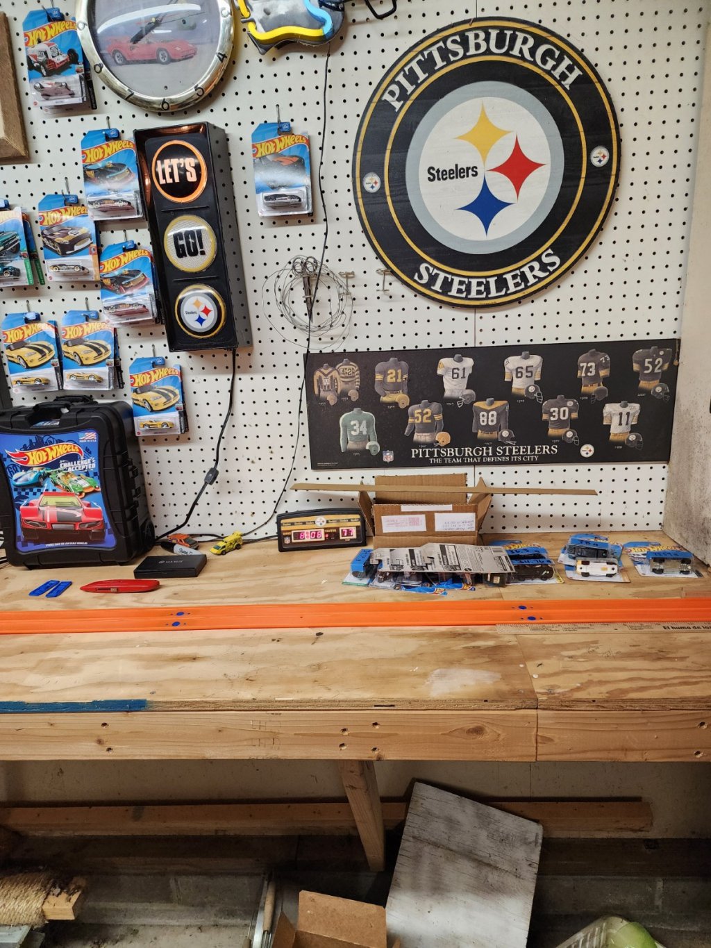

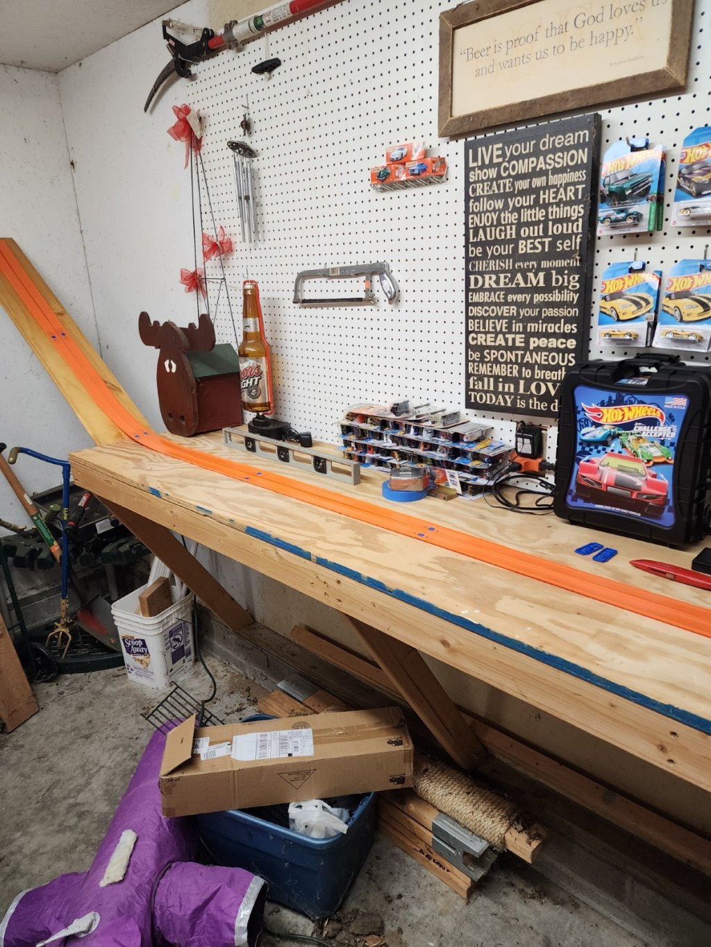

Redline Derby's shelf idea inspired me this weekend. Now I have a 14ft. test track instead of the 8 ft. I had.
- I thought I was going to have enough for a 1:64 scale 1/4 mile. At that start height it only gonna be 18 or 19 feet unless I want my wall to be the finish line. Lol! — SteelCityMafia895
