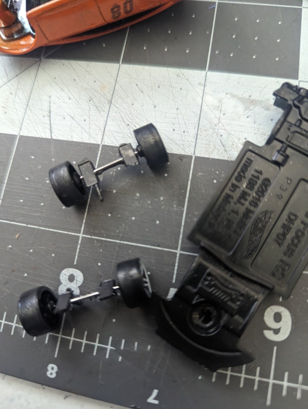

Need some advice on gluing axles. I recently had a glue failure on axles during final testing. Car was running well then suddenly stopped. On further inspection, all four wheels were rubbing the casting when they had not been before. On disassembly the JB quick I used to glue both axles had failed.
Any advice on better ways to secure them so they do not fail mid race. I suspect this maybe a potential cause of some of my recent more abysmal showings.
Edit: I do not typically include the seating insert. If I can paint the windows makes weight appropriation much simpler. So I'm relying completely on glue to hold my axles in place.

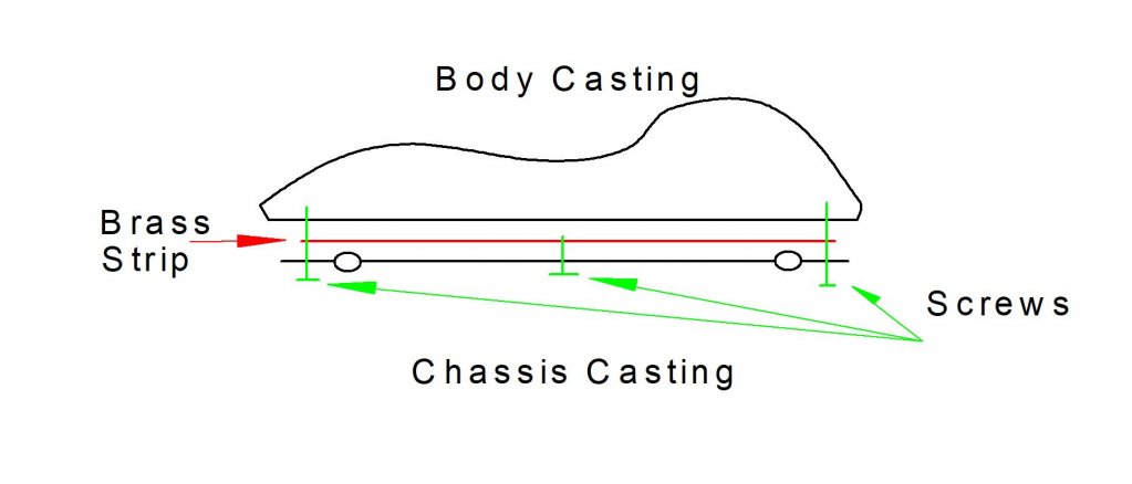

I am doing things a bit different, I take the plastic bottoms and using a 1/8" router bit in my drill press,
make the bottom between axle saddles flat. Then I fit a brass strip and put a single screw in the center, the brass can be tightened and holds the axles while fitting out the rest of the chassis. I put the JB between the plastic lower and the brass, tighten it, inspect for side to side centering, and put it on the jig
I seems the JB grabs the brass better than untouched plastic, but when you mill out the bottom it roughs up the plastic nice.
simple diagram below
- So you're not putting any JB on the axles themselves? The brass gets fixed down and that squeezing keeps the axles in place? Kinda like old Matchbox style. — redlinederby
- Like the old HW/MBX style, he has the screw in the middle - that allowed the axles the float up and down for a rudimentary suspension. However, from the diagram, he also placed two more, one at either end of the strip, to tighten things down even more. Not a bad system, actually. — SpyDude

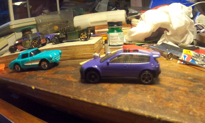

This is my latest evolution
the honda civic hatchback I am finishing and packing today

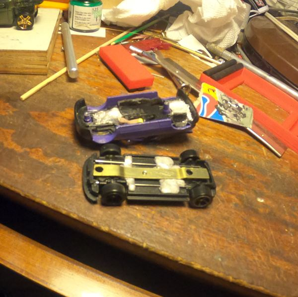

Two screws hold the body on,
158°F diecast weight/spring mounts
brass spine and axles stay in place, held with the screw
I will put a small dab of JB Q to keep the axle from sliding in and out
the 2 piano wire springs hold the axles in the chassis
remove the screw, peel off the dab of JB, and swap axles easily
don't glue the axles till the car is at ship mode
this design allows for testing different combos (axles/springs) before final assy/ship
interior is sanded and jewelers saw cut
die cast girl has lost her feet for clearance
any questions feel free to ask
- I gotcha. And it looks like your screws tap into the car's existing posts, right? Nice way to do some testing. Hope all the effort yields you some checkered flags! :) — redlinederby
- gotta keep trying either way...lol — dr_dodge
- That's a sweet setup! — SpyDude
