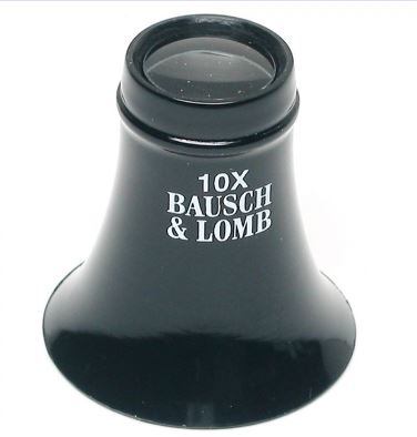

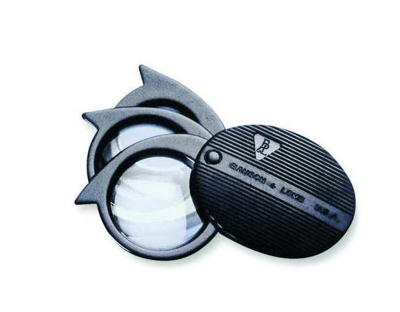

A question was asked on the wheels thread, what was a jewelers loupe.
That got me thinking, I've got many tools I have at my disposal, but ALWAYS want more.
But if I was just starting what would I buy, and in what order?
I figured I would start this so builders, both novice, and advanced have a clue what are used.
First to answer the first question;
A loupe is basicly a real good magnifying glass.  Cheap and worth their weight in gold.  I prefer the first style as you hold it on with your eye muscles, 2nd need your hand to hold
