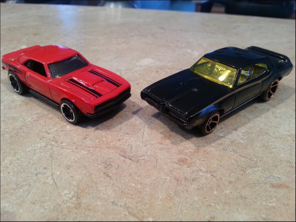

Finding replacement axles and wheels
The first step is finding a donor axle/wheel pair that will match-up nicely with the chassis you have picked out. Ideally, finding a same-model car with FTEs or the likes is easier, but you don't have to find the same car. Just look for cars that have same axle width, and if possible, wheels of the same size.

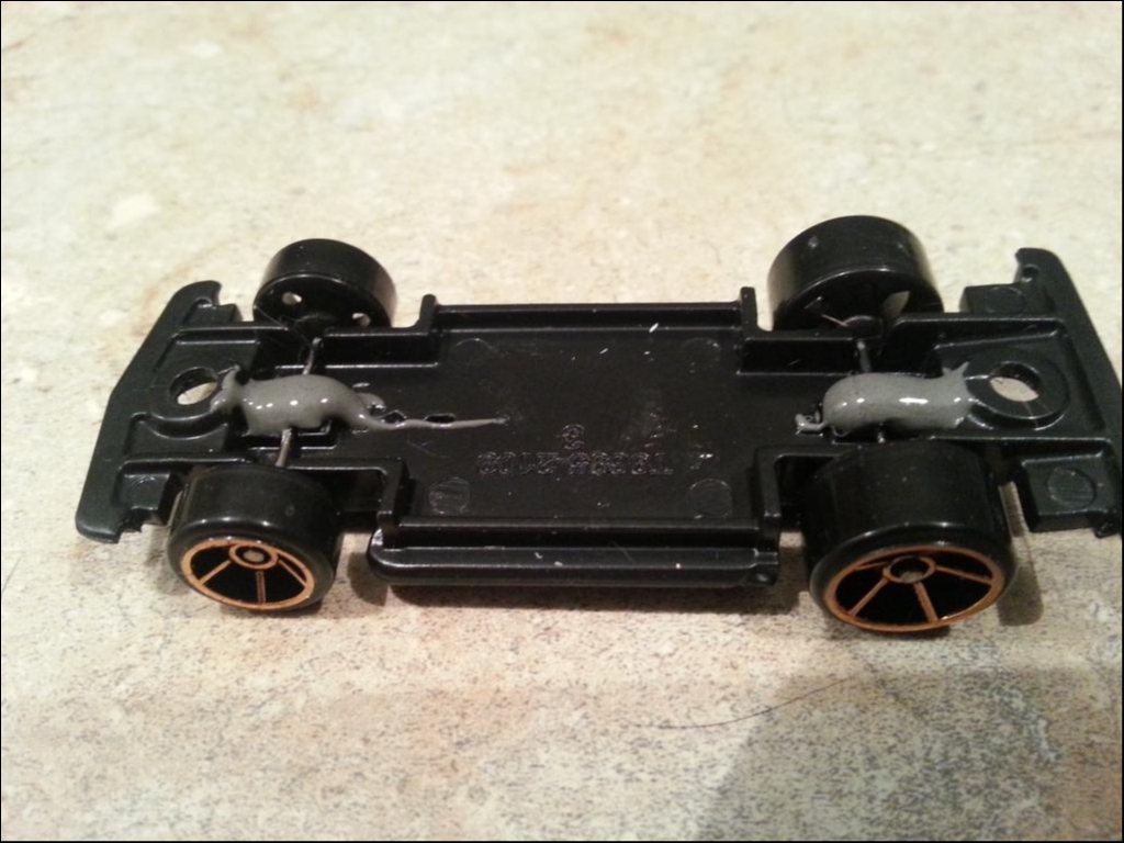

Affix the new axles
Once you're confident the axles are in the right spot, use a few dabs of JB Kwik to affix the axles to the chassis. I recommend you use some sort of jig to keep things straight. Even some pencils or straws will do the trick...just make sure they're straight. Flip the car over and put some weight on top to keep things tight.
