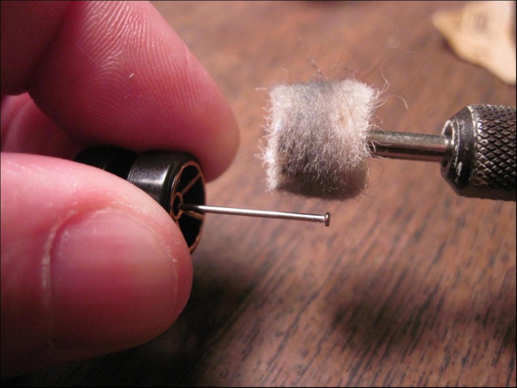

Next, try polishing the axle ends where the wheels will ride. Using automotive polishing compound and a Dremel with a cloth disk works well. Polish one end at a time being careful not to let the wheel slide into the compound. You don't always need to have FTE axles! If you can find them, great, but don't underestimate a non-FTE axle that is well polished.
