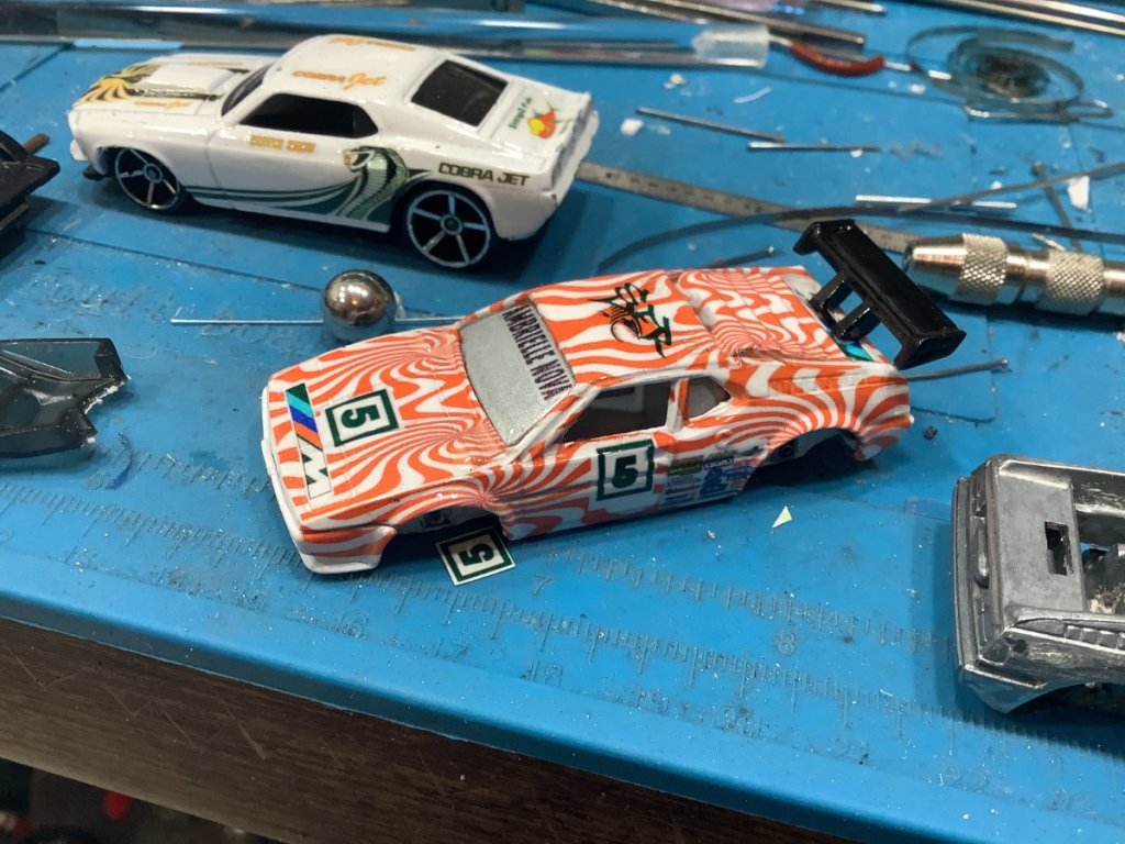

my latest in progress... a custom full body decal set on a BMW M1 for an upcoming race series. This is in 3 parts, top, left and right... if you look closely you can see how the setting solution helps it conform to every detail on the body... even the slats and the side detail... it is a must for a good quality job.

  • that is stunning! — dr_dodge
  • thanks mate! — Stoopid_Fish_Racing
