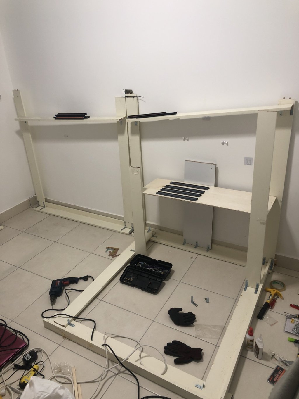

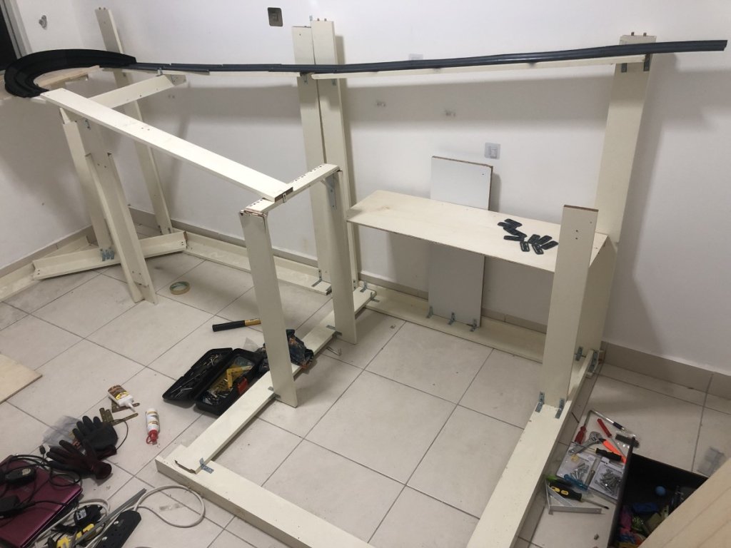

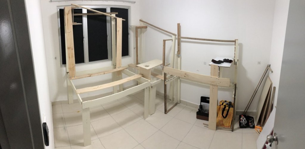

Building my first diecast racing track! Im from Malaysia. Thank you guys!
![](/images/avatars/default_avatar.gif)
fhk_diecastracingmalaysia Sunday, 6/4/2023

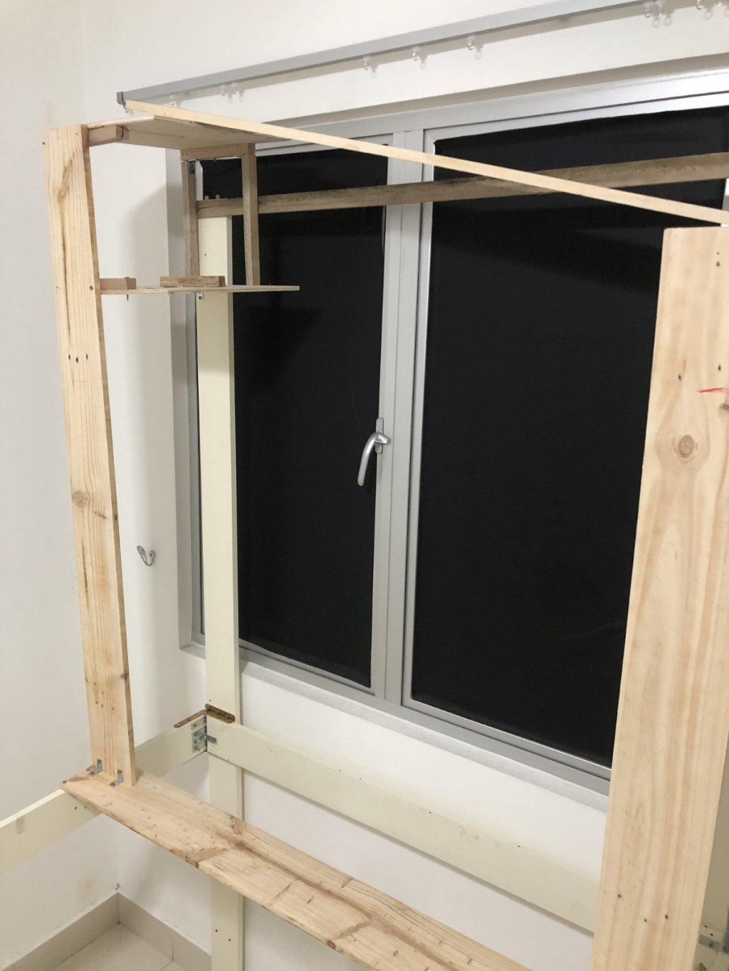

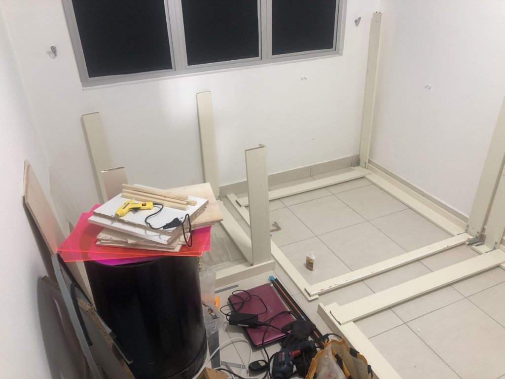

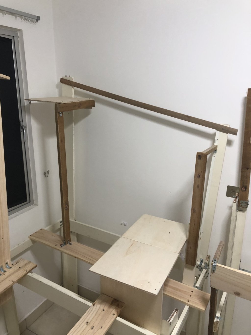

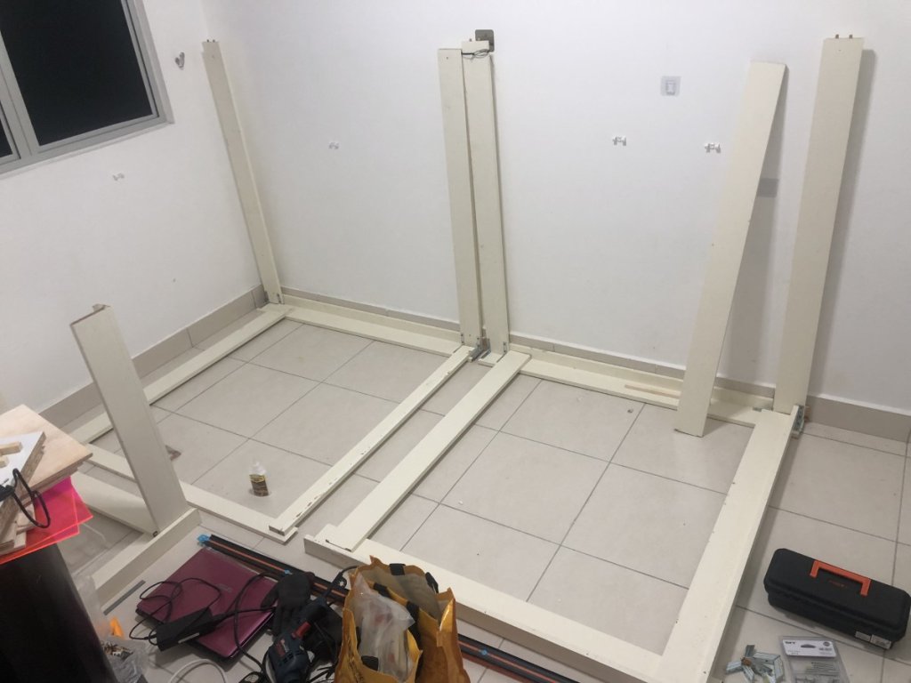

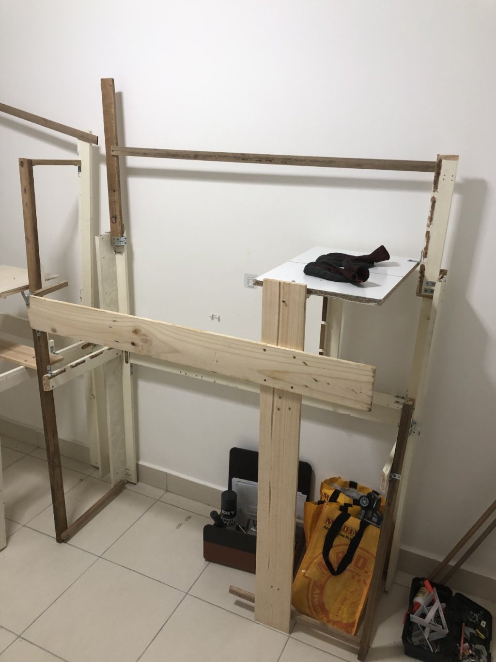

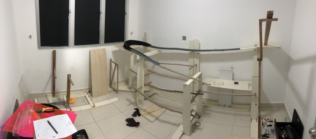

There are no stores here that sells fat track, so i have to buy it from amazon, ebay or etsy that ships to Malaysia. And the price is very expansive but i guess ill just invest in it so i would finish my track. I cant find any Malaysian doing this whether on youtube or any platform so i just make one to see if theres any interest from my country. Ill update my track here. Any tips and suggestion would be welcome and i appreciate it. I dont have any name for it yet and any plan for the travk layout but after i bought the fat track set from amazon or ebay ill post and update it here. Cheers!

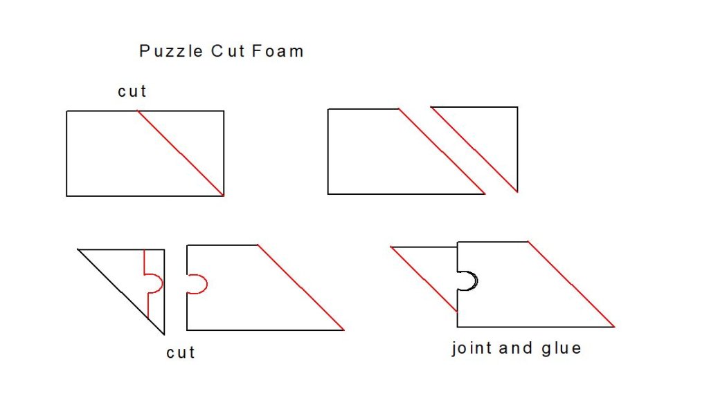

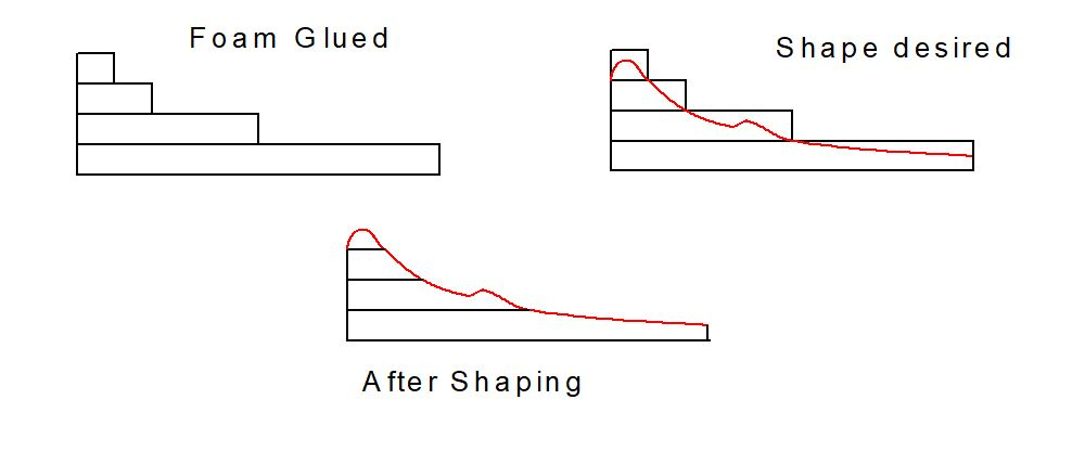

I carve pink foam into panels for many of my diorama models. Use the 2" thick stuff, and cut panels to fit. I use a band saw, scroll saw, an a big knife. Sand lightly and surfaces to be glued together, and use wood glue. The panels are very rigid, and need no support in the middle. You can "puzzle cut" the edges to lock together, too
the foam I use (2" thick)
To create hills and backdrops
to make a complex shaped bottom panel, the puzzle cut,
you cut a circular hole at an edge, mark that on the next panel,
carefully cut/form, and the 2 panels will hold together.
Not bonding in straight lines helps hide the seems
it will also make amazingly strong boxes used vertically and horizontally
done right you end up with easy removable panels,
