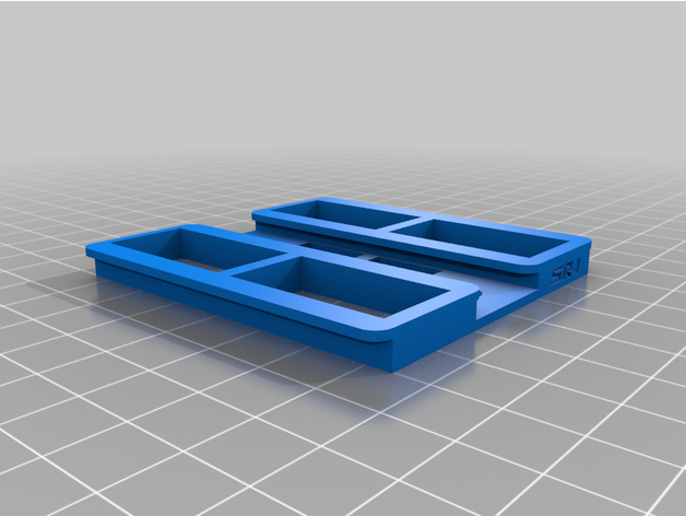

I just built a permanent scale 1/4 mile track in my basement. Lane one has a clear advantage and I'm not sure what to do. I'm using spoolheads racing SR1 lane connectors which are nice since they allow me to screw them into the base, but they do make the track a little wavy.

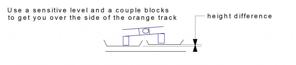

I would measure the track before I did anything
go every 6" or so, use a sensitive level, and 2 blocks.
take a measure, swap the blocks and remeasure
It could be a slight differenct in their heights, and that could just be shimmed up

Good call out FredD, i'll try swapping the tracks and if that doesnt work, maybe i'll try just laying it on the platform. I just like the connectors because everything is on there tight and the track doesn't really like to pull apart.
I'll look into leveling it out with some legos too. That's a clever way to measure that.
