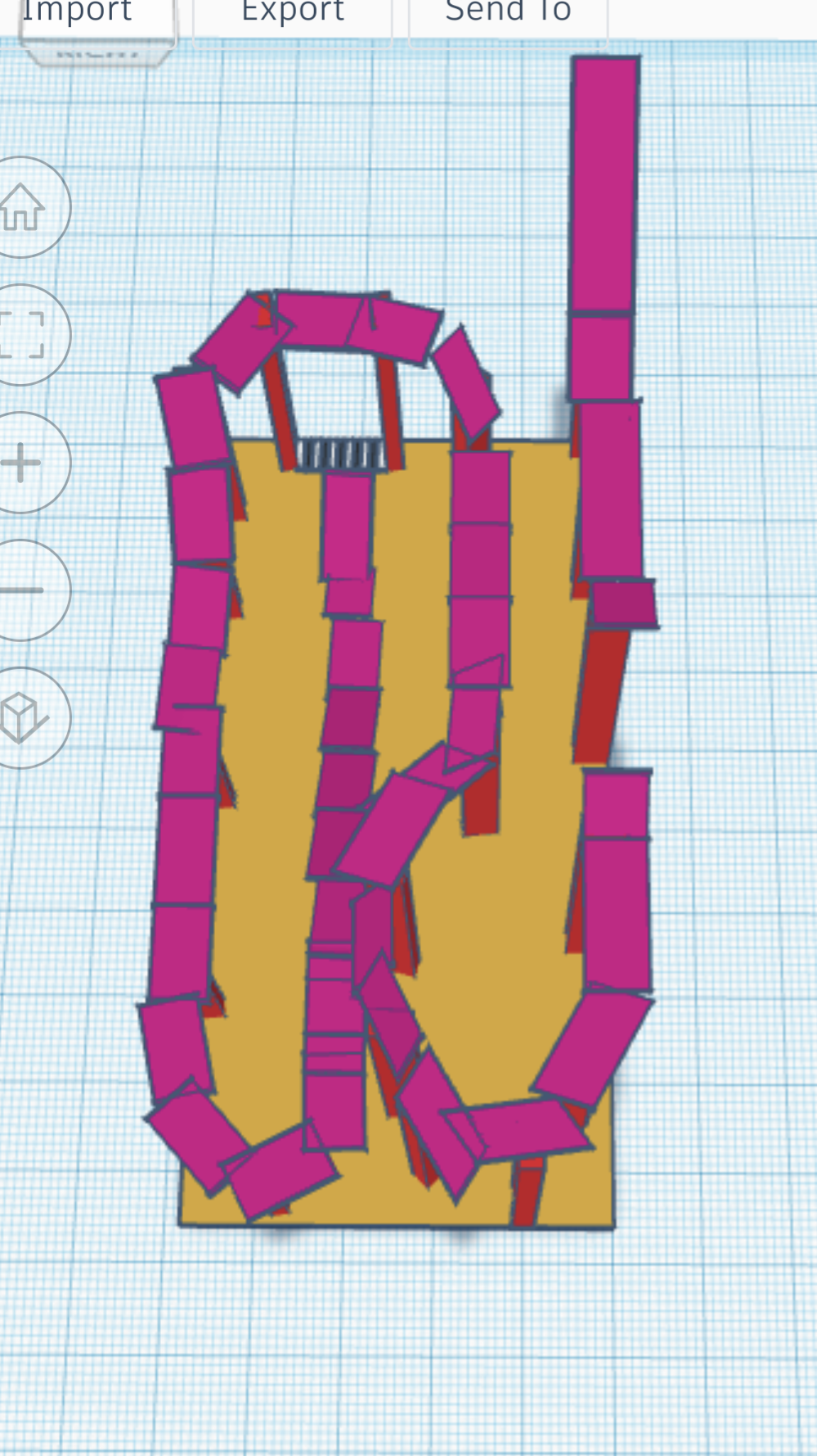

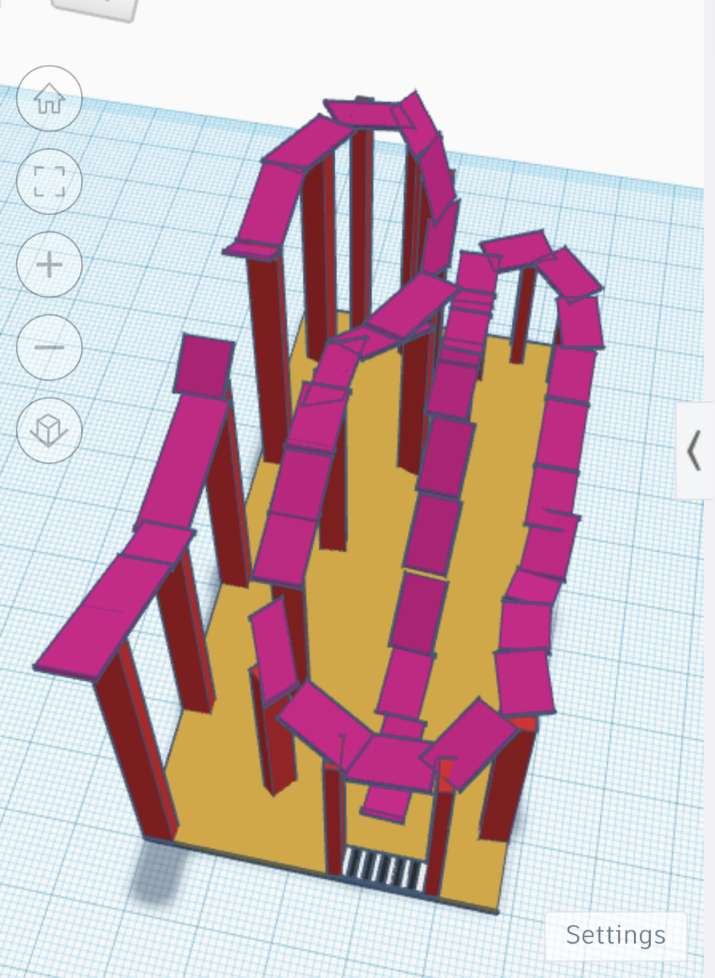

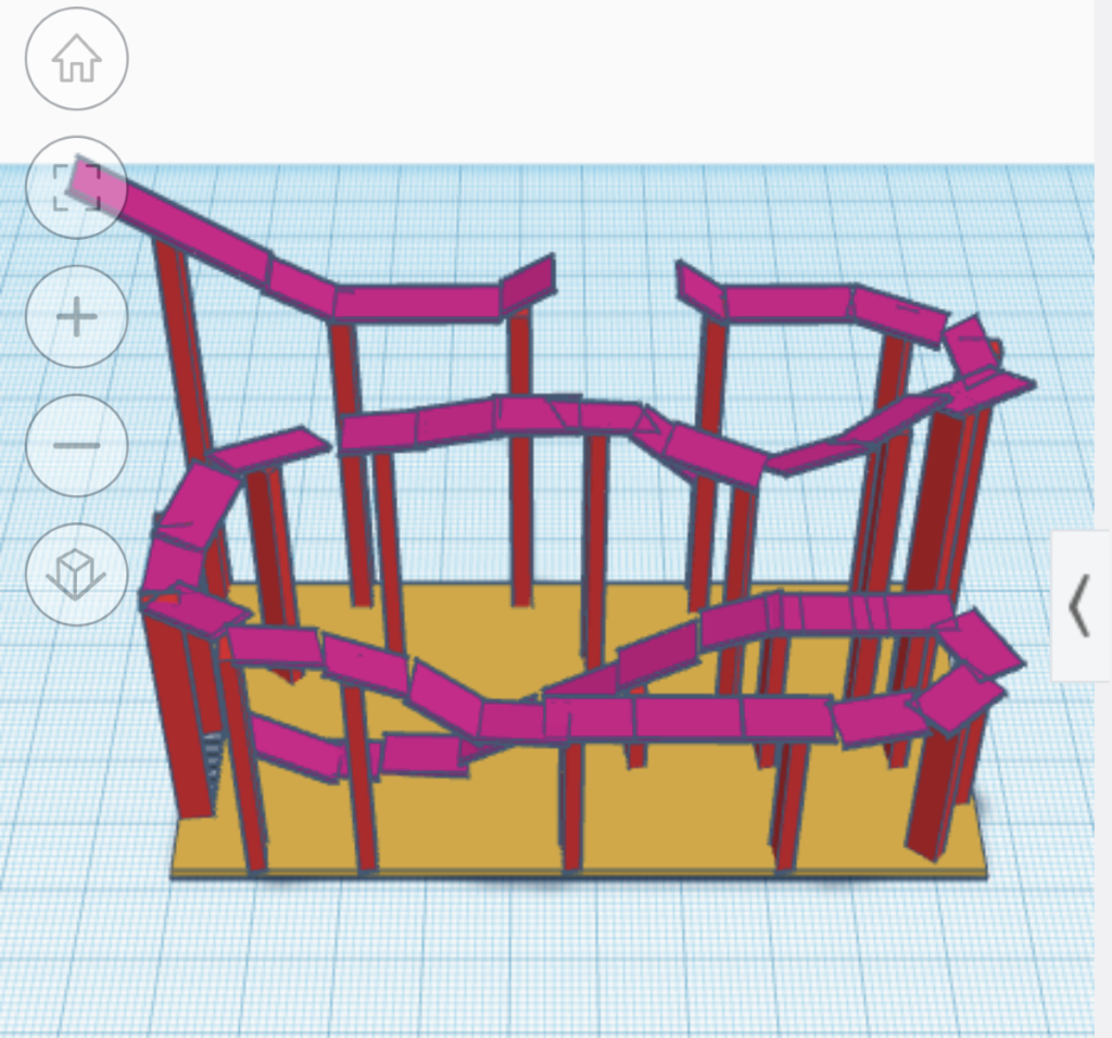

Calling All Monster Truck Fans! Feedback Needed on My Custom Track DesignHey everyone at Redline Derby! I'm a huge Monster Truck enthusiast, and I'm finally building my own custom track for epic diecast races! I'm here to share my rough draft design and would love to hear your feedback and suggestions.
Track Specs:
 * Scale: 1:64 Monster trucks
 * Materials: I'm contemplating getting a 3D printer and printing my own track.
 * Inspiration: My inspiration came from watching real monster truck races. And watch 3D Botmaker and realizing that there are no races similar that use monster trucks
Track Layout:
 * I'm limited on space, so everything will be built up from a 4x8 piece of plywood. Elevated by 2x4s to support the weight of the track and trucks.
 * Starting at a height of ~6' tall, it drops down to an early jump, and then Into the first 180° (or 225°) turn. Going back to the other side, where it'll have 2 90° turns, where it'll go into the next straight away. After the last big turn, it'll have a down ramp into the final jump finish line.
 * I haven't found any other side by side downhill courses like this. It'll be a challenge for sure, that's why I'm asking for help
Feedback Wanted!
I'm still in the early stages of building this track, and I'm open to any feedback or suggestions you might have. Here are some specific areas where your input would be appreciated:
 * Functionality: Does the track layout seem fun and challenging for Monster Truck races? Are there any sections that might be difficult to navigate or need adjustments?
 * Safety: Are there any potential dangers for the Monster Trucks on the track (e.g., sharp edges, jumps that are too high)?
 * Aesthetics: Do you have any suggestions for making the track look more visually appealing?
 * Additional Ideas: Do you have any cool ideas for obstacles or challenges I could incorporate?
Thanks in advance for your help! I'm really excited to bring this custom track to life and share some epic Monster Truck races on my new YouTube channel
Looking Forward to Hearing From You!
P.S. I know the rough draft is pretty rough. It was the first time using any 3d modeling software, but I think it still shows the idea of waht I'm shooting for.
JBlotner42 5/7/24
I like your layout. If you can pull it off it will be amazing!
I have a strong suspicion that the monster trucks will not corner at all like you expect them too. The high CoG will most likely cause the trucks to tip over in the turns. The rubber tires will also cause extreme loss of momentum in the corners. I tested rubber tires on my track with a few "real riders" and the results are clear.
There is a Facebook page that does monster truck races. www.facebook.com/profile.php?id=100089062472797&mibextid=ZbWKwL
Might give you some ideas! Looking forward to what you come up with!
  • Thanks for the Feedback! Hey JBlotner42, thanks a lot for taking the time to leave a comment on my post! I really appreciate your insights. Addressing Concerns: You're absolutely right about the center of gravity (CoG) potentially causing tipping on sharp turns. I hadn't fully considered that yet. That's a valuable point, and I'll definitely need to factor that in when finalizing the design. Clarifying Tire Material: That's interesting to hear about your experience with different tires on your track. Perhaps you meant tires with more aggressive treads or softer materials for better grip, as opposed to standard plastic wheels that come with most diecast Monster Trucks? Exploring Solutions: Regardless of the exact tire material, your point about grip on turns is well-taken. Maybe I can adjust the curves to be banked more steeply to help the trucks navigate them better. I'll also look into alternative materials for the track surface that might offer more traction for better cornering. Thanks for the heads-up about the Facebook group (www.facebook.com/profile.php?id=100089062472797&mibextid=ZbWKwL)). I'll definitely check it out for more inspiration and tips from other Monster Truck enthusiasts. I've definitely watched their videos on YouTube. They have built a great track for monster trucks, with a big downward ramp and 2 big jumps. It's great to connect with people who share this passion! I'll keep you updated on my progress and any adjustments I make based on the feedback I receive. Maybe in the future, we can even share ideas and learnings from our respective custom tracks! Thanks again for your comment! One idea I had, was to possibly make the track single truck wide at first. It would definitely be less material, and maybe just do time trails. It would be less exciting (without having side by side racing), but it could be a starting point, and then expand the track later on. It's been hard to find STL files for curved tracks for 2 trucks (equivalent to 4 regular lanes). — Titan
  • Hey Spartacus0351, So the hard plastic tires are better for drag racing and downhill road courses. Rubber tires of any sort, knobby or textured or even almsot smooth create too much drag/friction on the track and slow the cars down considerably through any corner. As far as maing the turns for monster trucks, I would tend to lean more towards wide turns with a shallow bank and steep downward angel to keep up speed and reduce the effects of the high CoG. — JBlotner42

I have tested with monster trucks a bunch, and as said, they tend to flip with very little effort.  They also turn into the first tire that hits something, and stall
my off road track
www.redlinederby.com/topic/call-it-a-wash-off-road-track/5407
https://www.youtube.com/watch?v=_s4IS_g23o4
I would bust out the hot glue gun, some cardboard, foam board, and cardstock and mock it up
Start at the bottom straight and work your way up on corner at a time
You can then transfer the design to better materials later
  • I want to start off by saying your track looks really good. The deisgn and and detail look really good. Yes I do agree the trucks can tip and roll easily. But to try to midigate that, Im planning on starting each truck in Hot wheels tracks, and then transition to Crash Racers track. Since crash racers is designed for 2 regular cars, I think it would work perfectly for a monster truck, without moving around too much. Also with the bank turns thats come with crash racers, I think they would work good for bank 180 turns. But yes making a mock up of my course before building is a great idea. thank you — Titan
Chaos_Canyon 5/13/24
I've put monster trucks down my regular tracks before and they can work but here's what I've found
1. You need a steeper than normal slope as the wheels are a solid axle that has a lot of drag, so to give them momentum you need a solid drop
2. As mentioned above, if a wheel touches a side wall or obstacle, they will turn into it very easily and stall/flip/crash
3. Cornering is tough and you will generally need a large bank in the corners to get them round.
4. A good way to guide them in a laned section is to use a barrier under the trucks, rather than side walls.
You can see a few monster trucks runs on my channel. The earlier one is Stuntman Sam running a monster truck down the original canyon and he made it the whole way but after many attempts. youtu.be/DDkiFQ7DQNY?si=AvEaP_UxCgUWQML0
The other track run is at the end of my camper chaos video and while vans towing caravans make it the truck can't make it very far as the track isn't steep enough and you see the wheels wobbling around. Here's that video youtu.be/IFr7NMiurYI?si=QfttvdWZS7xbJJPo
In my beach run, I start the trucks in the same place every time and where they end up varies dramatically due to the body roll changing the wheel direction  you could look to secure the axles but then they basically won't turn  youtu.be/OPXO19nXTLw?si=2O72aQwe1MsiOEDW
Flat Rabbit did a series of monster truck races in a short course and they were fun but it's a short straight track
best of luck with your idea, but I'd also suggest hand building tracks to begin with as it is a lot faster and cheaper to prototype compared the 3D printing
  • Listen to this dude, he knows his stuff! — JBlotner42
  • I have though about some piano wire springs to "dampen" the monster truck body roll, but have not done any good experiments. and the cheap monster trucks behave the same, too — dr_dodge
  • Let me start off by saying thank you for your comment. It feels really good to be able to have this feedback from everyone. I really want to get this idea to come to life. It’s something that I’ve wanted to do for a while, and its different than any other die cast racing I’ve seen before (at least with monster trucks). I just wanted to address a couple of your points, with some of my ideas that I’ve came up with. #1) that slope of the track. I don’t want the trucks going too fast, because I’m trying to replicate Monster Jam racing. So currently I’m going with a 10 degree decline for most of the race. Actually, with that in mind, I do have another track design that I will be posting soon. It’s a little shorter and its about 22’ long, roughly. #2) I feel like with enough speed, I think it might not be too much of an issue. I’m going to be using hot wheels track at the start of the race (2 lanes per truck), and then switch to crash racers (1 lane per truck). Each truck will stay in their own lane for the entire race. I don’t think I’ll be opening up the track, I think it’ll be too wide for the trucks. #3) Yes corning has been as issue for me to figure out. This is my plan so far. For a 90 degree turn, I recently order some tracer racers 90 turns. I’ll get them in a couple days and test them out with different speeds and different entrance angles. I feel like it’ll work. Also, I’ll be getting a couple sets of crash racers for my 180 turns. With my current idea to race two trucks side by side, I was trying to figure out how to make an outer and inner 180 turn. Since crash racers turns are in 5 pieces each, I’m planning on take one piece out from the inner track, and putting it in the outer track. And with that, hopefully it might work. I feel like the banked angle is good (with the right speed), I just need an inner lane and outer lane. And with back-to-back 180 turns, there won’t be too much of specific lane advantage. I very much appreciate the videos you’ve done with Monster trucks going down a track. It further reminds me that its possible to do full tournaments with only monster trucks. I did watch some of Flat Rabbit, his videos have a lot of good elements to them. Just like some other channels, they mostly just do a straight track, or a drag race, with a jump at the end. Which is great, and I enjoy watching them. I’m just want to try something new and different. Thank you. — Titan

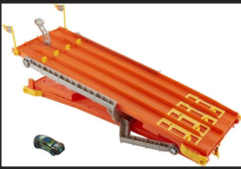

While yard saling I ended up with one of these
I just stripped it out for monster truck launching
I cut off the "flippers" at the end
will launch 2 monster trucks  of 4 cars
and if you haven't seen it
www.youtube.com/watch?v=jc1c7EdagwQ
  • That track is called the 4-lane elimination race. I don’t know if its still in production or not, but definitely a good find. I’ve had a couple of different idea of how to start my races. I didn’t want to use the 6-lane wide track that a lot of people use, I wanted something different. So, I’ve came up with 2 different Ideas. My first one is to use the launcher from the hot wheel race crate. Its 4 lanes wide, and Amazon sells that piece individually. I could easy launch 2 trucks side by side with a that piece. My second idea I got from scrolling on Etsy, while looking at customer hot wheels track pieces. I came across a listing called ‘Ultimate Monster Truck Add-On Jam Set | Hot Wheels Compatible’ and it just happens to have a 4 lane start gate, in addition to some extra obstacles that I could use for my track. So, I still don’t know which one I will go with, but I still have some time before I start building. The video you put up from Monster Truck Attitude, is definitely a good channel. He has a lot of excitement and energy in his voice. The way he has built his area and track is really good. Building it like a Monster Jam area and even adding a slight echo to his voice, makes the Monster jam area sound even more realistic, which is great. For me, the track is just a little short. I want more of a downhill race track, but to try to resemble that they would do at a Monster Jam event. It might be hard, but I think with the right angles, banked turns, and with the right speed, it might be doable. — Titan
  • you got me wanting to try and glue one up. maybe build it like a volcano shape. and yea, the guy above really makes it feel like a stadium event — dr_dodge

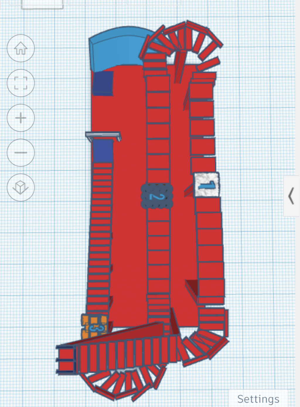

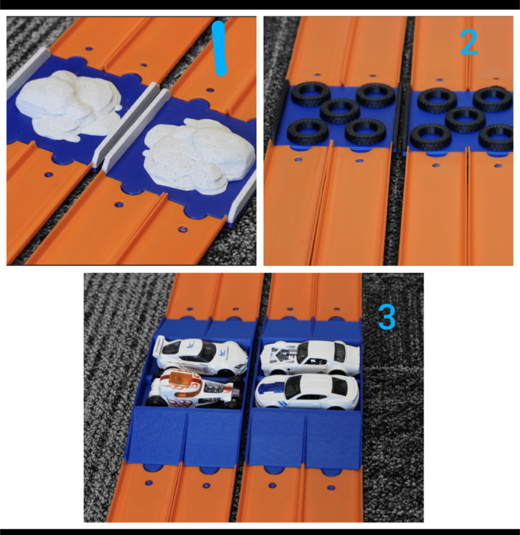

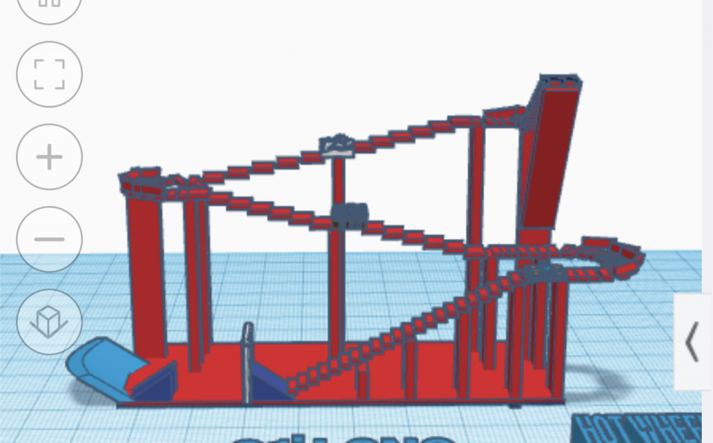

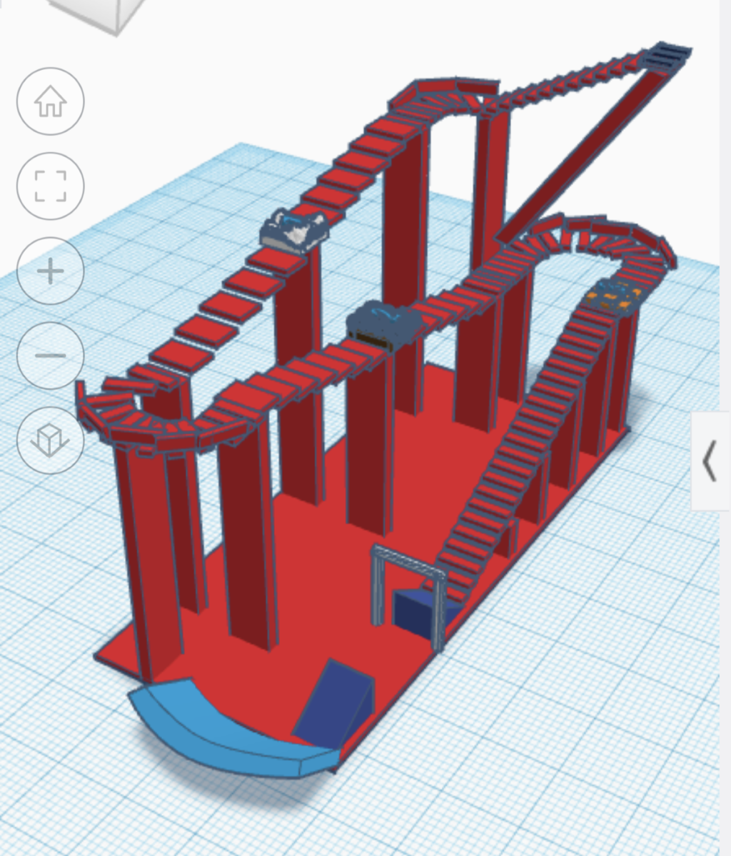

I'm here to share my latest project: a brand new, custom-built Monster Truck track! It's been a blast putting it together, but I'm always looking for ways to make it even more epic. My inspiration for this track, was the brand new monster truck track at the world finals in LA. That's where you guys come in!
Here's a quick rundown of the track so far:
 * Starting Ramp: A 10-degree decline to get the trucks pumpin' (starting with hot wheels track)
 * First Turn: Banked double-wide turn for smooth cornering (courtesy of the Trace Racers set)
 * Straightaways: Two 7-foot straights to build up some serious speed
 * Second Turn: Single-lane 180s using Crash Racers track (per truck)
 * Final Jump: 1-foot jump with a 1-foot landing ramp (looking for the sweet spot for epic air!)
Here's where I need your expertise:
 * Decline Angles: Are my current decline angles good, or should I adjust them for more speed or control?
 * Final Jump: What decline angle should I use before the jump for a perfect launch?
 * Decoration Ideas: I'm aiming for a Monster Jam arena vibe - any suggestions for epic decorations?
 * General Feedback: Let me know what you think! Is the track layout exciting? Anything I should add or remove?
 * I know my model isn't smoothed out, and isn't finished, but I wanted to get my rough draft out there. It'll be side by side racing for the entire race, with each truck in there own lane the whole time.
 * The numbers (1,2,3) coenside with monster truck obstacles I'll be putting into my track, that are hot wheel track compatible (that I found on Etsy). I think they will be an awesome addition to the track, and something new in diecast monster truck racing. I haven't done any testing yet, still waiting for them to be delivered.
I'm pumped to see what kind of Monster Truck mayhem this track can unleash! Drop your ideas and advice in the comments below. Let's build something truly legendary together! #MonsterTruckMadness #RedlineDerby #CustomTrackBuild
  • Obstical tracks look good, as far as angles, no substitution for testing, change, and test again. while testing to build my MT track, I found a combo of level and inclines made the cars more consistent, as you could control their speed. — dr_dodge
  • also seemed to make the cars "do interesting things" as they peel speed off, then back on — dr_dodge

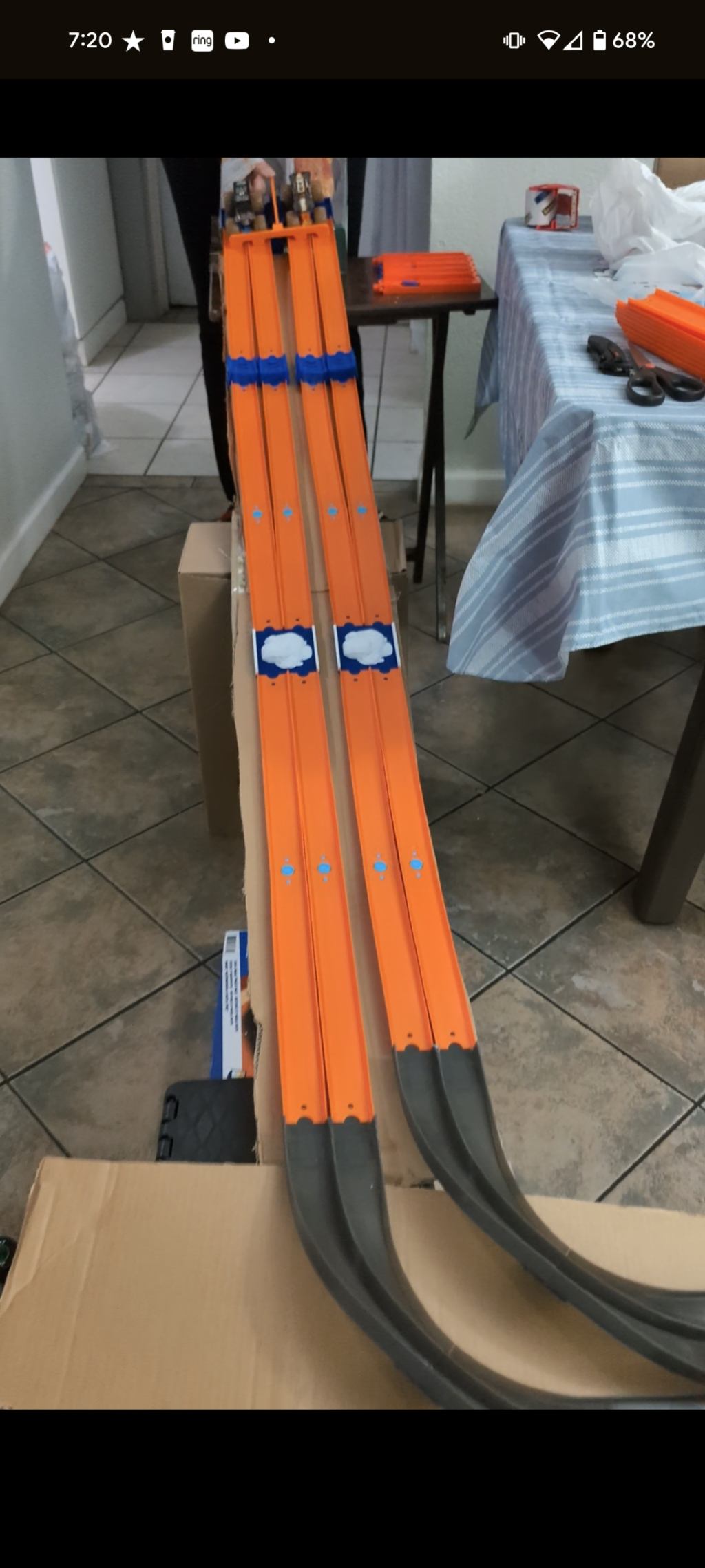

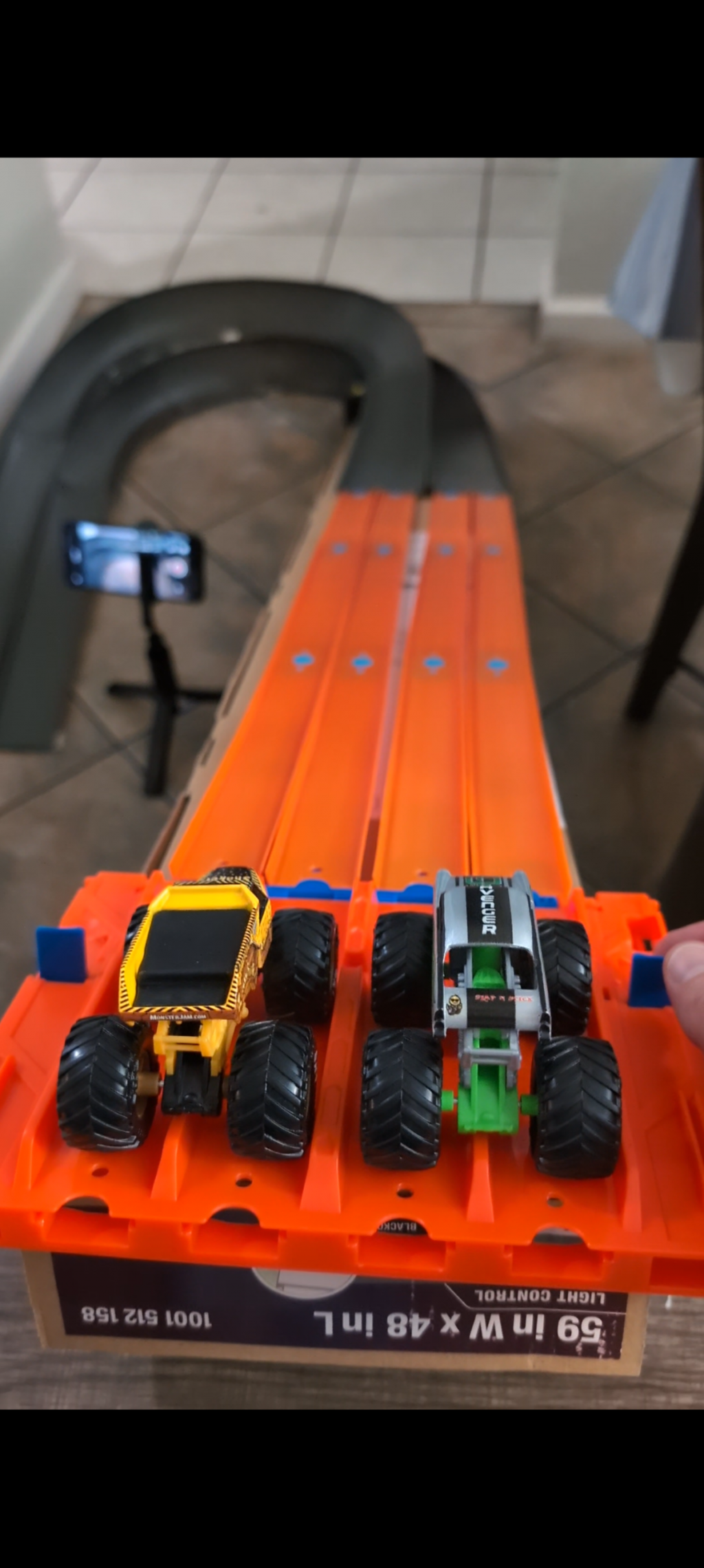

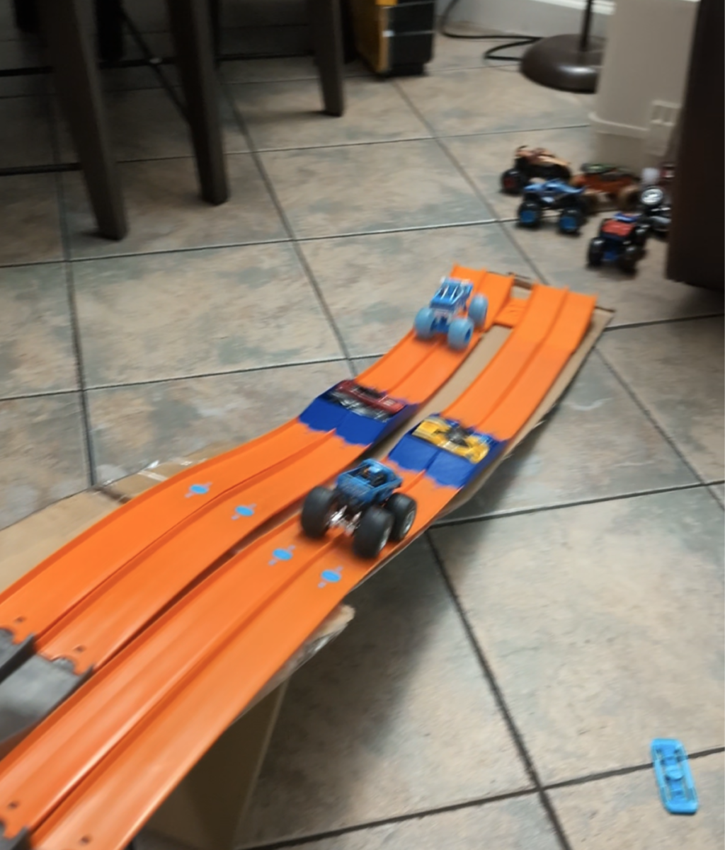

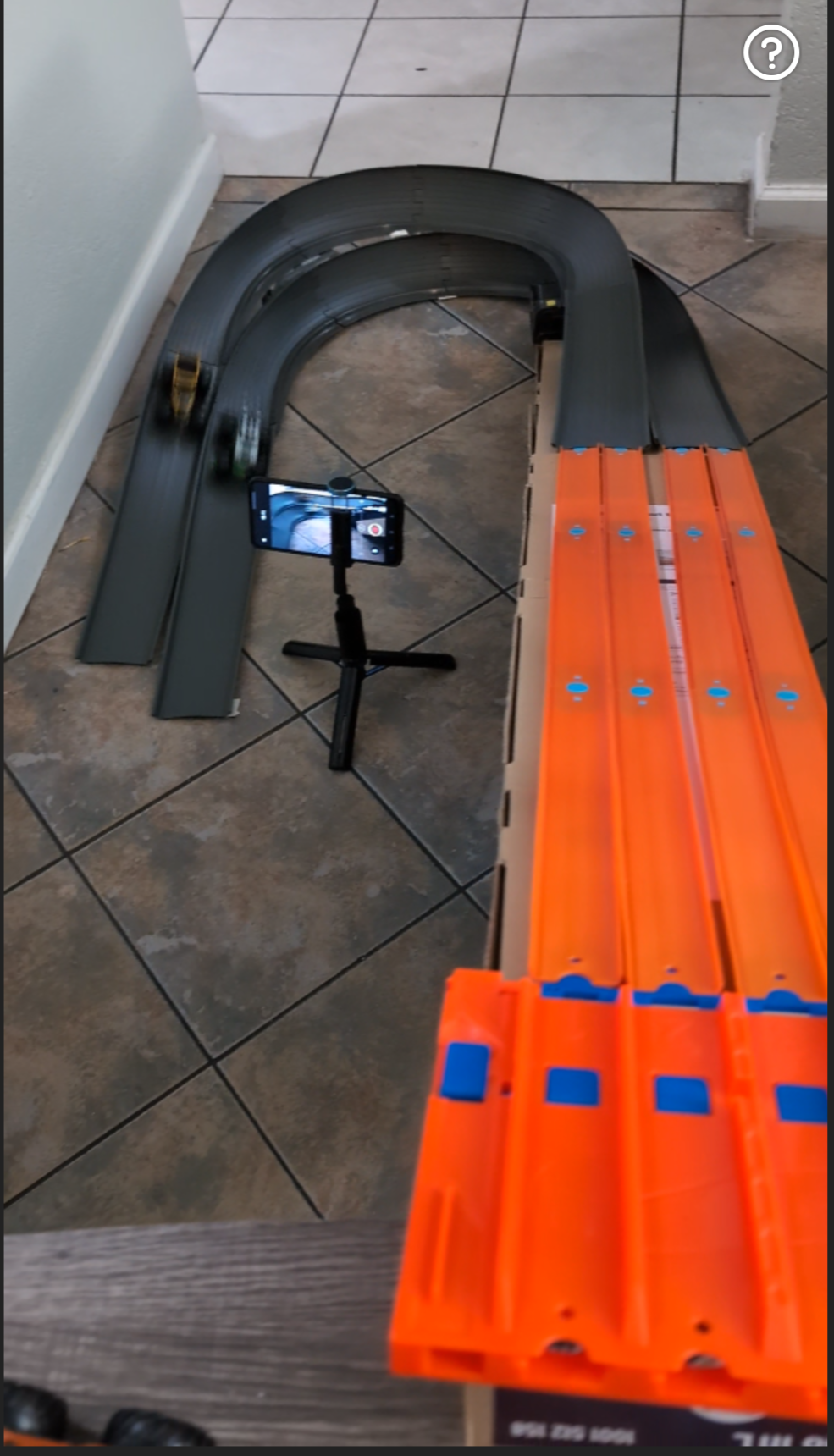

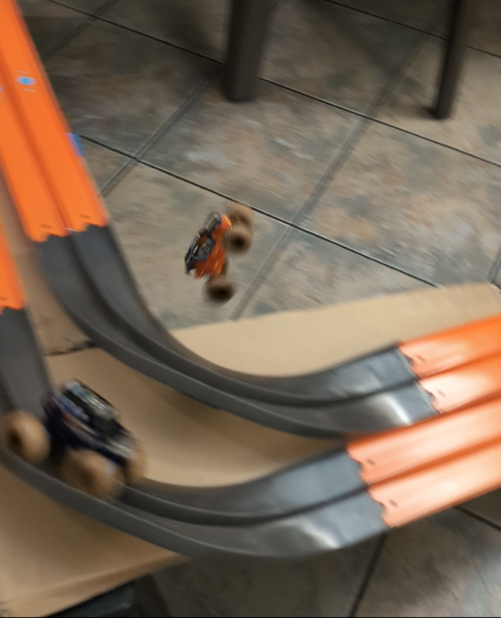

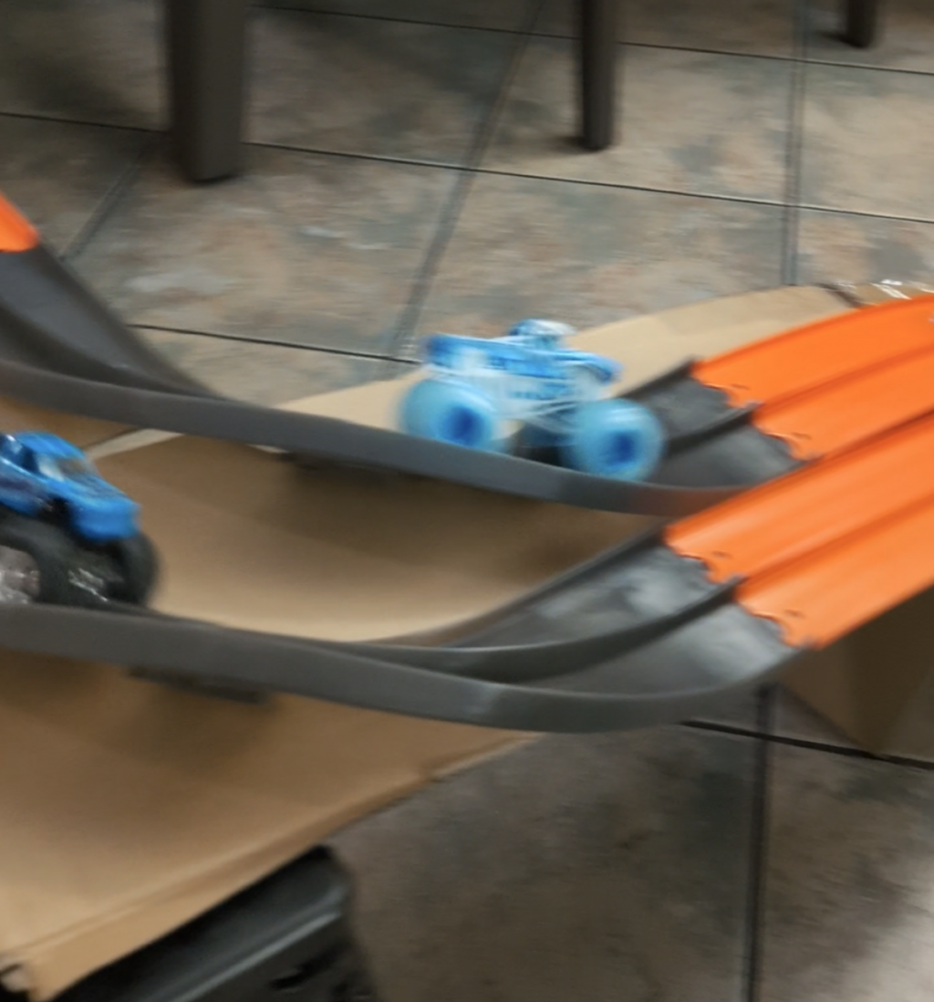

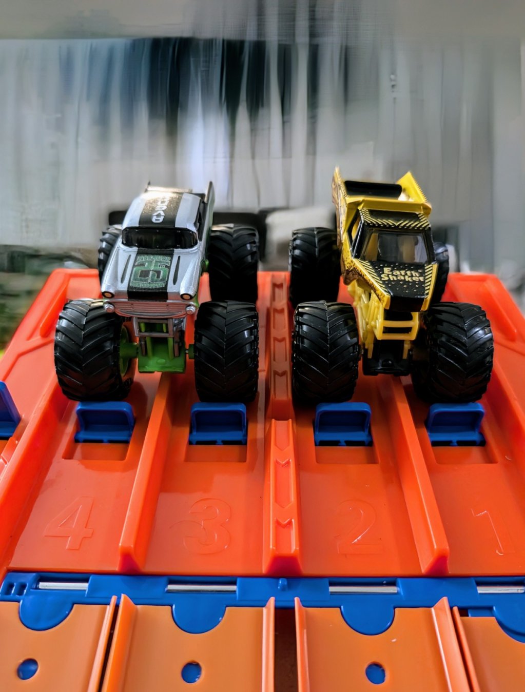

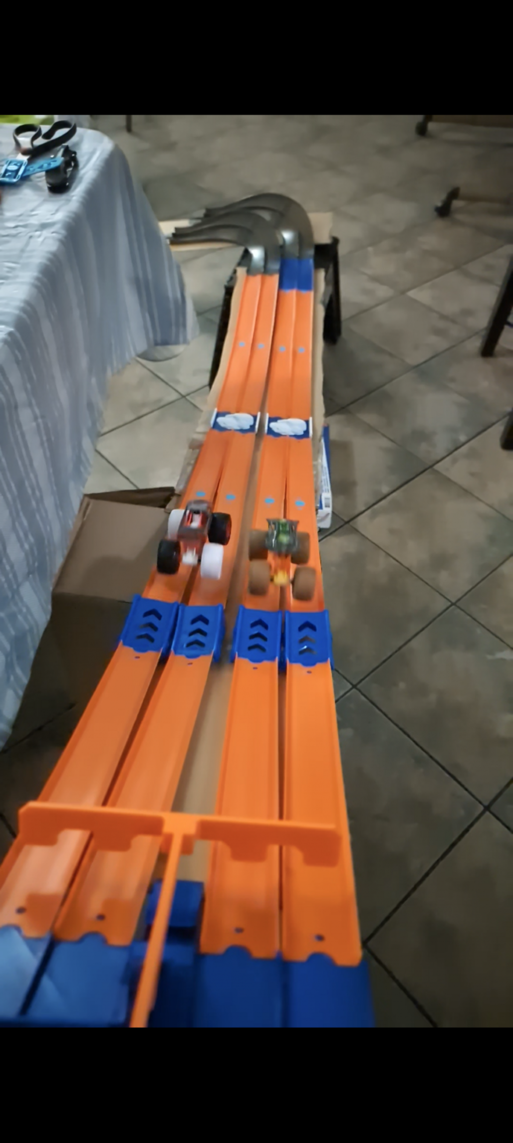

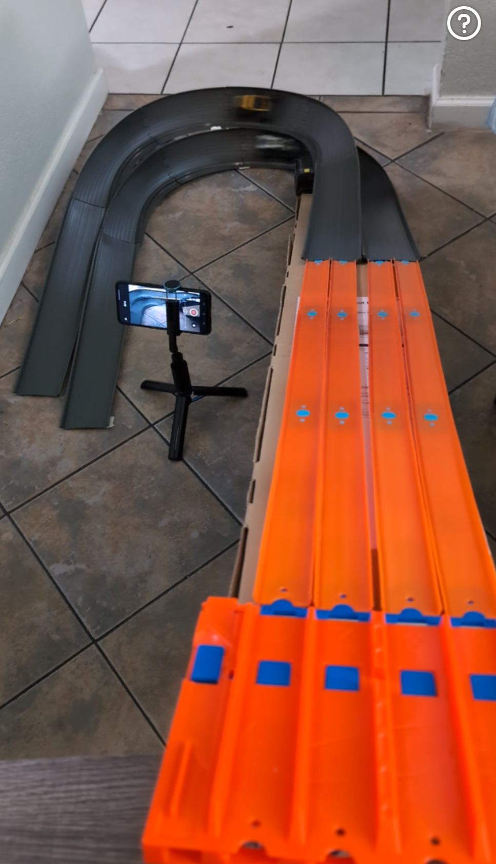

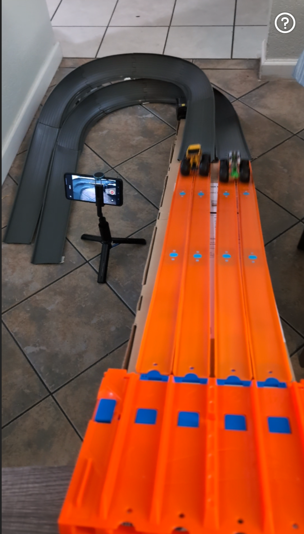

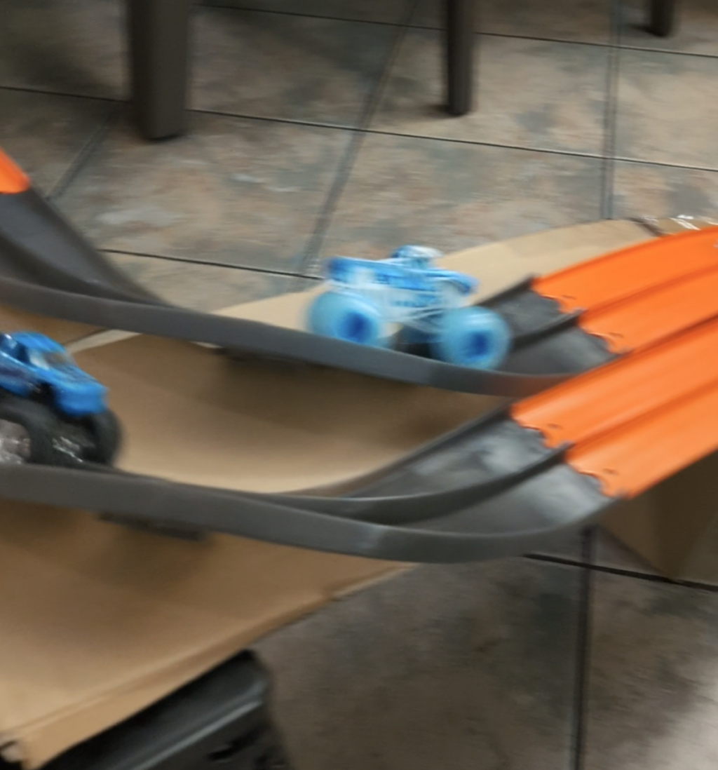

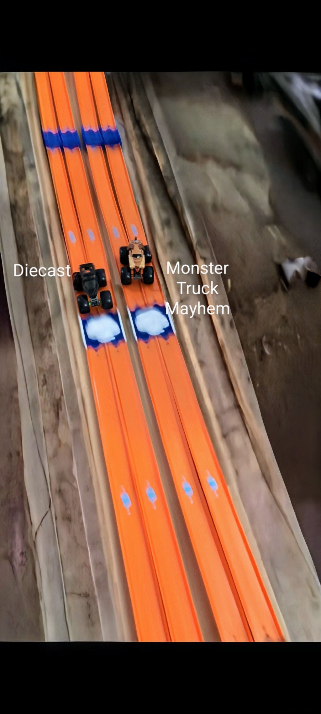

I haven't posted in a while, so I wanted to get something up here, and show my progress so far. This has been going a little slow for me, I'm still trying to figure out where exactly to start building my track. I've seen some people build in their garage or shed, but here in Phoenix, it gets a little warm to do that. Even though my track will fit on a 4x8 plywood, I still need more space than just that, for the lighting, tripods, and to be able to work on my track
But untill that happens, I'll be testing different sections of my track. The included pictures are just a section of my track, roughly about 10 feet. It has multiple obstacles, the final track won't have these obstacles so close together, I just wanted to see how the trucks could handle them.
So far I have a manual launch gate, which will be upgraded soon. I'm trying to find a good electronic start gate, preferably on remote, that can handle 4 lanes wide. Next is a small jump followed by a small rock obstacle (that I found from Etsy). Some of the trucks were having trouble with this, and falling off the track, but only about 20%(ish). I might try to get some high guard rails for that specific spot, to keep the trucks on track. Following that is a 90 degree bank turn from trace racers. It has a nice bank turn, which is perfect for the trucks. I had a little trouble with the start and exits of the turn, since both 90 degree turns are exactly the same length, and I need an inside and outside lane. Following the turn is a car jump obstacle, followed by a final jump (both from Etsy)
The entire track has a slope of about 10 degrees (maybe a little greater down the first half). Which I thought was good for the turn, because of the high bank on it. But maybe a little fast for the rest of the track.
Going forward I'll be buying some crash racers track, and having an entire lane for each Diecast truck. For the 180 degree turns, my plan was to make an inner lane and outer lane with the crash racers track. In theory, by taking a section (or 2) out of one turn (making it the inner lane), and adding it to the outer lane, I might be able to make a side by side 180 degree turn for Diecast monster truck. But that will be a post for next time.
Any tips, tricks or ideas would be greatly appreciated. Not all these obstacles will be this close together in the final version of the track. I was just testing to see how the trucks could handle them. The final version will only have 1 (maybe 2) obstacle per 8 foot section. Let me know what you think.

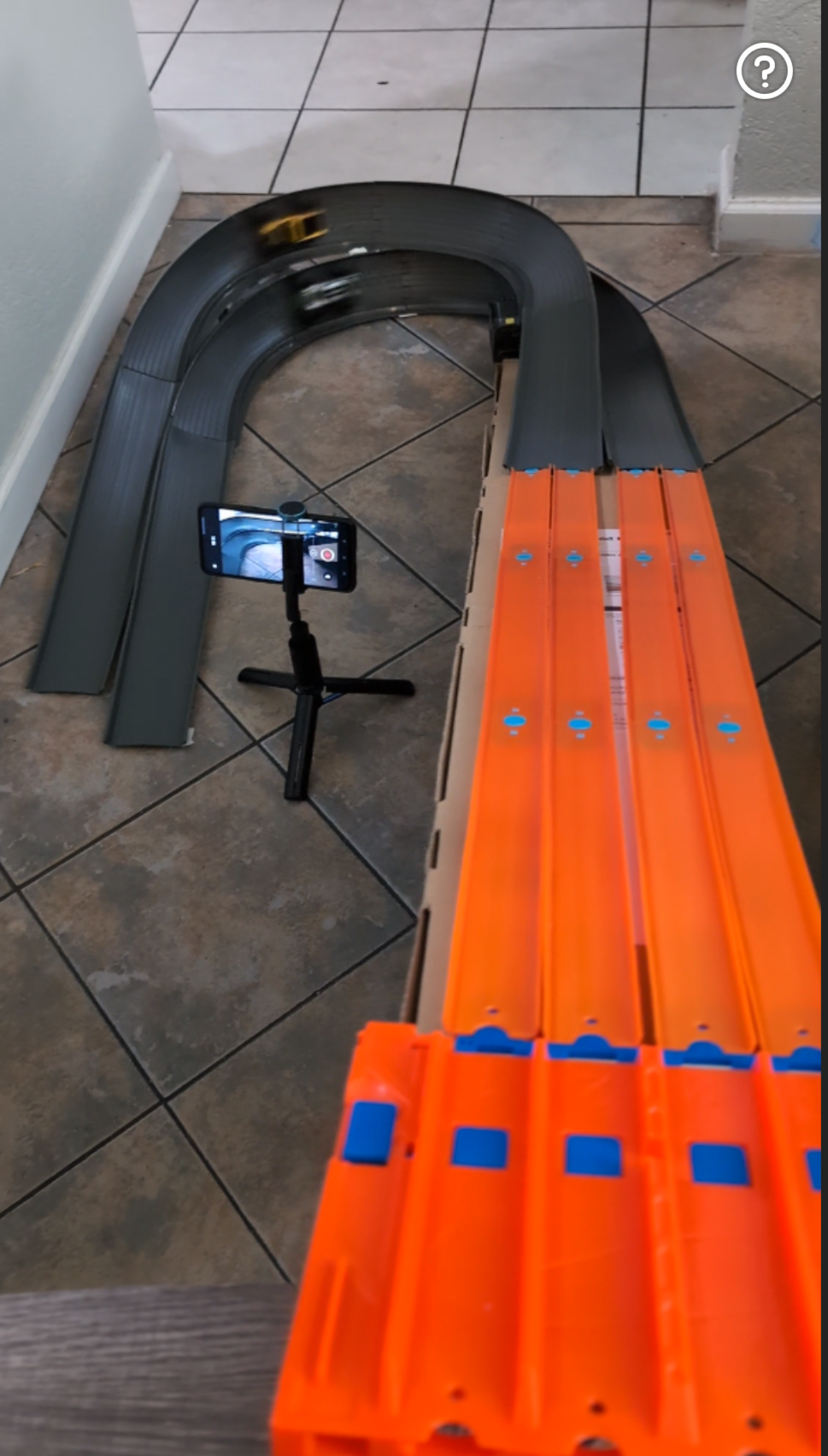

I wanted to post the next section of my track and get some opinions on it. So my biggest concern I was having with my track, was how to do a 180 degree turn. Trying to find a 4 lane, banked 180 degree turn, was really hard to find. I could have gotten a 3d printer, and made my own, but designing a brand new piece, seemed a little hard. So I decided to take AFCR and try to make something new. My first idea was to make an inner and outer lane with crash racers, but that didn't too well. I didn't realize that the turns are hard plastic and don't bend. So I thought about doing an Over/Under track. And it seemed to work pretty good. The only thing is that I have to have the track at roughly 20 degree decline, so the trucks are going a little fast. But it was the only way to make the turn. I want to see what y'all think of my idea.
Also what is the most common device used to record video. I was using my Pixel 8 pro, but the best I can record is 4k at 60 fps. But with how fast the trucks are going, I feel like I need 120 fps or faster, so I can slow it down when I edit. So would y'all recommend a GoPro, or a Insta360, and a different phone. Any and all recommendations are welcome.
