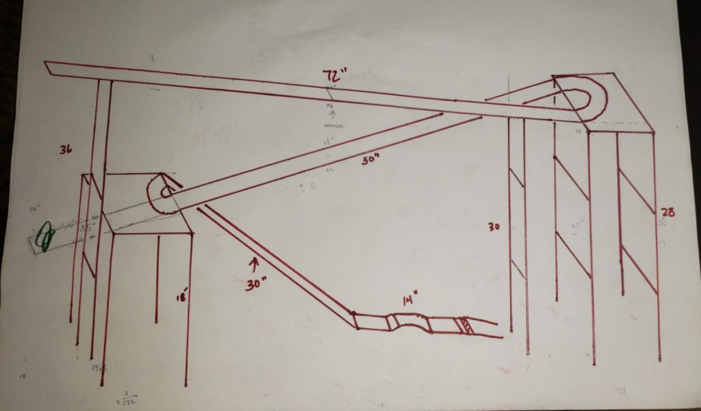

So things are developing here at Crystal Canyon. I picked up 2 1x4x6' pine boards and some misc bits and after some testing decided to make the angle of decent about 5° over 6 feet.

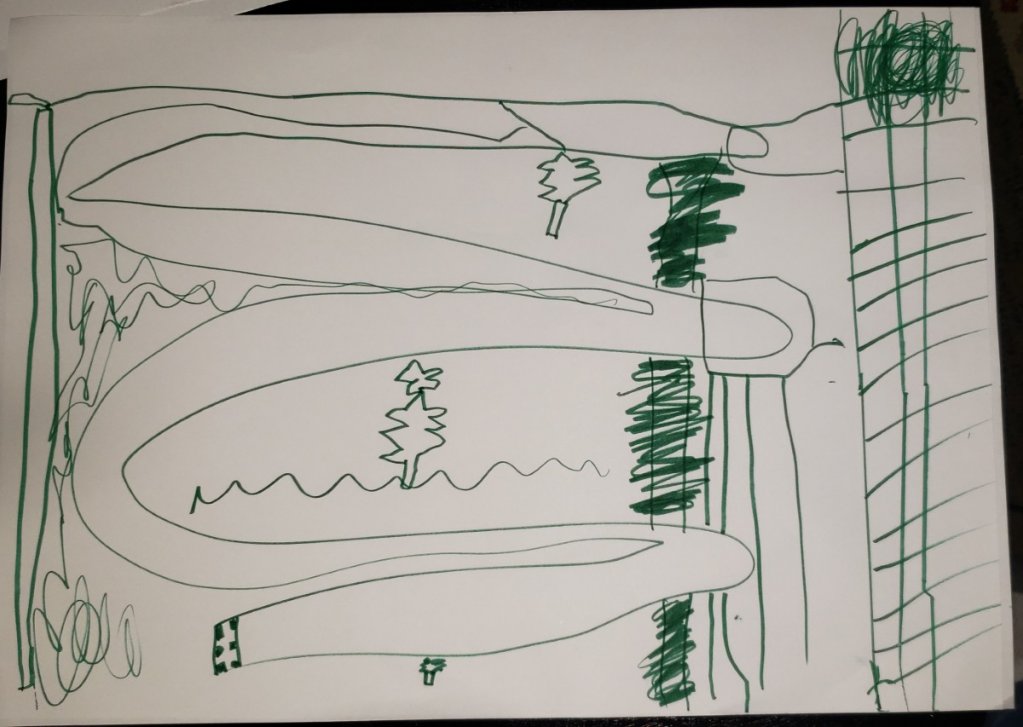

My Daughter's track plan looks better than mine lol
The total length comes out to about 16' 6".
- That drop going into the off-road section looks steep. Gonna have to play with that. — redlinederby
- Both renderings look legit! — KPS_Kustomz

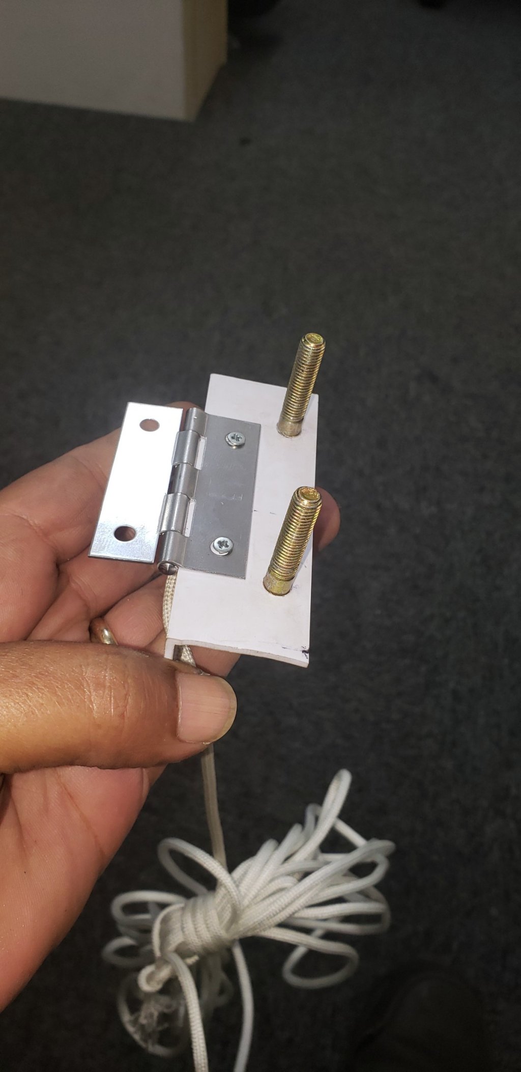

Start gate prototype 1. We'll see if it works ????
- That's essentially how I used my start gate for the first few months. I now have it triggered by a servo so I can reset it remotely as well, instead of having to manually reset it each time — Chaos_Canyon
