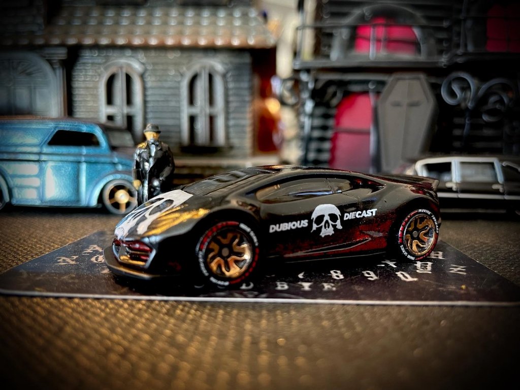

My best paint job so far.
- that's absolutly awesome! — IndianaDiecastRacing
- that is very nice — dr_dodge
- It looks faster every time I see it. — Numbskull
- Gorgeous! — GravityThrottleRacing
- Thanks guys!! — MrDarq

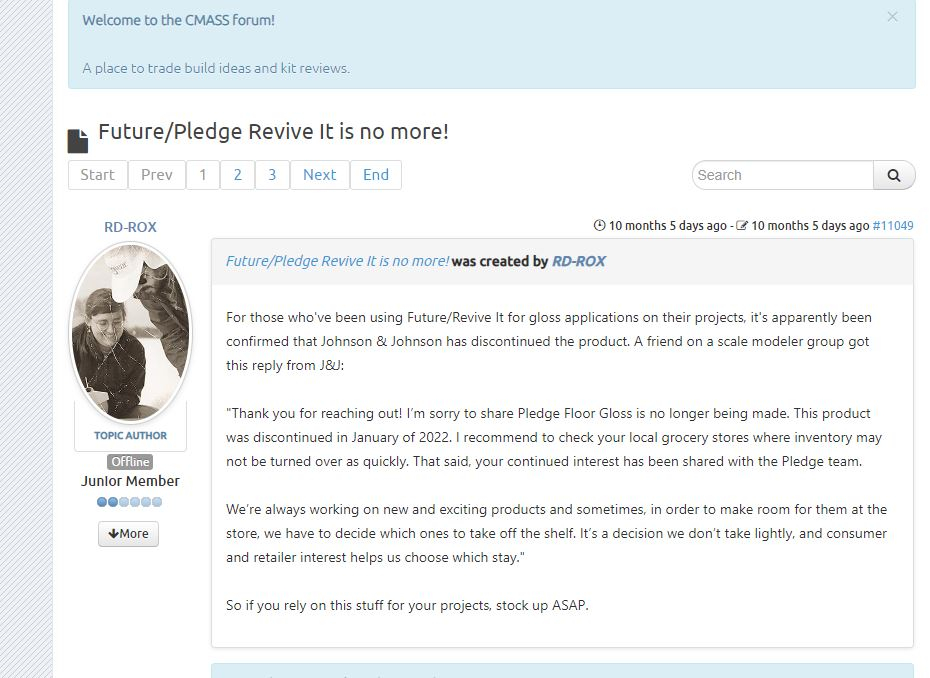

Instead of clear coat,
I now use "future style" acrylic floor wax on all my models (die cast and styrene kits)
It self levels, and is (fairly) easily removable without attacking the paint
protects the paint from chips and seals the decals
It also helps give clear parts a "not thick" look if dipped in it
It disolves its self so be careful with multiple coats, but that makes fixing holidays very easy as it will blend in
I was using the J&J Pledge, but was informed this weekend at the slot car track it is now discontinued
I am bummed, I use it alot
At least I have a full bottle I bought last year
I hear price gouging is going on on ebay
Amazon has a bunch of others listed, but, you always hate to move from something that gives great results

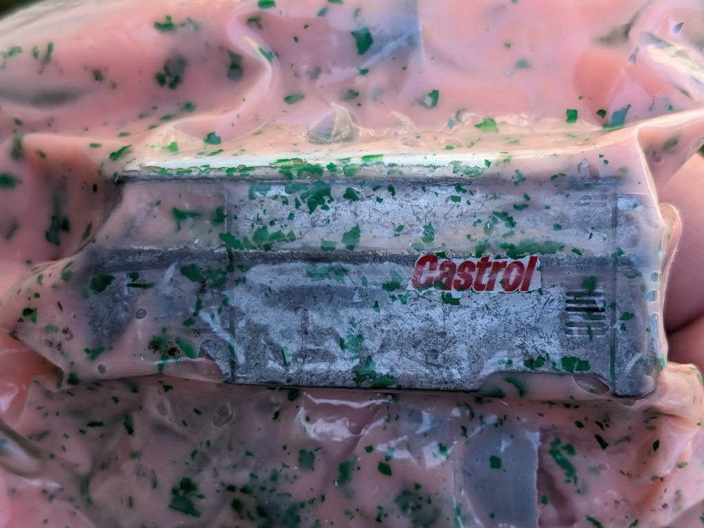

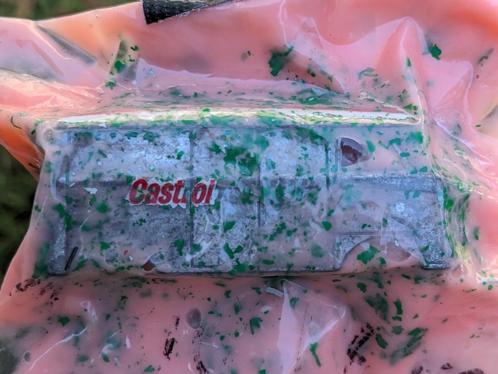

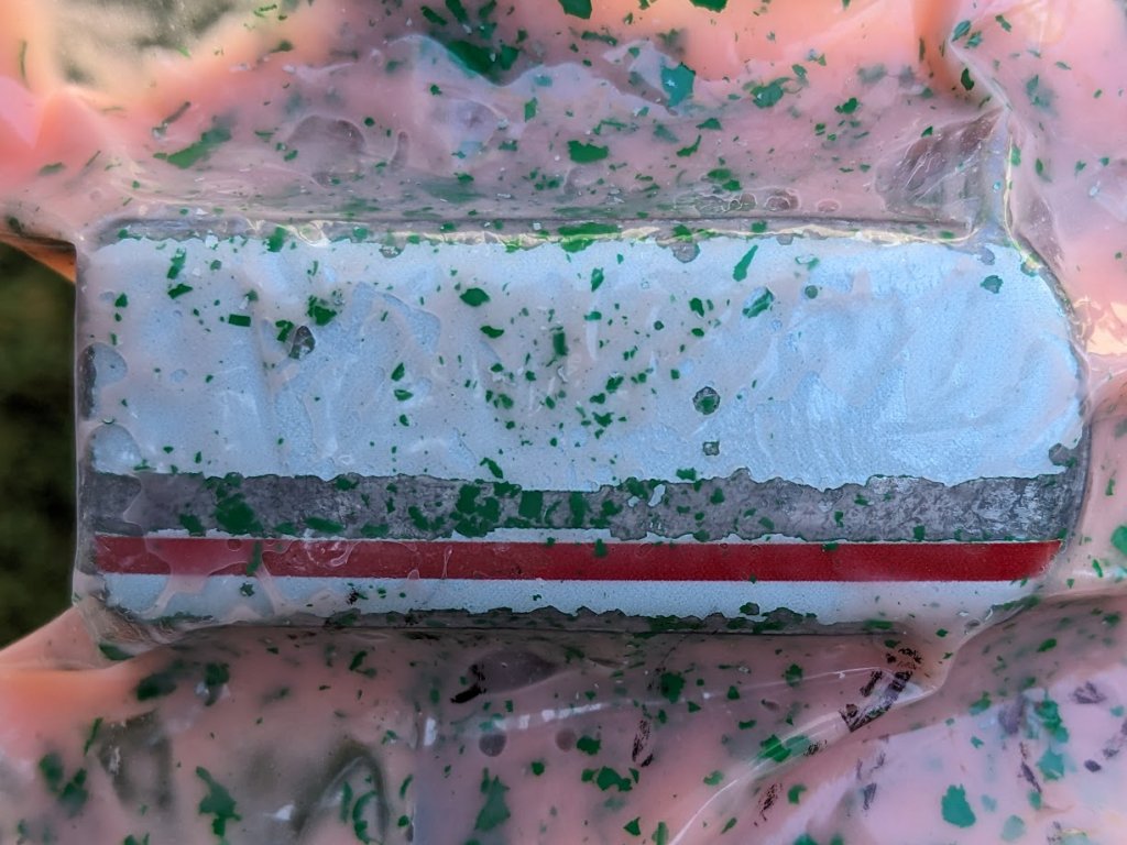

Anyone encountered CitriStrip-resistant paint? Does this have to be mechanically removed, or do I just keep it in the CitriStrip/plastic bag longer? Should I move to 409 or oven cleaner?
Thanks in advance!
- Do you submerge the body in the goop? I always put mine in a paint can and then just dropped it in there and let it sit for a day or two. It would still require some manual labor but I'd say 95% of the paint would come off. — redlinederby
- I dropped the casting into a plastic bag and poured in enough CitriStrip to cover it. I squeezed out the air and sealed the bag, then moved the casting around to ensure I got as much coverage by the CitriStrip as possible. Photos are after 12 hours of exposure. — Mony_Mony
- I moved the CitriStrip out of the way to take the photos, then moved it around to get more coverage on the remaining paint before putting the bag back in the shed. — Mony_Mony
- soak it more, I too, use the baggie, but I dump a wad into a paper towel and wrap it up, then put in the bag for2-4 hours, remove loosened paint, re goop as needed. some paint is tougher than others — dr_dodge
