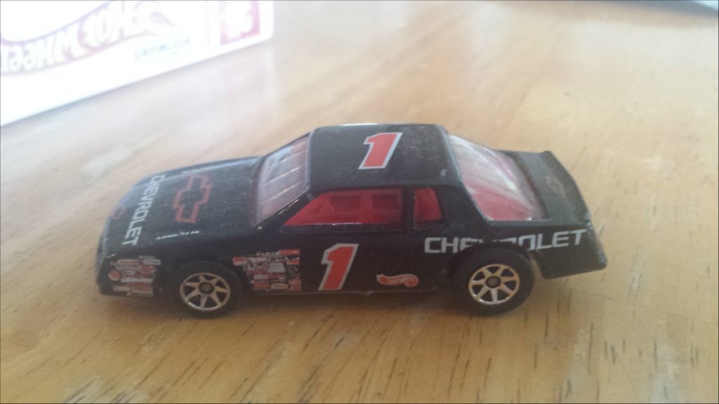

A Collector # isn't country of origin specific...the black one is Malaysia and here is the China casting

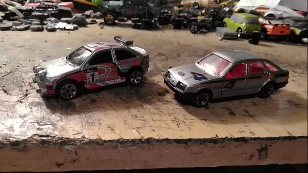

I think I found another for your list
- The XR4TI is one of the cars that have made it into the 16 cars in the Pantheon of Speed in the Quest for Speed...very much looked over casting — LeagueofSpeed
- Going to be my dcr rally car — NDeavers80
- I owned a merkur xr4ti i miss that car — NDeavers80
