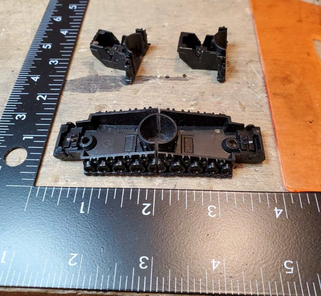

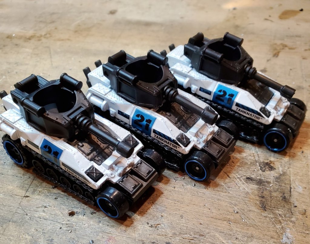

I started with three Tanknator castings, knowing I wanted to combine two of them and have one for back-up.
I cut two of the bases and put them back-to-back to make it as long as possible. 4" max. allowed. I originally wanted to use two of the tank tops and match them together as well but decided to just use one in the end.

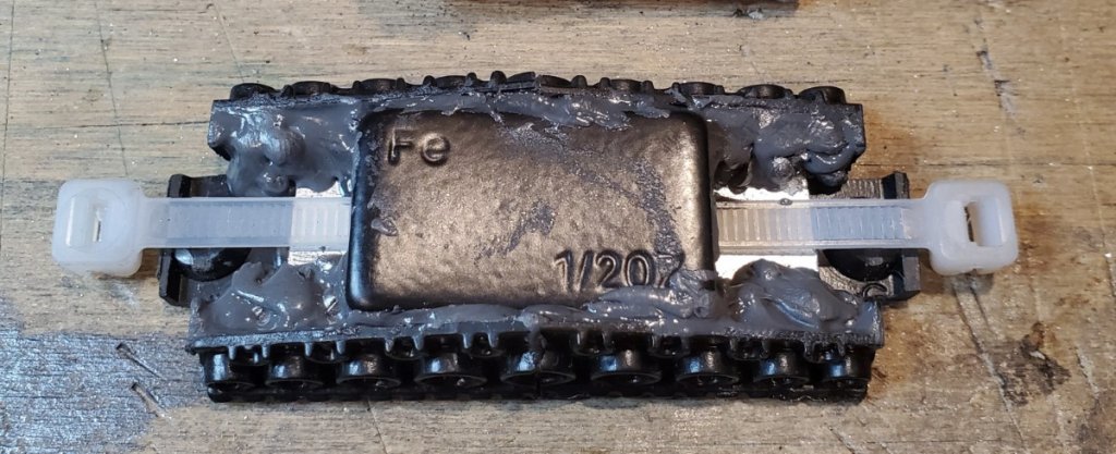

There was a lot of trial and error on how much length of the zip tie to keep exposed and have a working suspension with how heavy it will actually be.

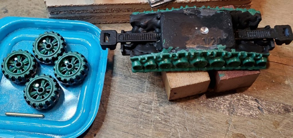

I wanted to make it the maximum width of 1.5" for stability, so I cut the axles and made tubes to epoxy into a notch I cut out of the end of the zip tie. There are additional cutouts in the tubes to glue the axles in place.
I soon discovered that the suspension was dropping too much with the anticipated weight of 170g. So I shortened the length exposed of the zip tie by just adding more epoxy where it meets at the base. In hindsight, I could have used two zip ties per side to hold more weight. I added the metal screw for an additional anchor point for the epoxy to grab when gluing the top to the base.

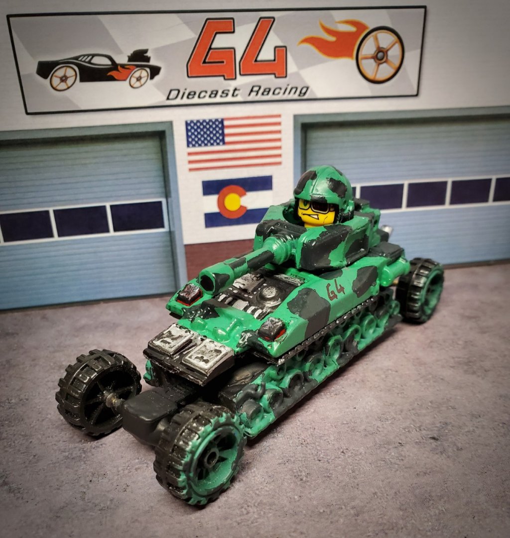

I was originally going to add about 50g of weight to the open cavity in the turret, but decided it may become too top-heavy. So I added the lego dude, which fit perfectly!
That's it! I'm calling it "Shocks and Awe"! Ha! It only weighs 115g, which is light considering the race rules allow up to 300g. It was a fun project to try, even though the suspension will probably not make a difference at all. I'm actually most concerned that the axles will fall out after a few big jumps! We shall see! :D
