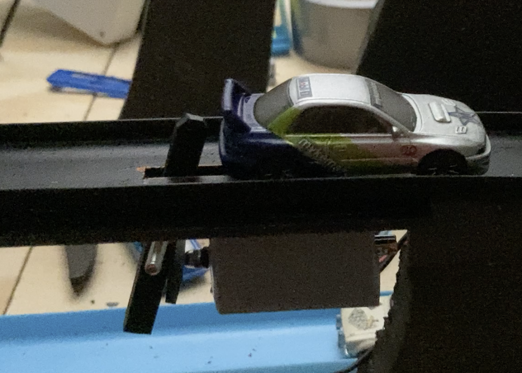

One of the other things with this track was how to start the cars. They had to be able to make it to the first boosters, so they needed to roll, but because the cars do laps, they had to not get in the way, and I also needed a clear way to decide a winner so I came up with the push start and indicator bars.
Originally I was going to go with a standard gravity drop but the problem was that they needed a boost up the hill to get to back to the start and cars were often flying right over the start and off the track - cause you need enough power in the boosters to get all the various cars to the top, but fast cars got yeeted - so then I had a drop in type start, where the cars went through a trap door on their second lap and that was working, but it became hard to spot exactly who got first, as you've seen how close some of the races are, so I came up with the tabletop flat start.
Under each lane there is a 6V actuator that is lined up with the push bar. These are wired to power as well so I didn't get any loss of battery power over time. Then there is a push button for each to activate it. When I hit the button, the actuator fires and knocks the bottom of the vertical piece which in turn pushes the cars from the flat to the inclined section. This also was really tricky to get right as one lane drops faster, to get the under/over working, so i had to make sure the distance to the boosters was really similar so no car got an easier run. Then that starter free floats, the actuator just hits it instead of being attached to it, so they cars can driver right over it with no issues. Took a bit of time to get right but I'm really happy with how it turned out.
