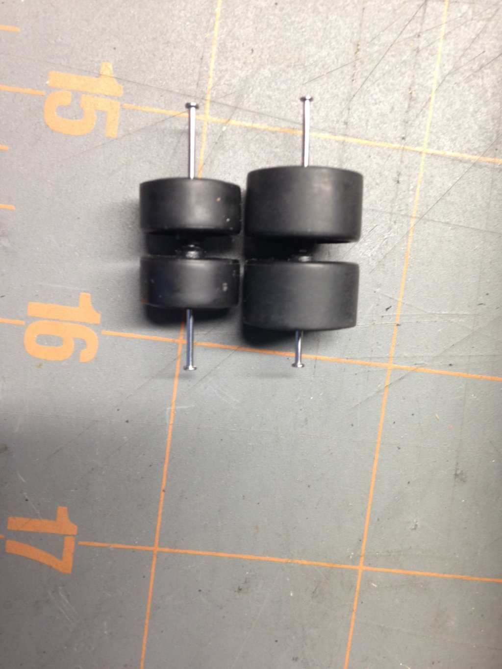

I keep seeing mention about sanding the wheels to smooth and help balance them, are there any tutorials or videos on this process? Im a sponge and very competitive please school me!!

I've been meaning to do a video about sanding wheels, and polishing axles, but I haven't gothen around to it.
I have a piece of aluminum  (about 4"x 4", 1/2" thick), with two different grit sandpapers glued to each side (400 and 1000 grit). I put the wheels in a chassis ...not glued in...and hold the chassis on the 400 grit side first and make small circles with the chassis.
You'll see the wheels coming into gape as you sand...once you have them true, I start sanding them with the 1000 grit. There are lots of little tricks once you start sanding and polishing, but this will get you going.
Stock wheels are mass produced, so they have imperfections and a small 'sprue' where the mold was filled...by sanding them, you can get rid the imperfections and get them.running pretty true.
I hope this help. And I'll try to get a video up some time.

My method is by hand with 400 grit and then 800 grit...I to have been meaning to do a video. I leave the wheels/axels in the donor chassis while I sand or the actual chassis before removing the axels for polishing.
MDG_Racing 8/27/18
I like to do mine by hand and as I do the axles. I feel like I'm getting a smoother sanding on the wheels because the sandpaper contours to my finger pad/tip. I usually just hit the wheels with the same paper from 220-2000
