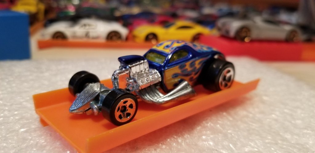

Project Looker: Case File 1 - 1/4 Mile Coupe

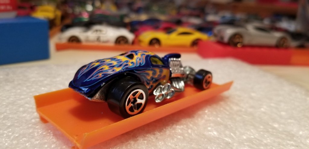

Some cars look great...cool lines...cool design...but sleds when it comes to gravity drop racing. So, this is Project Looker and we're going to try and change the performance of some known duds...the 1/4 Mile Coupe is one of those duds...due to some similarities to the Way 2 Fast...it will be Case File 1.

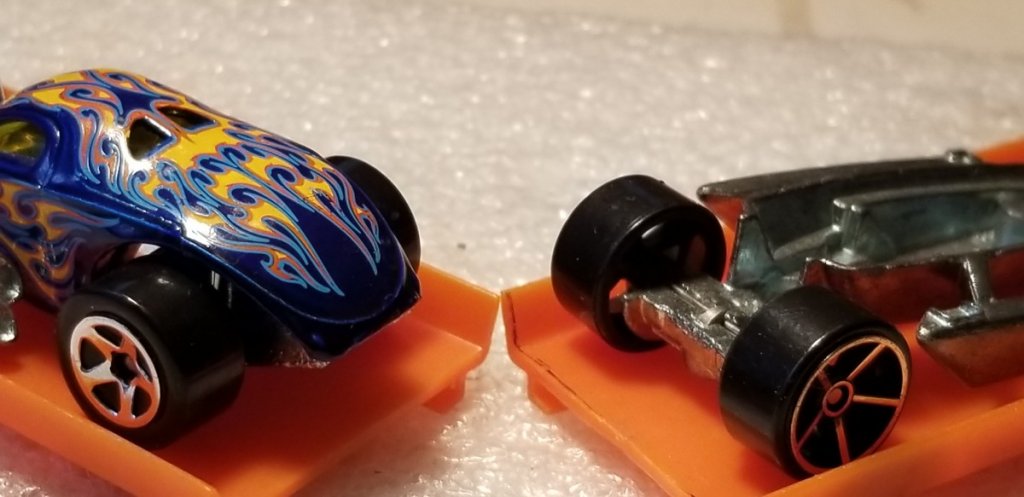

Going with bigger wheels for the front and decided to keep the fats in the rear instead of going with a thinner same size wheel.

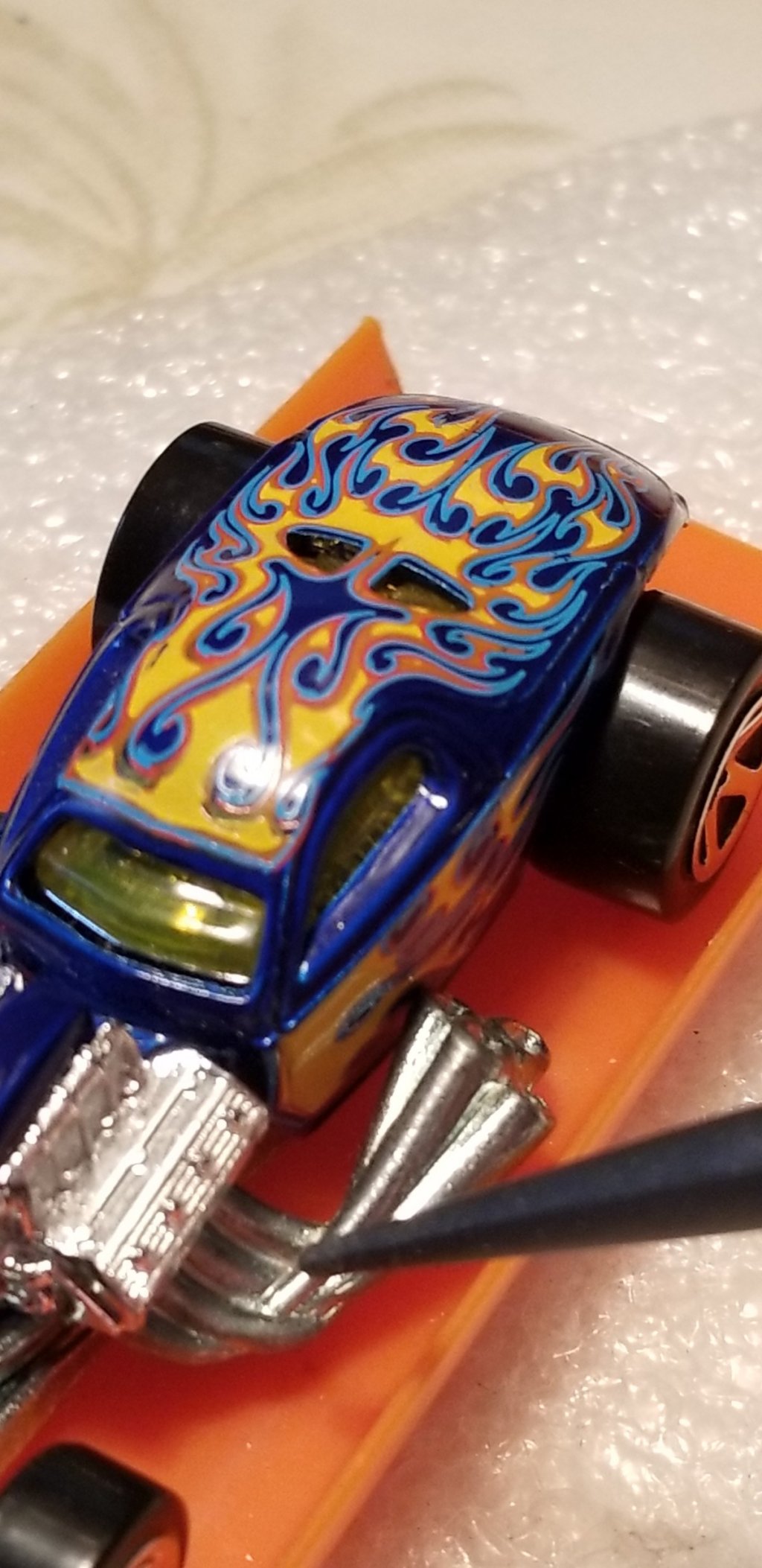

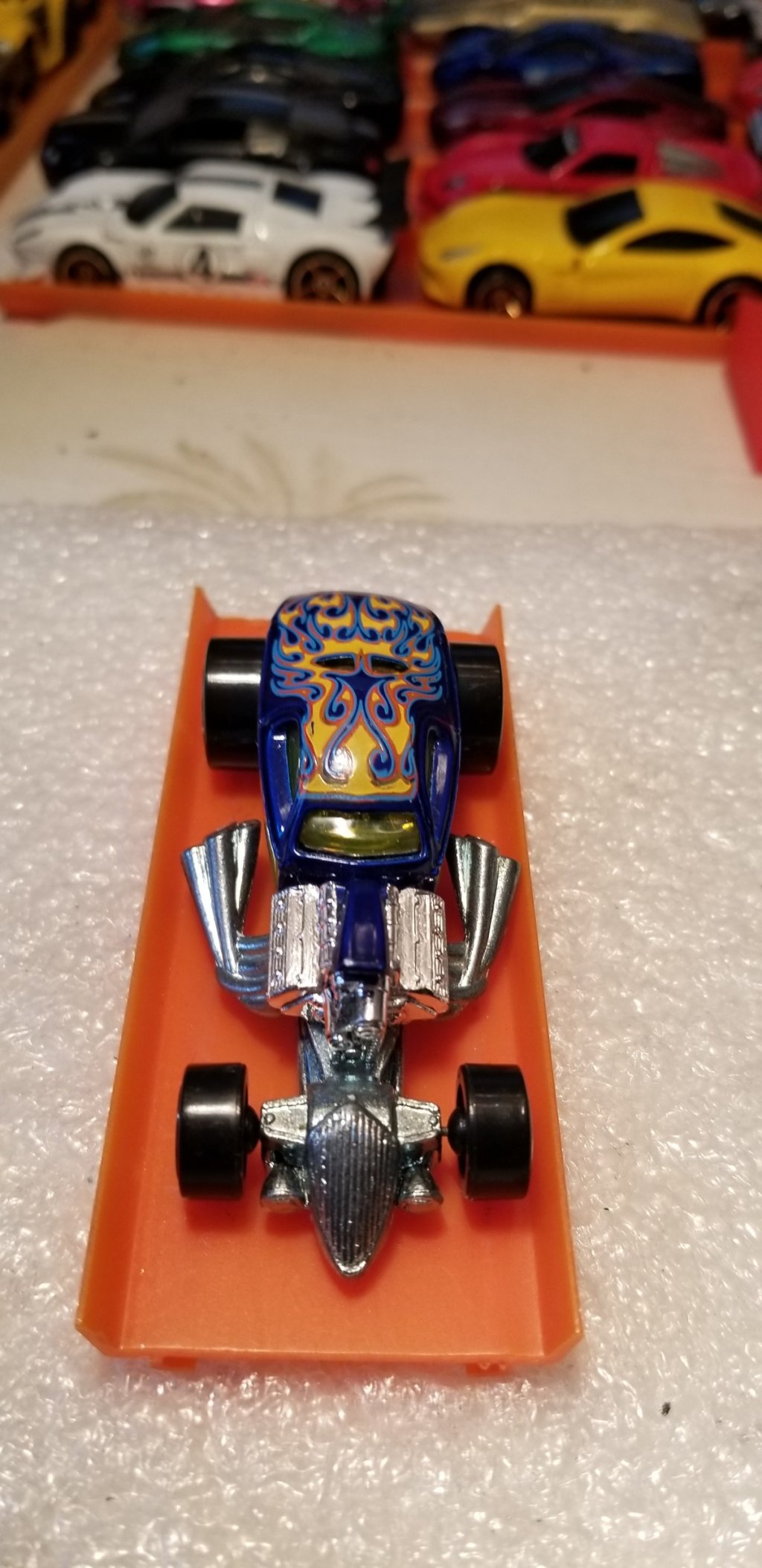

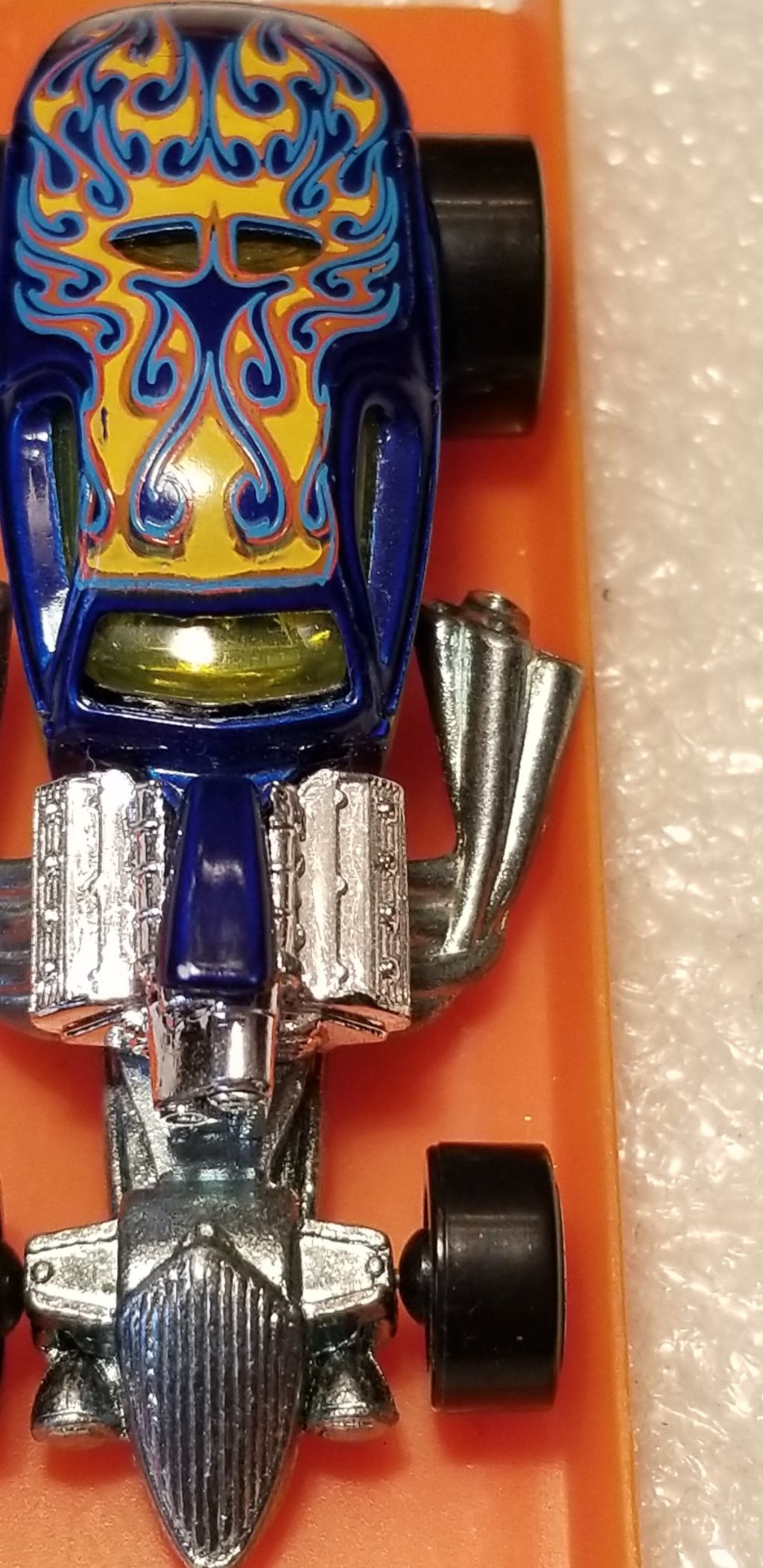

Thought...yes, the side pipes scrape the walls and kill some speed, but isn't it better that the pipes scrape the walls rather than the wheels? Wouldn't clanging the wheels do more damage?
- track wall doesn't go straight up...so always best if anything hits...let it be the wheels — LeagueofSpeed
- Ah I see...makes sense. And this is why I lose :) — redlinederby

LIke the solutions. Of course the solution is to a problem of track design traditional to diecast racing. A wider track, a fat track and the pipe issue becomes a lessor issue.I have created a few mixed track setups that have single lane going to fat track just to see if some cars pickup speed when free from the edges. And sure enough , a car that performs like a dog , gets some breathing room and puts on a show as it stretches its legs without scrubbing off the speed. Different courses for different horses. If the rules don't allow mods, then look for a track or build a track layout that is more suitable to the car. It is possible, same theorys applied differently.
- That goes without saying...the narrow track stance on the 1/4 Mile Coupe would not be advantageous for Fat Track Racing...my Fat Track Builds are completely different animal than this Build — LeagueofSpeed

- Oh, good story, I started to look and see what issues it would have. I picked the pipes, also the nose of the car, which looks like it would scrape in transitions. But bigger wheels on the front (as mentioned) would probably correct that, or lowering the axle, or attacking the bottom of the nose. Got me thinking. Cheers — CutRock_R_Marc_D
Project got stalled...but it's coming
The side pipes...while visually appealing...contact the track wall and scrub speed off the run...we will be cutting them off so they are still inside the wheel base(as they are originally) but inside the track stance(getting rid of the scrub).
