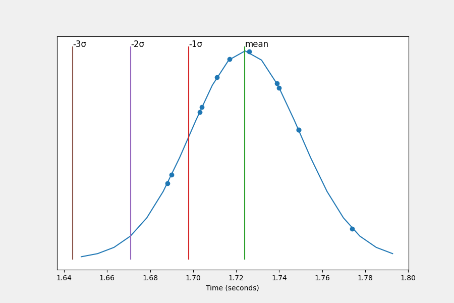

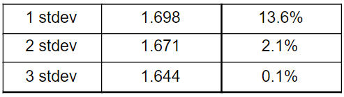

With a mean (average) of 1.724 seconds, and a calculated standard deviation of 0.027, we can create the normal distribution and show where the examples fell on the curve.
This shows us that the two fastest examples we found are just below one standard deviation below mean, and that to get to 1.67 seconds, or two standard deviations, we would explect to test at least 50 cars!
In summary, yes Hot Wheel performance follows a normal distribution, but to find an exceptionally fast car, you would have to test a lot of examples. For now, I think I’ll stick to my 10 car strategy, but at least I have a way now to calculate if it is The Golden One.
