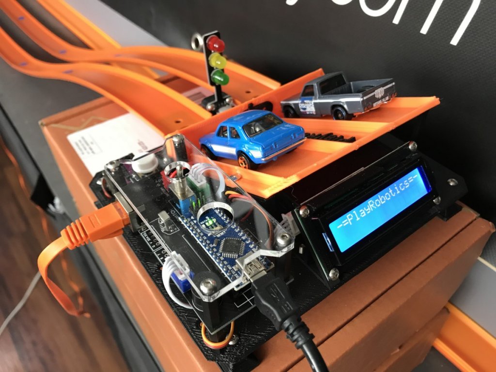

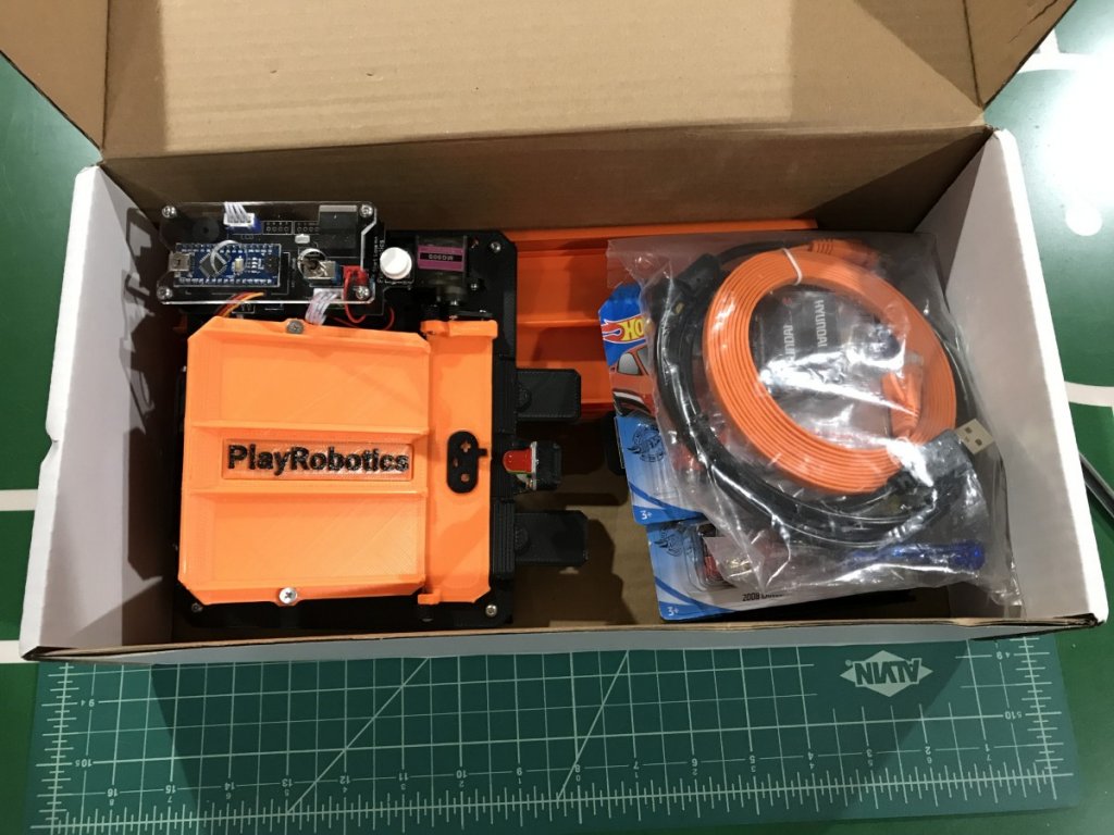

The kit has everything you need in terms of parts and it doesn't require any soldering or extra work. All you need to provide is a laptop. The main unit comes pre-assembled and ready to go. It's made up of an Arduino mini-computer, an LCD screen, tree lights, and a servo motor that controls the 2-lane starting gate. It also comes with a sensor finish line and number displays for showing winning lanes and times. All the guts come screwed onto the PlayRobotics' 3D-printed base and is a good solid build. It looks a little "naked" but this isn't intended to be a black box where you don't see the magic happening. This kit is about showing you that magic AND teaching you how & why it works.

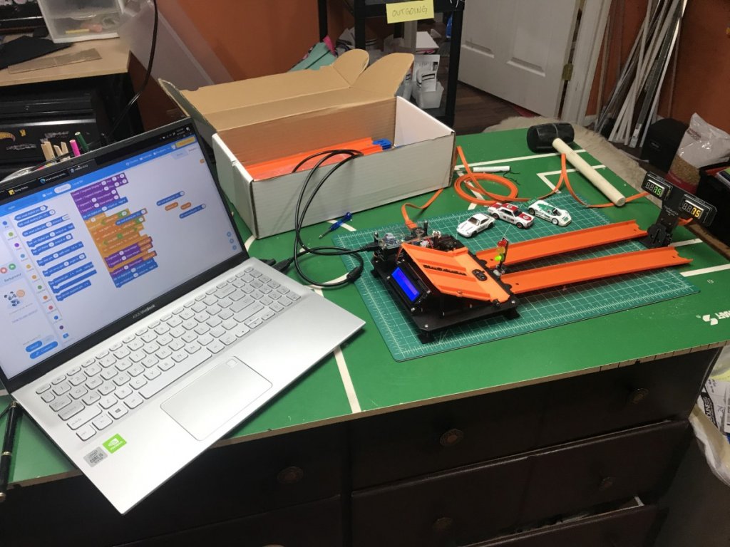

PlayRobotics has made great online step-by-step lessons guiding you through the process of programming the computer to tell it what to do. The only heavy lifting you have to do is connecting the unit to your laptop so you can program the thing, but the guide makes this a breeze as well.
The online lessons and videos are free regardless if you buy the kit or not, and while they're very much made for use with the Smart Race Track kit, it's all Programming 101 type stuff that is applicable no matter what type of computer you've got. A big chunk of the value here is in the lessons so they're worth checking out even if you're only mildly interested in programming.
I know for most of us, computer programming is black magic. If you choose to build your own finish line with brains, you're finding some code and copying it...without exactly knowing what does what and why. The Smart Race Track helps you to understand why things are happening and how. Being able to program your own electronics can be extremely powerful and opens you up to lots of great ideas.
By all rights, you can put the kit together, hook it up to your laptop, and have everything working within a half hour. Lights will flash, gates will drop, and cars will roll. There's fun here but make no mistake that the Smart Race Track is an educational product, plain and simple. It's a great kit to introduce how to make hardware and software work together...and in this case, it's wrapped up in a fun Hot Wheels race track theme. It's well put together and will teach almost anyone how to make it work.

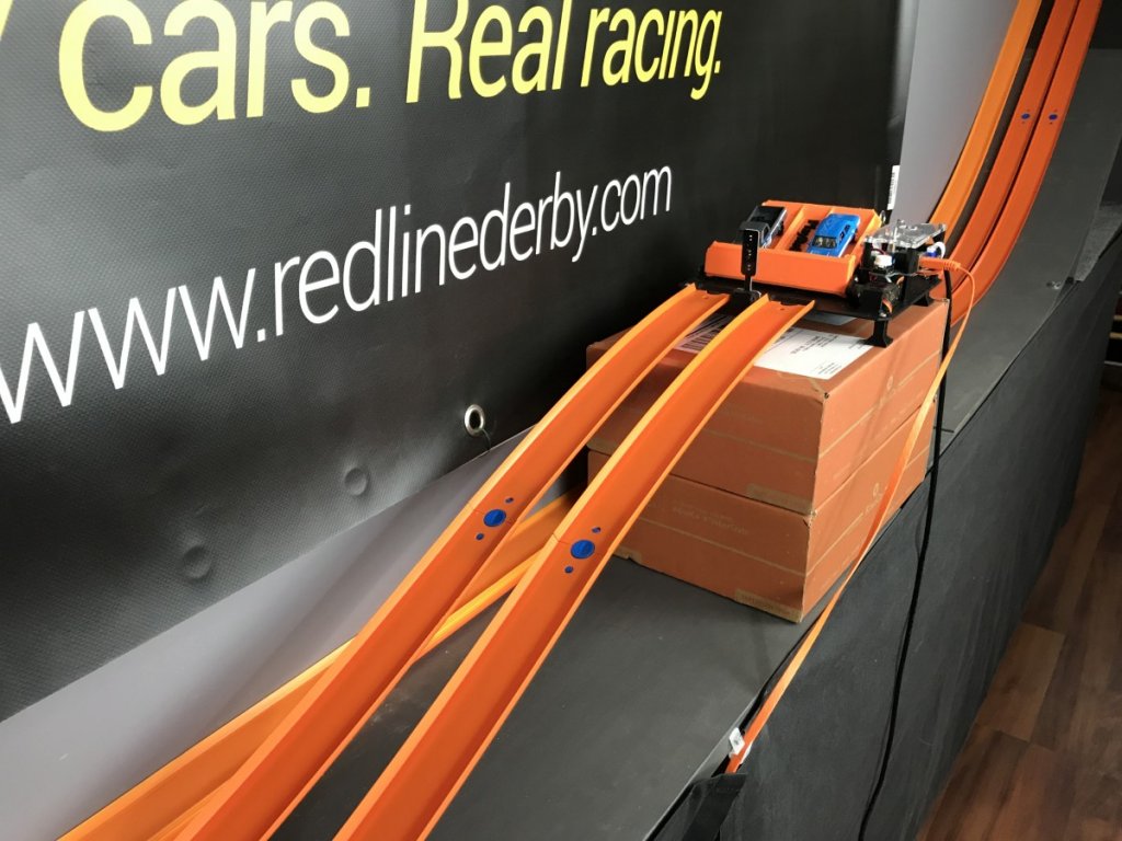

The base unit is intended to stand on its own and not be added to an existing track. The starting gate is a release gate connected to the servo motor and it works well, but there is a flat section before the orange track connects to the main unit. This creates a lot of extra bumps and kills some momentum before the cars even hit the open road.
The starting stand itself also isn't very high so you have to put it on a table or something to get enough height for your orange track to create the downhill you need. Conveniently enough, the kit does come with 12-feet of orange track so you have something to start with.

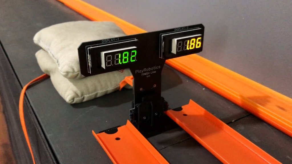

The finish line uses IR sensors as the trigger but rather than being above/below the track, they're pointing out horizontally across the track, one for each lane. In my completely unscientific testing, it did seem that some castings tripped the sensor sooner than others due to their body profile. We're talking a really small difference but a difference nonetheless. However, the side sensors do allow for the finish line to be really minimal without all the extra bulk of some other finish lines.
The segmented displays on the finish line are also nice to see. They're barebones like the rest of the kit but the digits show up great. The main base also has an LCD screen that can show two rows of text. And because you program the computer yourself, you can make any of the displays show whatever information you want. You can show track times, lane winners...you can even make it say "ready, set, go!" if you want.

You can take apart the pre-assembled bits (they even include a screwdriver) and you'll have a great list of parts. And better yet, there shouldn't be any soldering or extra electronics work getting in your way. You might need to get a few extra cables depending on your track design but even then it should be rather plug-n-play. This kit gives you a great starting point allowing you to work backwards and learn. I know I'm much happier to take apart something that I know already works in order to figure out how it does so...and then mod it as I need.

Two criticisms for me:
1. Make a smoother transition between the gate and the track (track connections angled down to match slope of starting gate)
2. Put extenders on the back of the "launch pad" so that you could add extra track and pile on more cars if desired.
