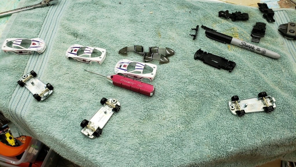

I will post times from a drag strip track tomorrow. I used 3 identical metal base C6R cars. Axle tubes on all. 1 with stock hot wheels axle, 1 with stainless steel head pins, and 1 with nickel plated steel dressmaker pins.

Here are pictures of everything so far.

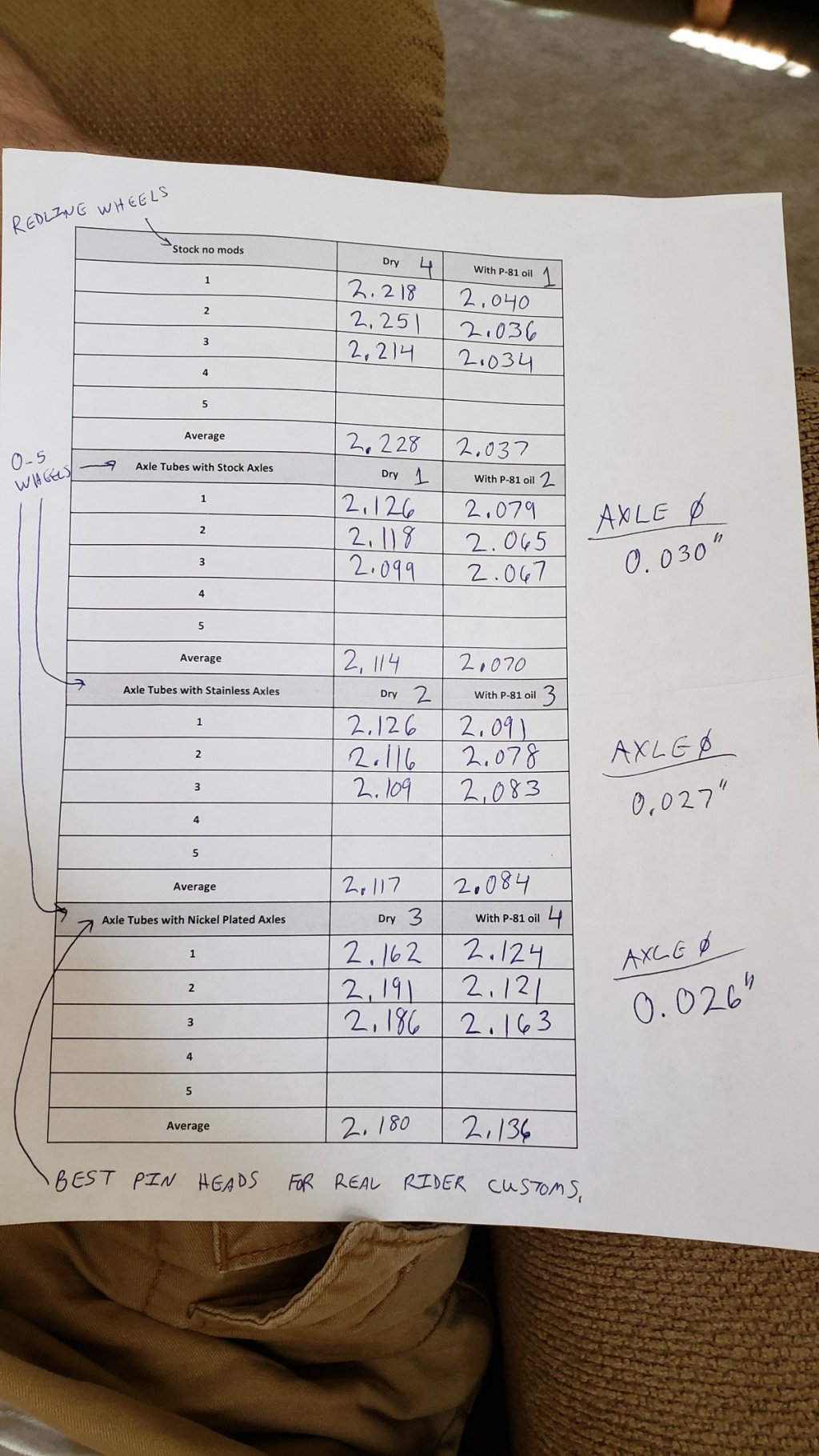

Here are the results. Use the information as you wish.
Basically stock axles are best BUT the stainless steel ones are almost identical and cost much less.
Nickel plated pins were slowest, but the pin heads look fantastic. I will use them exclusively for real rider customs.
