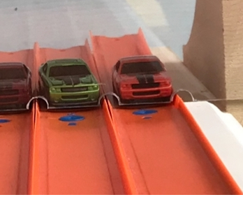

- This is one I built using a piece of plexiglass attached to a piano hinge with 3/4 inch pine as the frame. Cost effective and easy to build if you’re in a pinch until you get one with the drop pins. — 41-14
- Used a small sanding drum with a dremel to make the notches to fit over the sides of the track to get it lower to track surface to accommodate lower cars — 41-14

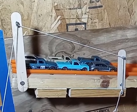

Mine is a simple Drop gate with a hinge and a couple of nails for the pegs. I have added a latch (not in this picture) that holds it and then pull the string to release it.

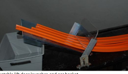

simple lift up for now on the Jamestown bypass
aluminum angle
some scrounge brackets, angle is adjustable
it's all raised in a pair of 2x6 chunks now
