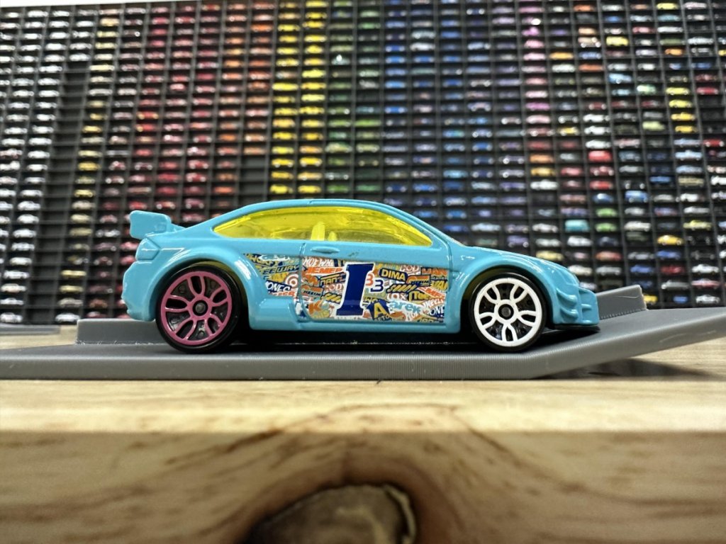

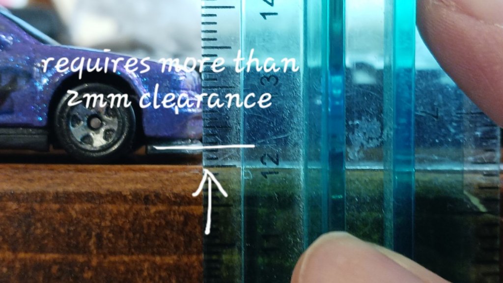

1. Clearance. From the start gate to the Shavano Creek jump is standard orange Hot Wheels track. Why? Because cars would jump cockeyed and crash on landing if not. It's an 8 inch jump (43 feet actual scale). The important thing to remember is bumper or scoop clearance with the track from the steep downgrade to the ramp. The rule of thumb is to allow 2mm of clearance for every 10mm from the wheel centerline. See pictures.
Nick Edmondson from Tiny Track Cars has 3D printed a simple jig you can use to quickly determine if you have a clearance issue. Contact Nick on his RLD handle (TinyTrackCars) if you're interested in having one shipped to you.

- FYI - Nick has a 3D printed jig to measure clearance if you contact him. See the new picture in the article above. — GravityThrottleRacing
So glad I saw this, as I shall now delete my front bumper. Or at least shave it down.
