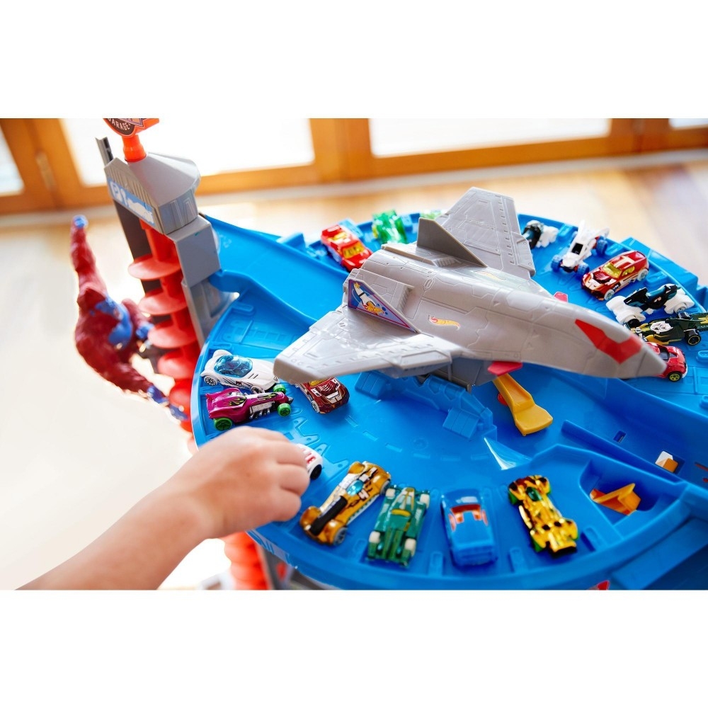

My guess is whatever you do, you won't have a 100% sucess rate, at least not if you're trying to do this during a high speed race. If you gradually introduce a barrier to seperate them, one car is eventaully going to end up doing a rail grind or flying off it like a ramp. If you wanted to bring the cars to a stop, and then have them seperate into different lanes that could certainly be done. The hot wheels super ultimate garage actually has a piece that does that.
