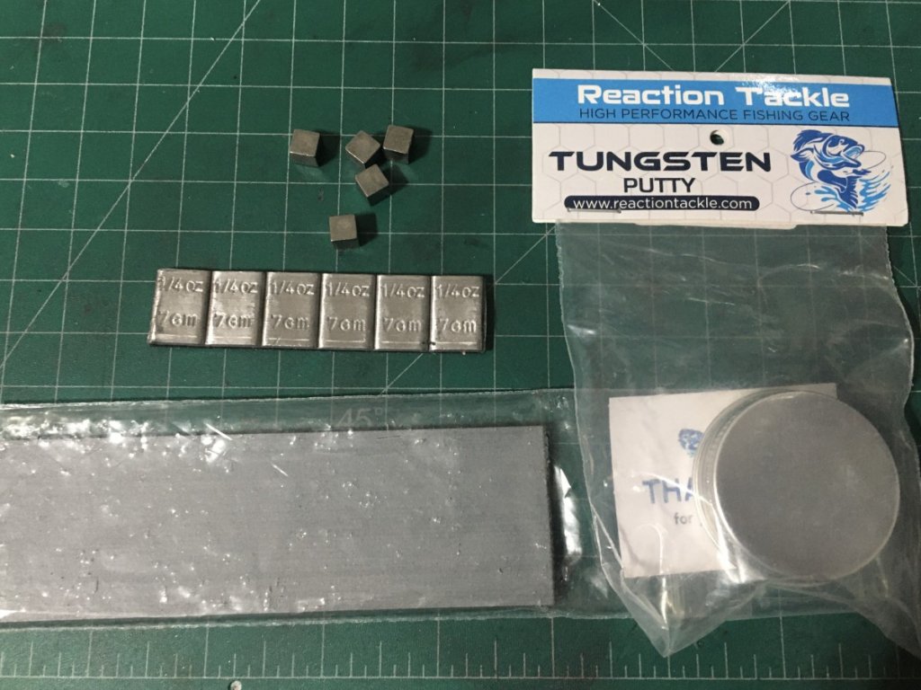

1. Tungsten weights (5g cubes)
2. Tire/pinewood derby weights (rectangles)
3. Cuttable, flexible tungsten w/ adhesive backing
4. Tungsten putty - I HIGHLY recommend this brand. It doesn't 'melt' or 'travel' like so many others.
Now, I've only been building for 2 years, so take my advice with a few grains of graphite. Try to balance your weight evenly between front and back axles so when you weigh the front of the car (half on your scale, half off) it's as close to 50/50 as possible for open track racing. Keep weight as low as possible. Veteran builders, please add to or correct any errant info, as I'm still learning and improving, too.
