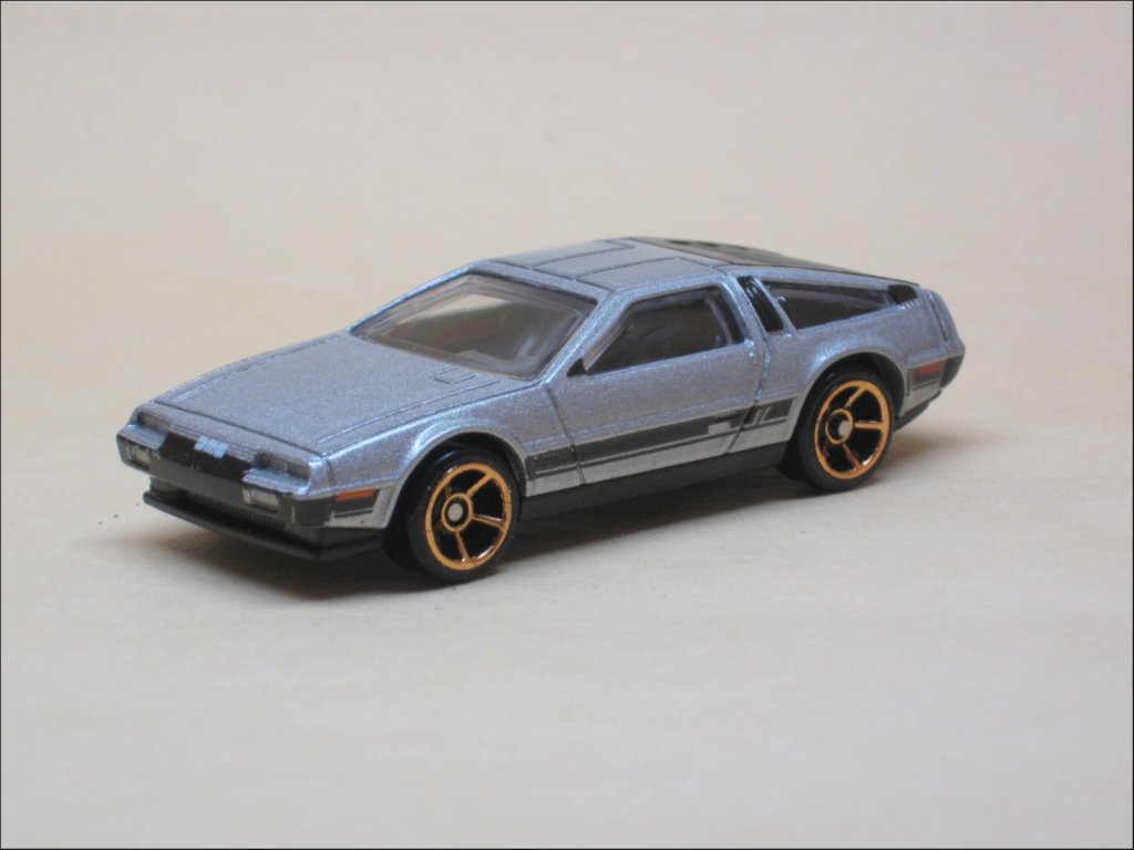

The "Faster Than Ever" or "FTE" cars are mainline cars (ie, the $1.00 variety) that were made with special, nickel-plated axles (NPA). The nickel made for a much shinier, smoother surface and thus this allowed wheels to spin a little faster thanks to some reduction in friction.
Technically speaking, FTE is the name used on the mainline cars, while NPA is a generic term for any nickel-plated axle. You will may both terms used interchangeably.
You might wonder if such a thing really makes a difference, and science-wise, yes, it does. A smoother surface means less friction which means less energy wasted which means more speed...or something close to that. But also consider that there are a lot of other factors that play into a car's speed beyond just the axles. When you consider things like weight, straightness of axles, balance, wheel smoothness, chassis length and so on...the axles might not seem like a big deal but it's also a case of, "why not?"
When you're racing, you look for every advantage you can. So if you can get your hands on some shiny, smoother NPA axles, they certainly won't hurt...but the trick might be just finding them.
The FTE mainlines were produced between 2005-2006 and 2009-2010. It was often noted on the packaging that it was a "Faster Than Ever" car, but they can also be identified by their bronze open hole 5-spoke wheels. As of 2018, Hot Wheels no longer produces FTE-packaged mainline cars but that doesn't mean you can't find those nickel-plated axles. The NPA axles were used in more than just the cars labeled "Faster Than Ever".
