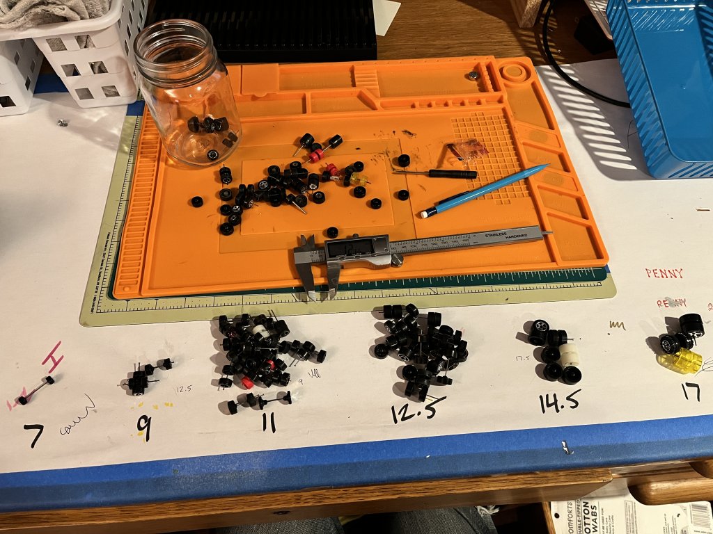

I dumped out my Jar-O-Wheels and did some imprompu measuring diameters with my calipers, and with somewhat generous rounding, the results were lumped as so:
  • 7mm (tiny, skate wheels - rare)
  • 9mm (small - rareish)
  • 11mm (medium/normal - common)
  • 12.5mm (large - common)
  • 14.5mm (xlarge - rarer)
  • 17mm (super large - rare)
And they line-up pretty close to what Google threw out too. I'm sure there are maybe some weirdo one-off sizes that came out over the years when they tried to get creative...?...dunno, but these six measurements might be plenty to start with when considering diameters.
Do your own measurements line up with these?

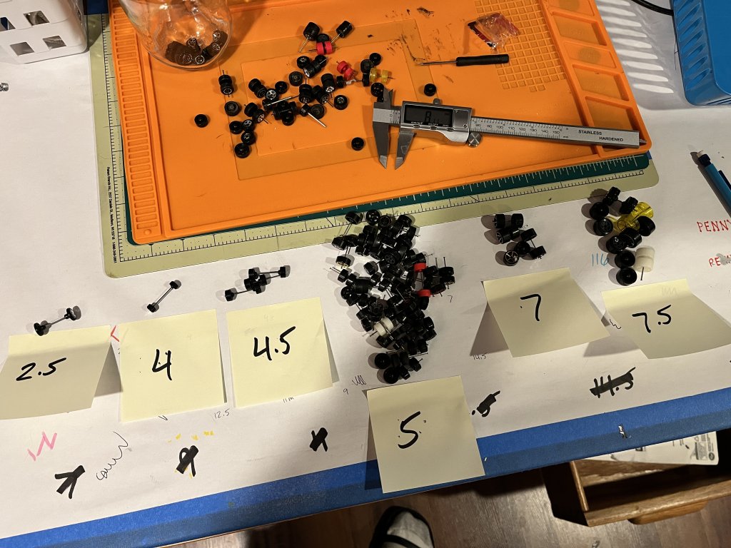

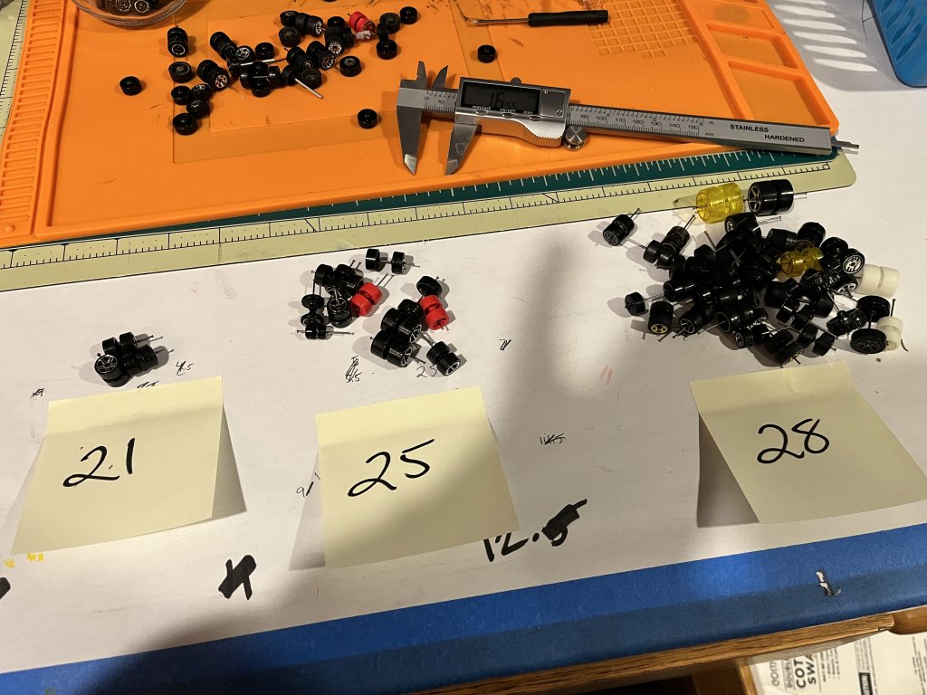

Decided to keep going...took the same sample of wheels from the jar and measured the width of the wheels and the axle lengths. I have no doubt there are other axle length sizes, certainly some shorter ones, but my jar was rather free of those. Anyhoo...just more numbers that could be options...lets see what y'all find in your stashes.
Wheel widths
  • 2.5mm (skinny)
  • 4mm (small skates)
  • 4.5mm (smalls)
  • 5mm (normal common)
  • 7mm (fat drag width)
  • 7.5mm (xlarge trucks)
The diffs between 4-4.5 and 7-7.5 might be negligible and just due to hub cap decorations that contributed to the measurement - I wasn't that careful - 4.5mm and 7.5mm might be the easiest to use.
Axle lengths
  • 21mm (most narrow I had)
  • 25mm
  • 28mm (common)
I was generous in the 25mm rounding...some where 24.7ish and others 26.3ish, but again, I wasn't that careful and some of those axle could have had bends or not been as straight, contributing to the differences. 25mm is likely the easiest number to circle around.
  • I found the 25 mm to be the most common for me ...? — ManiacMotorsports
  • Very likely...just depends on the cars you have, really. If between you, me, and a few others we can safely say, "25mm and 28mm are the most common," then we've got something to build on. — redlinederby

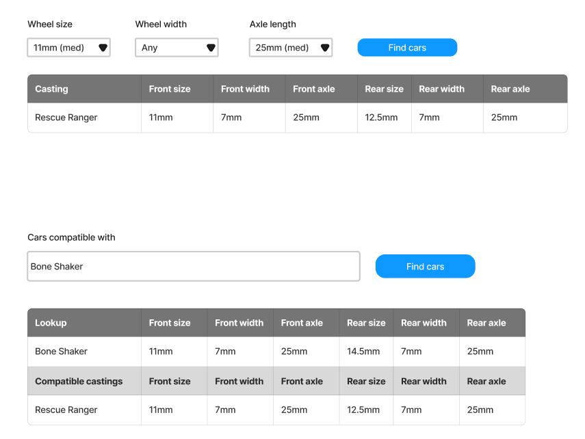

Just so you can see what's in my head with this thing...outside of just a spreadsheet...I see the lookup on the website offering a few ways to find stuff. One way could be to just list cars that have the specified size/width/axle you're looking for - or any combination thereof. Just want to find cars that have fat width tires? Great, here they are. Want cars that have fat width tires with short axles? Boom, there you go.
The other method that I thought could be helpful is just looking up the casting you're dealing with and it can list cars that would be good donors. Say you have a Bone Shaker and want to find castings that come with the size/width/axle combo that matches...just type in "Bone Shaker" and it'll list all the matches that could be helpful.
Once there's a good population of data, it could be pretty awesome. The big catch is obviously the data. It'll have to build up over time as people submit their own findings. And then you get into talks about how to govern it, update it, clean, revise...all that fun stuff. But that's a Future Us problem. Right now we have nothing so first step is to just find some common ground and starting inputing.
  • Excellent! THIS is what we need! — SpyDude
  • I originally thought looking up a casting and it would give a list of all other castings with the same wheels, but both ways have advantages. I will get some measurements posted on Sunday. Thanks again for this I think that this will be a great tool for novice and veteran alike. — Sunshine_City_Garage
