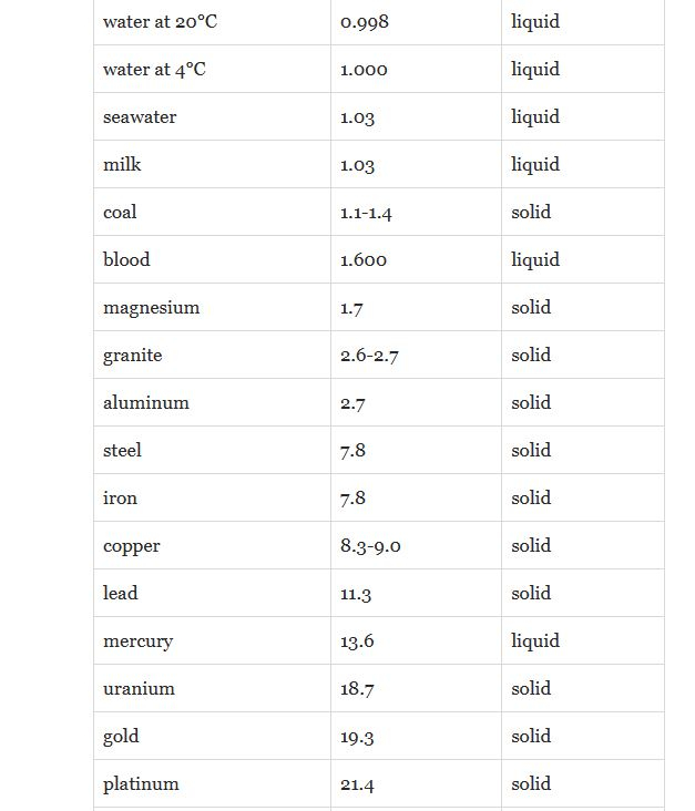

densities listed below
3d plastic on the spool, a final printed will be lower than this
common materials and their density's

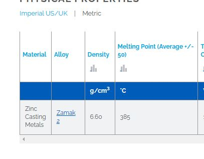

with the plastic at a density of 1, vs zanak at a 6,
the diecast parts of the car would have to be 6x thicker
silver and lead come in at about 11, and gold a whopping 19,
for the cost of a real good 3d printer, you could probably have a silver (or gold) 57 chevy body cast
(that would be a slug...lol)

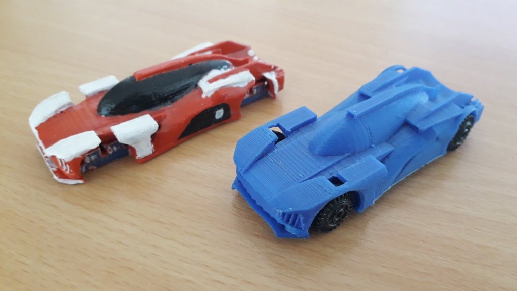

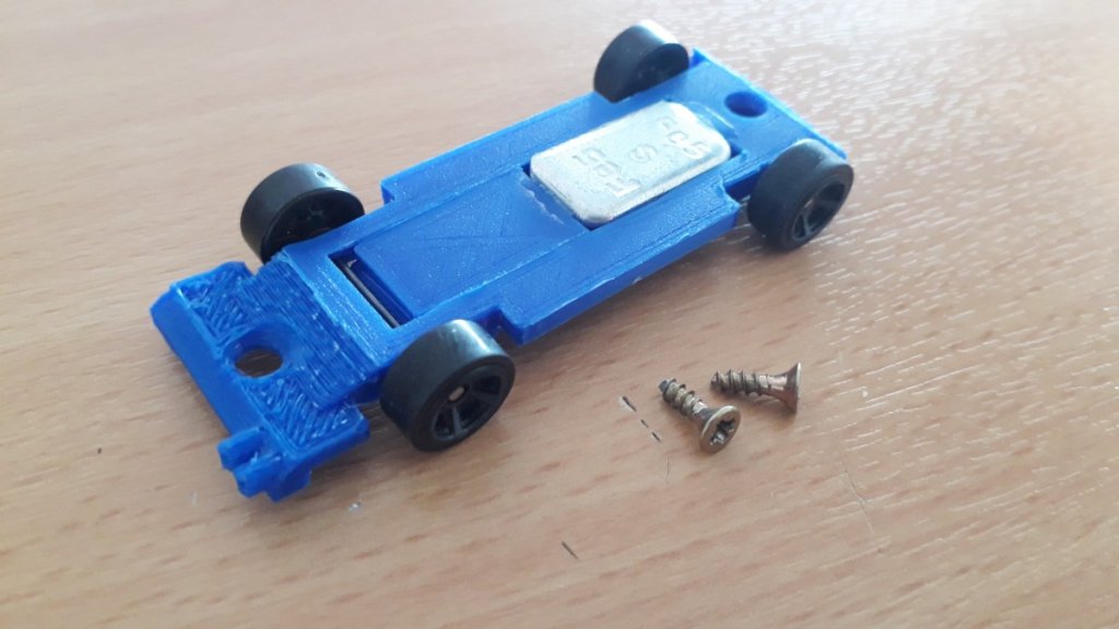

I've spent a lot of time trying to make 3D-printed cars , and I've come to understand it has just to much downsides to make a competitive car. These are the best 3D printed cars I've done:
These cars aren' heavy enough. It is possible to add them some weight, but still pretty hard to push them past 30g.

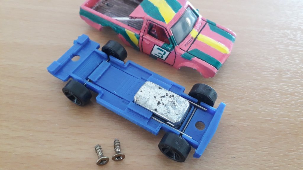

Although, 3D printing can still be useful when it comes to completely redesigning the car base, if the original base is in plastic. I've already sent cars with 3D printed bases to races, and no one complained. The main advantage is that you can do basically whatever you want (suspentions) with the base very easily and with a perfect symmetry. Here is an example:
The car body and wheels are stock, but I messed up while modifiying the base, and made it accidentaly unusable. 3D printing was the perfect solution.
- nice design on the chassis — dr_dodge
- Great design! This is most likely what I would use 3D printing for in racing. I have seen some custom builders make bases for their customs. — johnson9195

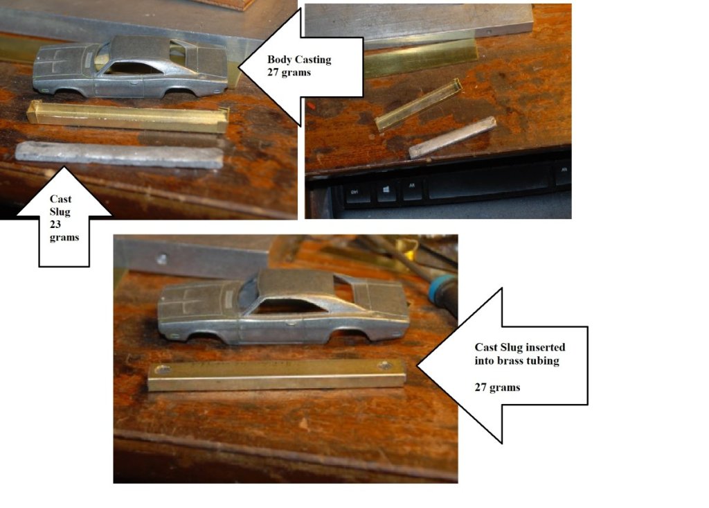

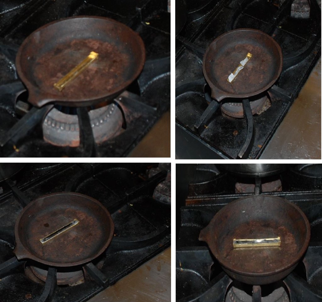

So, coincidentally, yesterday while we were discussing casting stuff, I was.
I am using 158°F "woods Metal" to make a high denstiy weight for the charger
www.rotometals.com/roto158f-low-melt-fusible-bismuth-based-alloy-ingot-woods-metal/
I made a mold out of a piece of brass tubing, set it in an old mini cast iron pan and used my stove
break the pieces into little chunks and drop them in the mold
skim the top with a skewer to remove the oxidation, and cool
the slug goes in a tubing spine, and is almost the same weight as the body untrimmed
pics below, ask away if you have more questions
(sure would be cool to cast that chassis above)
finished install of slug spine

Bismuth / tin alloy, by the way, is the answer. Cheaper than tunsten, denser than zamac, easier to melt than lead. Easy to cut, grind, drill, and tap. And less toxic.
All of the cars I have built for the upcoming Junkyard Joust have plastic bodies. My "heavy" comes in at 198g. It has the original interior, and an exceptionaly low center of gravity. And a 3D-printed skelleton as a driver!
- "Bismuth / tin alloy, by the way, is the answer." yup, and nice low temp to melt — dr_dodge
