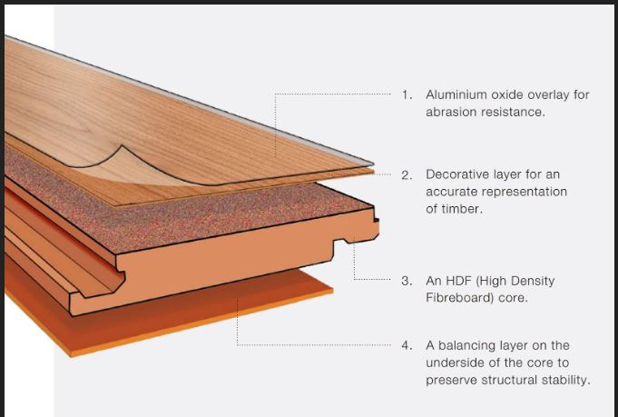

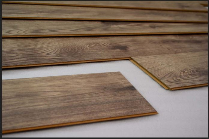

Experiments with the plasitic backed cheap flooring has given good results
won't make corners, but the straights are hard, smooth and straight
like this stuff.
the back is hard plastic
My next experiment is leaving it out in the weather/soak to disolve the fiber board,
so I can harvest a long straight,
I am planning on building a big track in my shop and all materials must be able to handle water/high humidity, so the fiberboard, and for that matter, real wood are out of play.

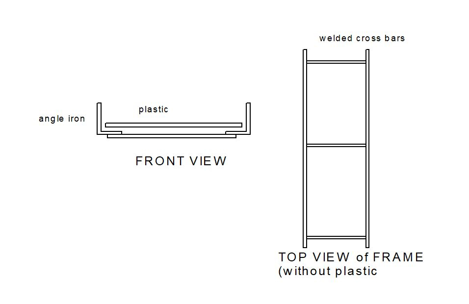

If I can "release" the plastic, the idea is something like this,
a welded tray that I can set the plastic into.
The idea is a series of rigid 6-12' "ladders" that I can then tie together (weld/bolt)
The very last segment into the infield will be a corner and wide flat out of sheetmetal with bead rolled ribs
the plan so far

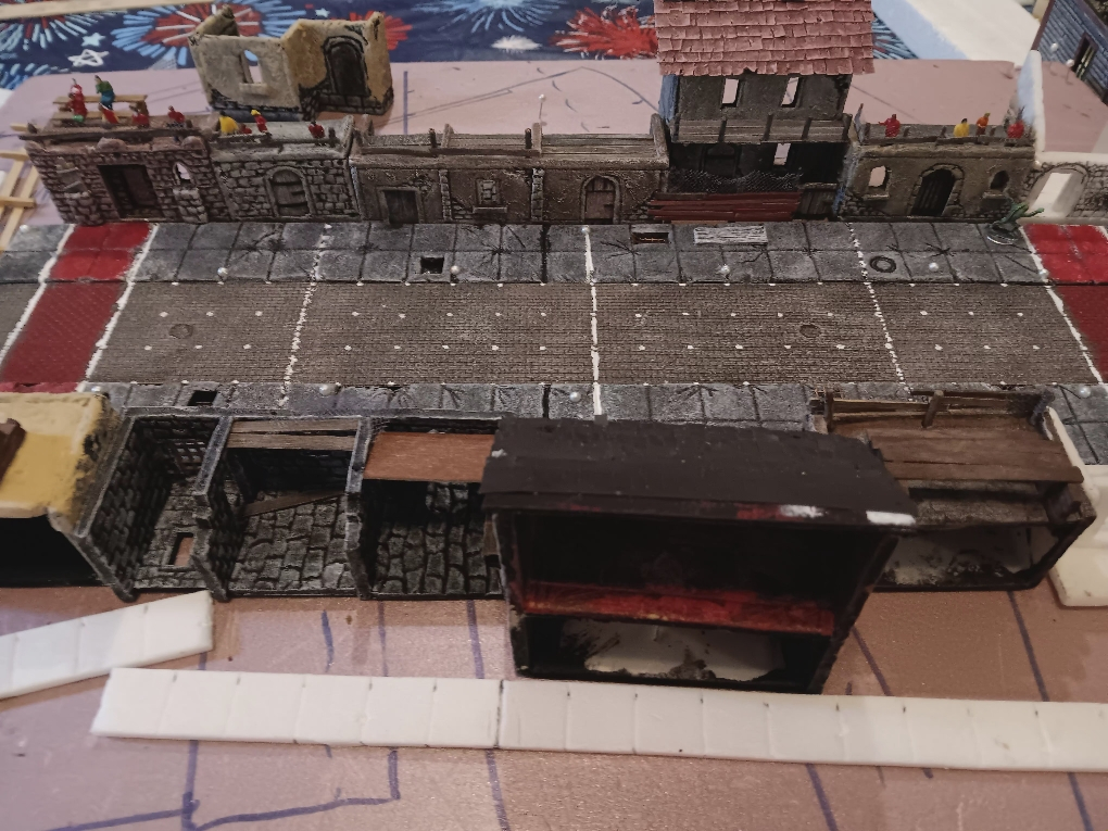

Foamboard! Remove the outer paper layer. You can make it slick, rough, or whatever, with paints and additives. It can bend, and with a PVA/water overcoat, it'll last. Easily repaired as well.
Also easily scribed/detailed.
This is a brick street (for a 15mm "Blood Bowl" street bowl stadium, it's a miniature wargame) I scribed with a ball point pen.
- Very nice work! — Stoopid_Fish_Racing
- I use foamboard too, and ti is important to take the paper off, especially when gluing up layers — dr_dodge
- Oh yeah, take the paper off the foamboard. The easiest to work with is the Dollar Tree stuff. — CanesBart
