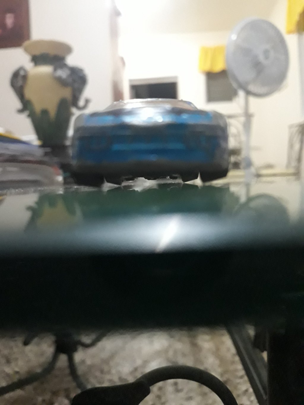

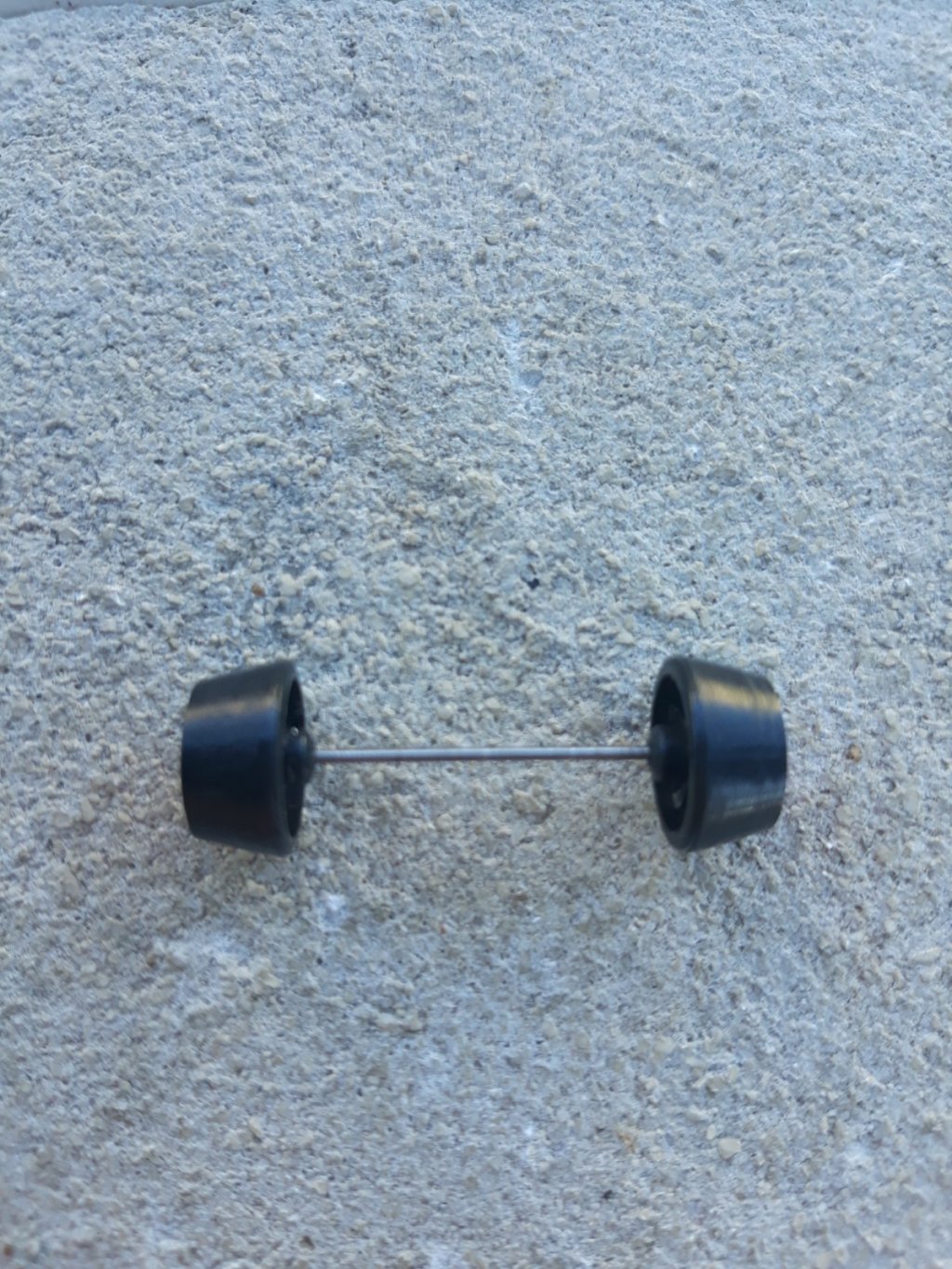

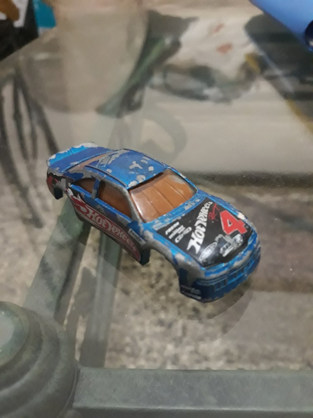

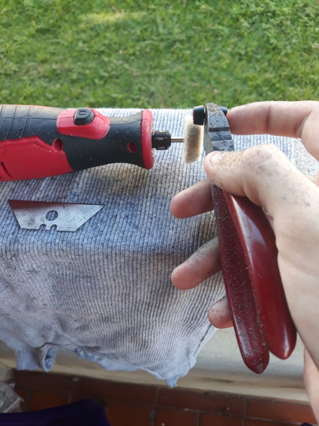

If you're part of the 3dbotmaker racing league facebook group then you've probably seen me posting about this subject but I wanted this information to reach more people. I've noticed some people purposely bending the axles so that it runs with less friction. Well, here is a better solution to that. Coning wheels. This will greatly reduce friction and you don't have to damage any axles. You're gonna need a dremel tool, a utility blade, wire cutters to hold the axle (as shown in the picture). So what you do is you use the blade to eat the wheel from the outside to the inside while the dremel tool spins it. You can do it in whatever angle you want but I should warn you that some wheels support more aggressive angles and some don't. You have to test that for yourself. Here is an old Nascar car I dug up to demonstrate the process. I took it apart, put some weight on it (54 grams) and worked on some spare wheels I had to revive it. The 4th picture shows you how the car sits with its new wheels. I've never looked back since then. It doesn't affect stability either, cars roll nicer, better and smoother than flat wheels. Speaking of smooth, this method also skips the sanding process, as it is no longer needed. I will be posting more pictures of other cars I've done over the past year. Hope this helps anyone that wishes to be faster on the track!
Looks like you could over heat and possibly melt the hub during this process by the speed of the Dremel over heating the wheels? Any thoughts on this?
- Yes, it does happen sometimes. What I do is wait a couple seconds until the wheel cools down and I start cutting it again. With patience, you can master the technique and it'll give you great results — Ralph_Technology97
- I've also had cases where if the wheel wobbled originally, once it starts spinning and gaining some heat, it'll actually correct that wobble for you and giving you a great wheelspin in the process — Ralph_Technology97
- But again, you gotta have some patience. It doesn't take long if your blade is fresh so it's a minor inconvenience but be delicate and precise and you'll get the hang of it — Ralph_Technology97
- Re Ralph's Quote: "where if the wheel wobbled originally, once it starts spinning and gaining some heat, it'll actually correct that wobble for you and giving you a great wheelspin in the process — Ralph_Technology97" I would imagine if you corrected wheel wobble, that probably would be that through coning the wheels, you corrected an "out of round wheel" Just my thought. Cheers — CutRock_R_Marc_D
- Exactly! Thanks to heat and continous spinning it allows the plastic wheel to reshape — Ralph_Technology97

I'm confused. You use the pliers to hold the axle, but don't the wheels still spin on the axle?
How do you use the utility blade to cut the wheels?
I'm not a tool use savvy guy, and I could use a YouTube video to explain this process to me.
The theory fascinates me and I'd like to learn more, but as I said, the spinning wheels are a huge obstacle.
- You want the wheel to spin. Hold the axle with the pliers and have your dremel tool spin the wheel and with light pressure you use the blade to cut the wheel. Its easier if you have a bench vise. I don't or I would make a video it's not difficult — NDeavers80
- Okay, I get the picture better now. I think I can figure out the logistics of it. My brain doesn't work like it used to before my stroke, so simple things sometimes elude me. Thanks Nick for breaking it down for me. — Peter_Bee
- You're welcome — NDeavers80
