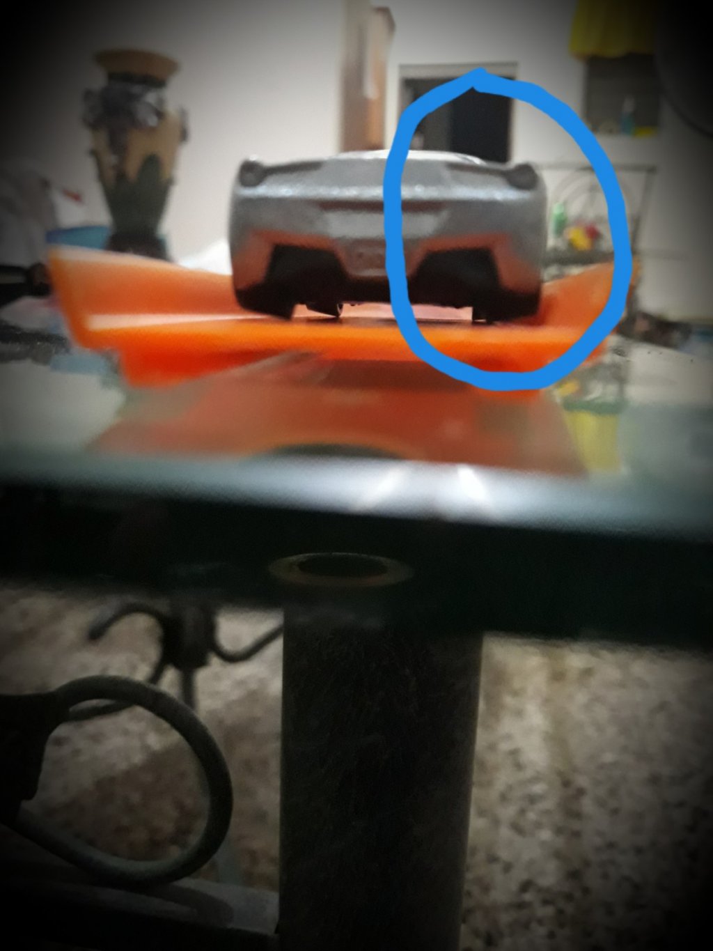

After testing this technique numerous times it resulted in faster runs on the track as it reduces friction greatly. But I noticed that on cars with a wide wheelbase it provided other contact points. 6 to be exact. I used 2 Ferrari Italias for this demonstration since it has a wide wheelbase. In the first pic you can see how the outside-inside coned wheels rub against the track a total of 6 times (including on the wall) Here is picture #1:

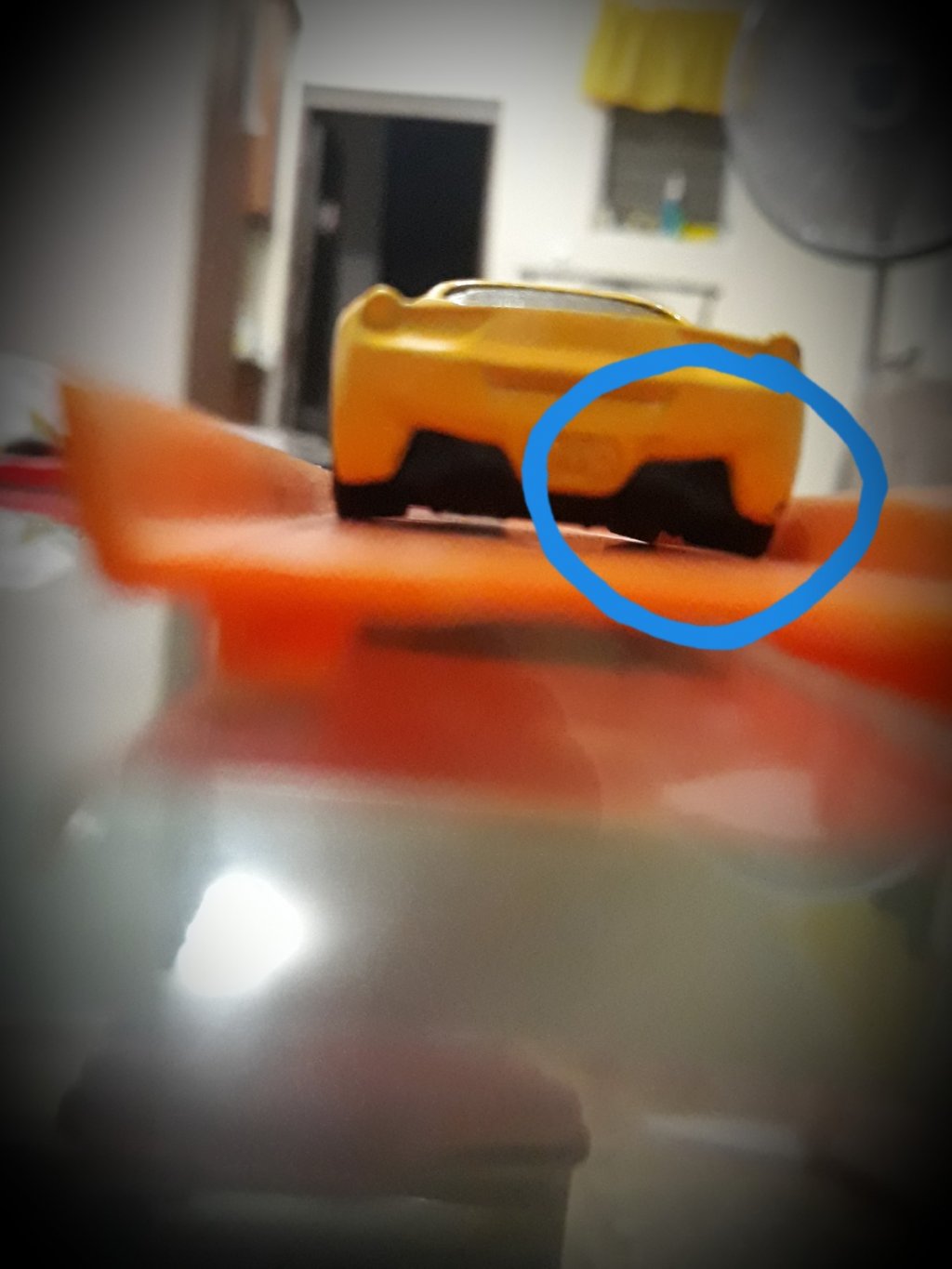

Cars are going to ride the track walls on occassions so I had to find a way to eliminate that problem. I then started coning them from the inside-outside instead of from the outside-inside. It worked! If the car decides to ride the wall it will only do so on one contact point per wheel. Now I have 4 contact points in total. This resulted in faster runs since friction was reduced even more. Here is picture #2:
I hope this helps anyone that wants to be faster on the track!

Good to have confirmation but I had thought it would make more sense to have the outside be the contact point for added stability as well. Is this just on drag tracks or have you tested it on fat track as well?
  • Stability has never been an issue when coning wheels in any style. I have not tried this on fat track but my guess is it will work just fine and maybe even better as your car is running with less resistance on the wheels. Hope this helps :) — Ralph_Technology97

I am wondering why they are coned with the shorter side out? Ah... saw the second photo with the cone facing in... now that makes more sense to me.
