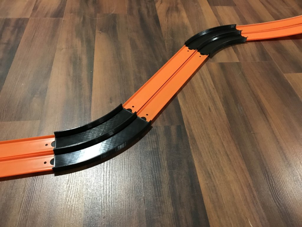

Slanman Customs also provided me with two, 2-lane, 45-degree angle flat curves. This was probably the track accessory I was looking most forward to trying out.
It seems laned curves are difficult to find. The official Hot Wheels sets often offer 180-degree turns but they're also usually only 1-lane. Slanman's 45-degree turns let you choose how far you want things to go. You can make a 90-degree turn with two curves, or further up to a 180 or even a full circle if you want. Pretty cool.
The first thing I had in mind with the curves was to make a slalom section. I made a simple, low-angle test track on my floor just to see how the parts would hold up in a simple setup. I ran several different castings down my little track and only a few cars made it through the slalom. I can't say if it was the cars or the track, so this isn't a ding against the curves at all, just an observation I had during my tests. It seemed putting curves back-to-back might not result in the most consistent racing. Bummer.
However, I tried again with adding a straight section between the curves and cars did much better. Again, I doubt it has to do with the curves or the hard plastic, but if you're looking at these curves thinking about making a nice S-style section in your track, just try adding a little buffer between them.
One issue I did have with these curves was the connectors. Included with the kit are some proprietary track connectors you need to connect to orange track or between additional curves. This would be fine but the connectors are not easy to slide in or out. Once you manage to get them into the curve track, they are nice and snug, which is good, but then it's not easy to disconnect them without feeling like you're going to break something. The plastic is rigid so you can't really flex or wiggle it like you can the Hot Wheels plastic, and that makes it feel a little brittle.
If you're using these curves in a track layout that is somewhat permanent and wouldn't need to be taken apart often, you'll be fine. But if you're using these curves during play time and need to take everything apart for storage, I could see the connectors (or the female slots on the curves) breaking. There's also the possibility of losing some connectors and not having a quick source for replacements since you'd have to order more.

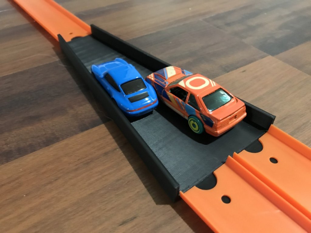

2-to-1 Lane Merger
Last but not least, included in my Slanman Customs review kit was a 2-to-1 lane merger. The piece I got supports orange track and claims to work with Crash Racers track but I wasn't able to test that since I don't have any of that brand.
But...really...there's not too much to say about the merger. It's a merger. It does what it says it will do. The connectors work great and keep things snug. One thing I did notice was the merger has straight walls rather than the flared/rounded design of some of the retail Hot Wheels mergers. I'm not sure if that makes a difference in the probability of cars getting stuck or not, but that happened a lot during my testing.
A simple 2-lane merge will run you $15 at the Slanman Customs store on Facebook. There is also a Sizzler-compatible merger which is also $15.

Hey there! Thanks for the great review. I just wanted to follow up your post and let people know that almost every point you brought up has already been corrected in the last few weeks.
I got some new magnets that are a little bit stronger inside the gate. The connectors are still a little tight, but I would prefer that over the track sliding off. They can be sanded down a little bit to fit how you would like. I'm also doing two screws holding the track connector pieces on instead of one.
With the curves, I did a revision on the connectors because they were too tight and hard to get in. I didn't want them pulling apart during the races, but it was a little too much!
I have tried multiple configurations with the curves on my track - 90, 180, S, etc - and I wasn't having issues with the cars making it through. I would suggest having them at a downhill angle and set them up so cars don't go full speed into them. But I'm definitely open to suggestions or ideas for making them even better! I have a few videos of them in action on my Facebook page.
