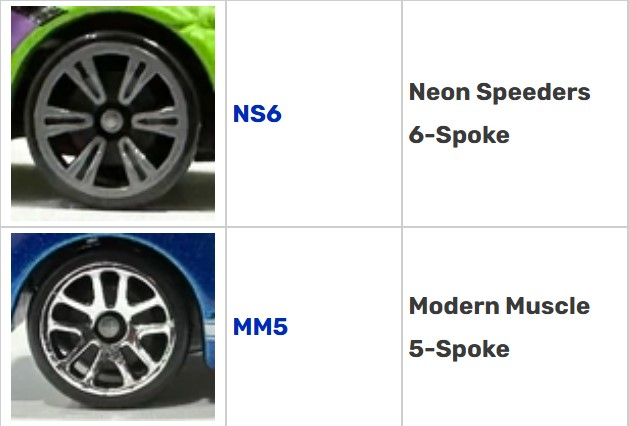

One theory I find fascinating is that wheels with minimal construction and less mass have an advantage. Less mass, less rolling resistance, more speed. I don't have the math & physics to explain deeper, sorry. Wheel diameter plays a role too, with larger wheels giving higher top-end speed and smaller wheels skewing to faster acceleration. Here are some broad examples among the dozens and dozens of styles you can find online and at the pegs, purely to illustrate this concept
These above are the styles that 1st and 2nd gen FTEs were based on. Note all the empty space within.

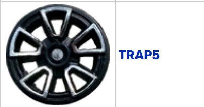

Not the best photo, but beyond the spokes is still plenty of that empty negative space. Now for a counter-example:

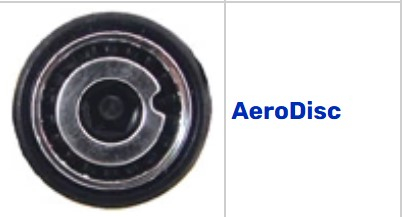

See? Very solid throughout, no spaces at all. According to the theory, these wheels will work against you in a build

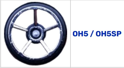

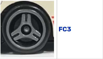

These last two styles intrigue me, they show the qualities of empty space, potentially less mass. However as they are exclusive to Hot Wheels models of cars selling for well above mainline car prices, not as easy to "farm." I have not seen these frequently in modified racing events
