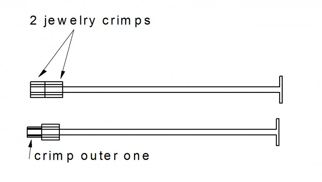

Does anyone have a good way to create a new head on an axle?  Sometimes you find one good wheel in a set, but want to replace the other.  Besides cutting and tubing - is there a good way to cut the axle, replace the bad wheel with a good one, then pound out a new head, to keep the wheel on?  I have tried a few different techniques, but haven't had much luck.
dr_dodge 10/11/23
I have experimented with this
