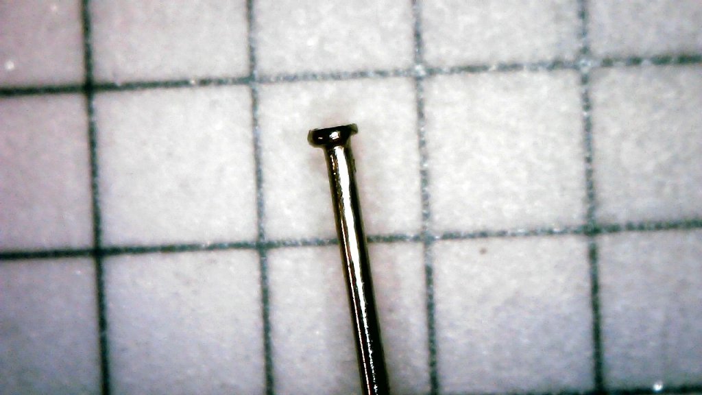

Malformed heads and axles that aren't round would be my guess for the wobble. Sadly these are the norm and not the exception. Can you see the fold in the metal when the rod was manufactured?
- Good point. I may try #17 pins... — G_ForceRacing
- Nice polish you got on there. What polish do you use? I know this is an old thread and how many times do you polish each set? Do you have a process? — D_Built_Garage
- Flitz polish paste. don't get the liquid. felt buffing wheel on dremel, polish until it looks good and wheels spin 10 seconds or longer. — Redline_Salvage_Inc
- Thanks for sharing Redline_Salvage_Inc. I just repolished one of my cars! — D_Built_Garage
