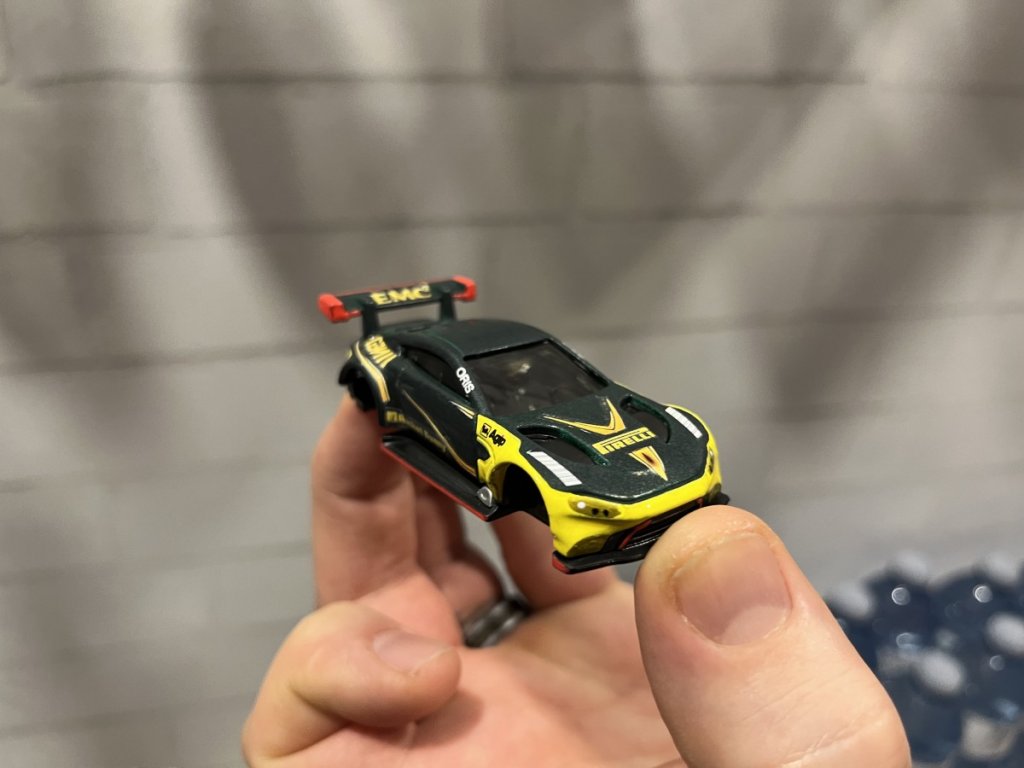

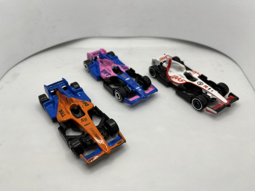

Generic rattle cans...mostly "painters touch"... I also freehand with Acrylic Paint Markers as they don't react with clear coat. Oil based paint markers don't like the water based clear...
Ive experimented with chalk markers as well. Those will glow under black light, but decals don't typically like to lay down on the chalk. If I need decals over the chalk I will clear coat once I'm happy with the design, then lay down decals.
half the fun is experimenting... so just have at it!
BRG rattle can base
Yellow acrylic paint marker
waterslide decals

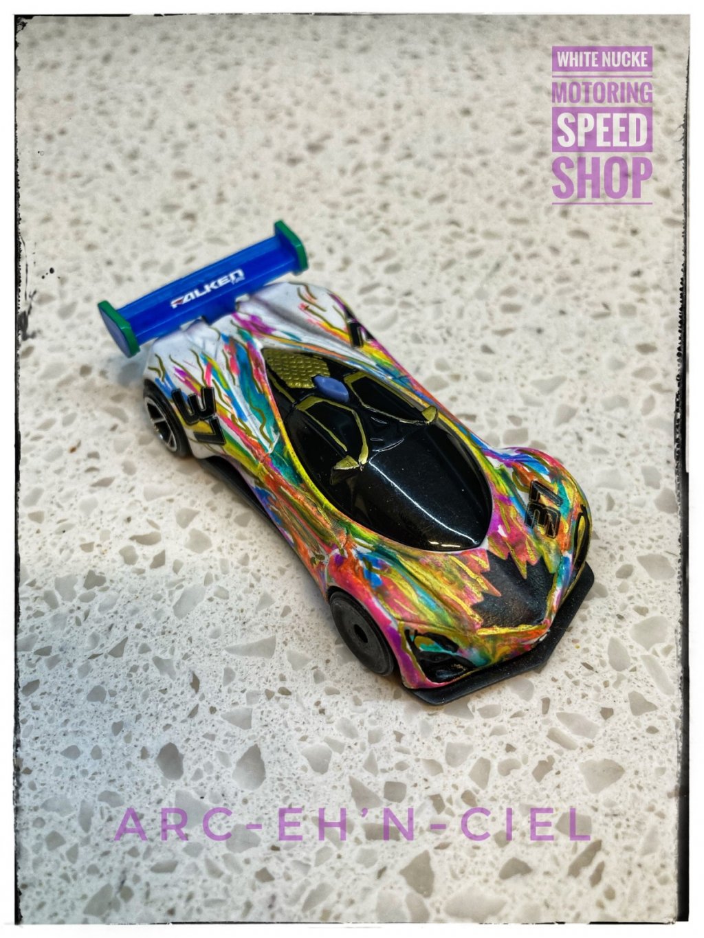

more examples of paint pens over rattle cans
chalk markers mixed/blended then gold acrylic applied to highlight

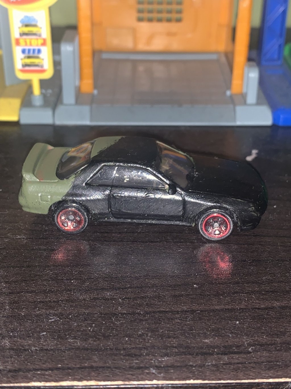

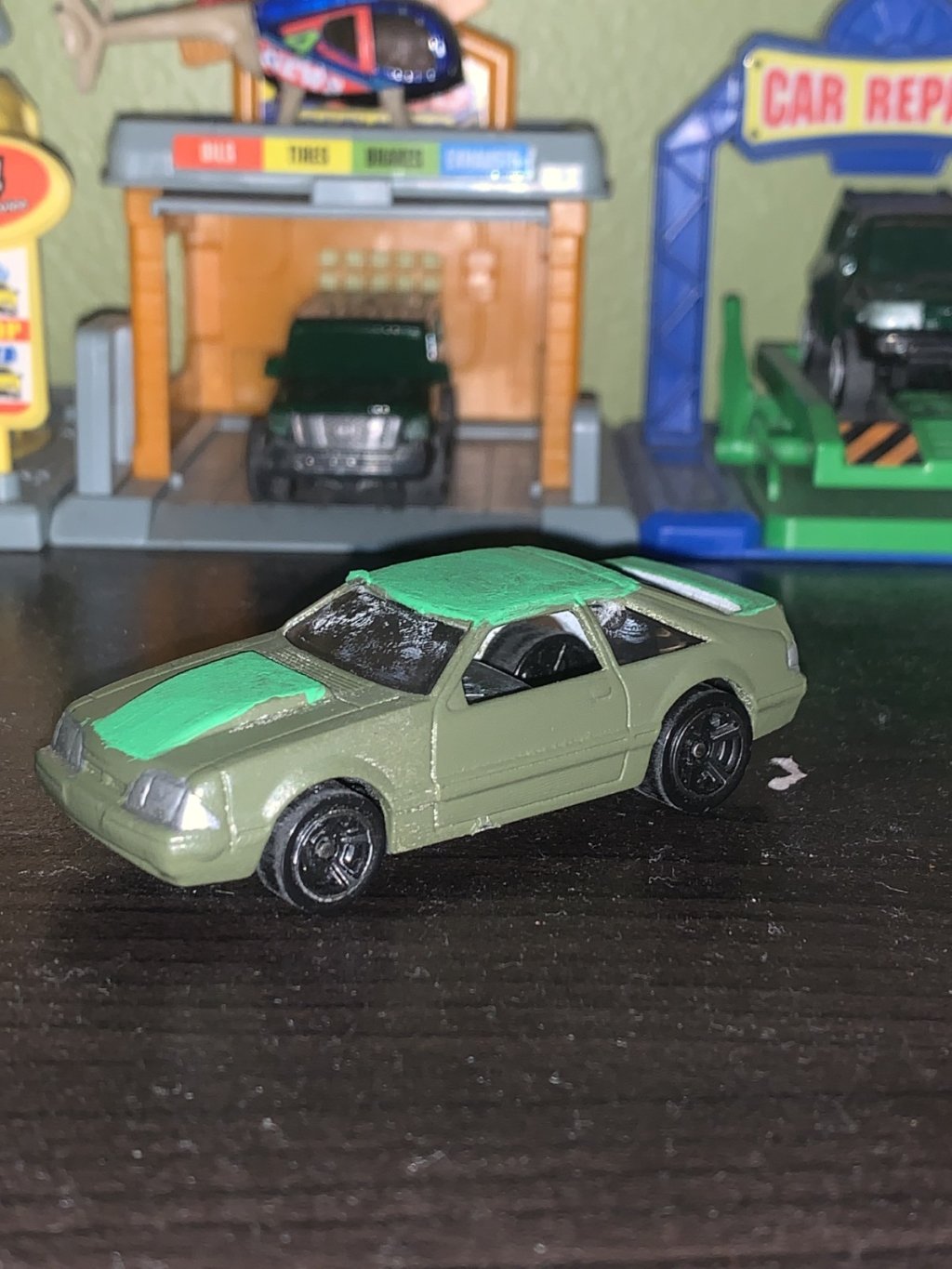

Just a couple examples.
I just use Rustoleum for my cars
works okay and gets the job done.

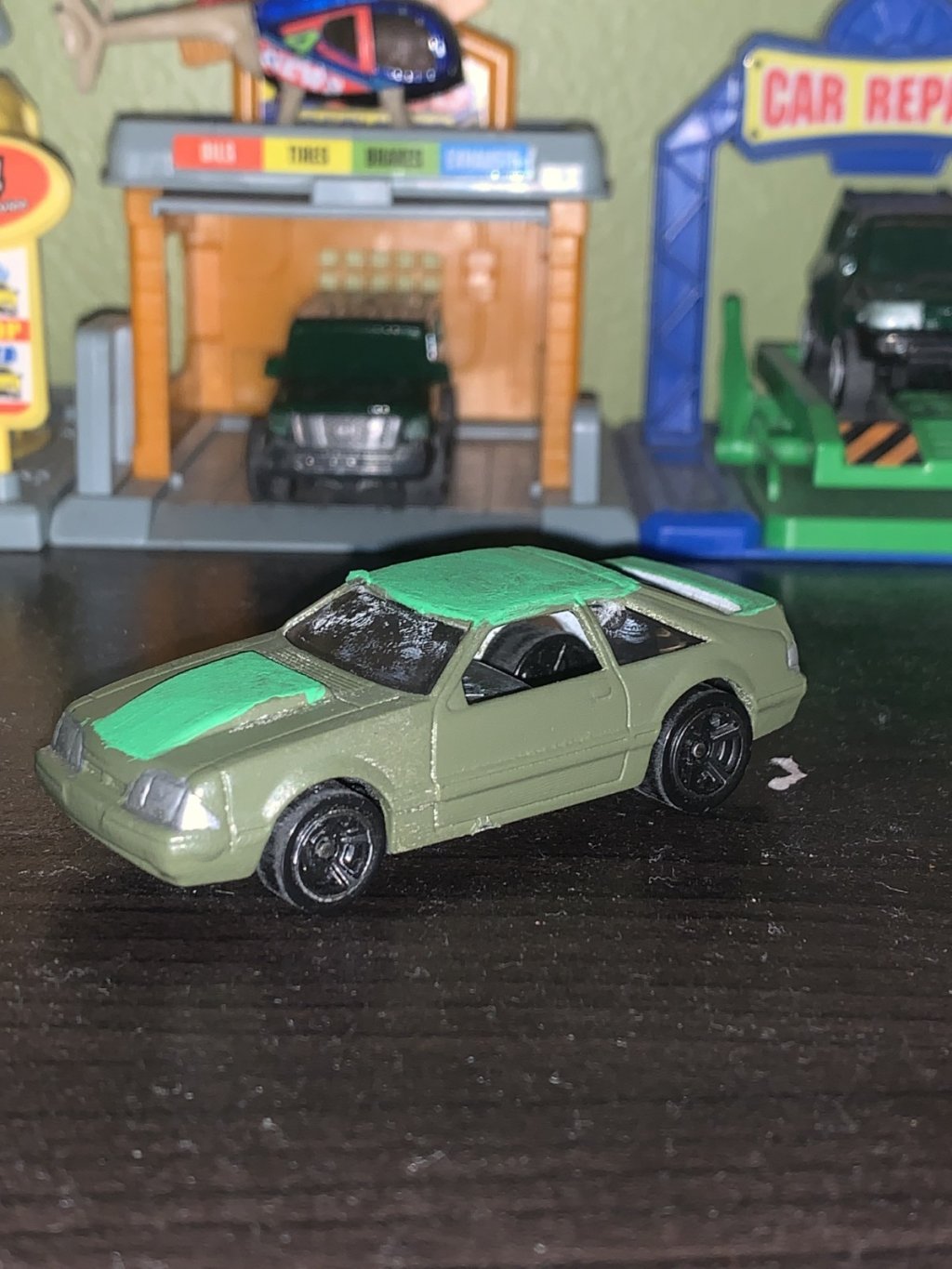

This is how I look trying to paint cars nicely....
I use rustoleum so far but I want to try others. From what I could find it's the only "cost-effective" option, paint can get expensive fast
The problem with it is it's really easy to spray on too thick, ruining the diecast details and giving you a clumpy texture. So each time before painting, I soak the can in warm water, and I try to do multiple very thin coats of paint (only a few sprays per coat)

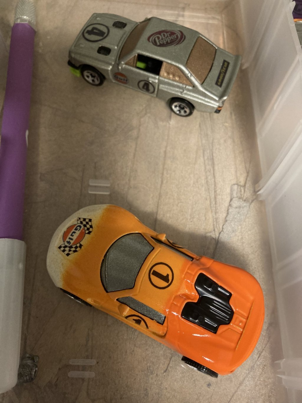

I use a mix of rattle cans, airbrush and posca paint pens. Depends on the finish I'm going for. Sometimes I'll also brush on some of my airbrush paints, particularly if I'm doing rust effects.
