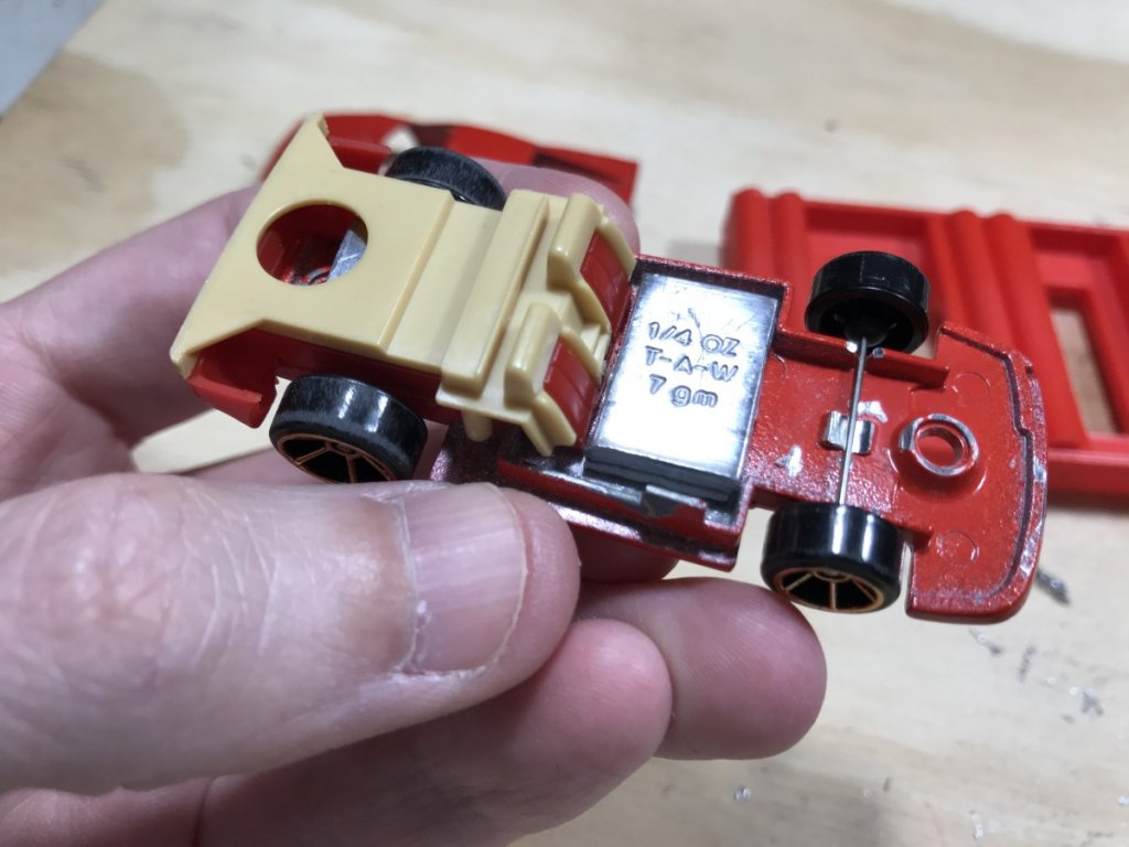

My first disocvery was the lower rear of the car was plastic...two mold plastic, to be exact. I didn't pay that close attention to it when I picked it, but whatever. I thought the lack of weight might be a problem but made up for it later.

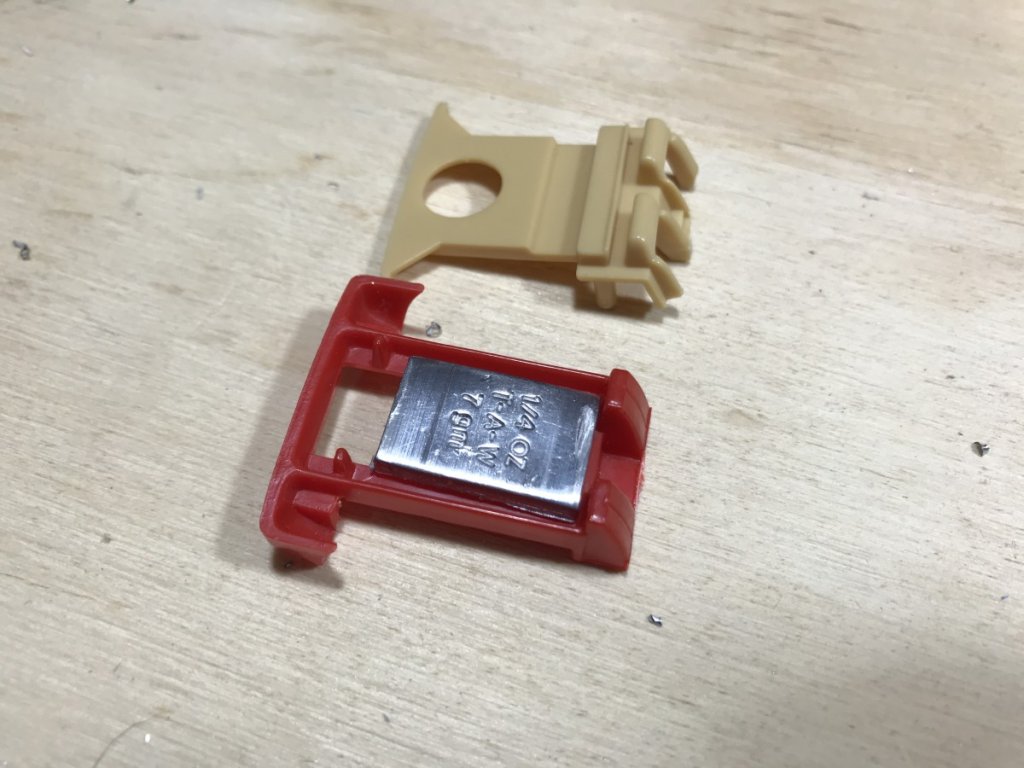

The plastic turned out to have its benefits, like creating a perfect little pocket for some weight. It kept the weight a little higher than it would otherwise, so hopefully that will help.

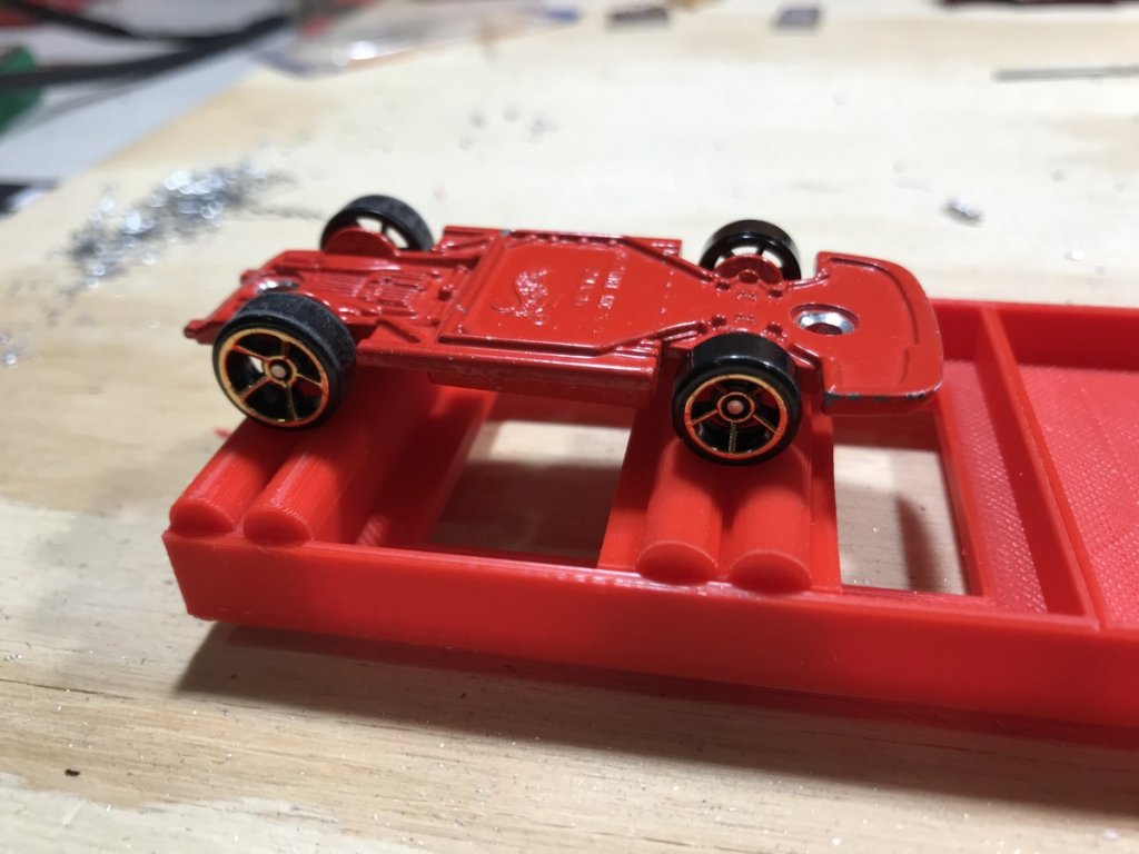

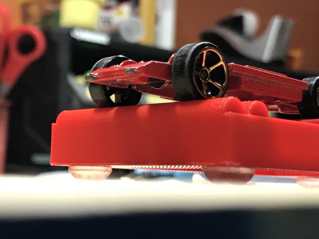

Next step was fixing the FTEs in place. I mixed up a few dabs of JB Kwik as usual, put it on the chassis and them laid it on the axles while on the RLD Alignment Jig and waited. I learned to put the chassis upsidedown on a jig to get the most out of gravity, but I've been asked if the epoxy drips. You can see here that the epoxy does "sag" but it doesn't drip. It cures fast enough and is thick enough (it shouldn't be too runny).

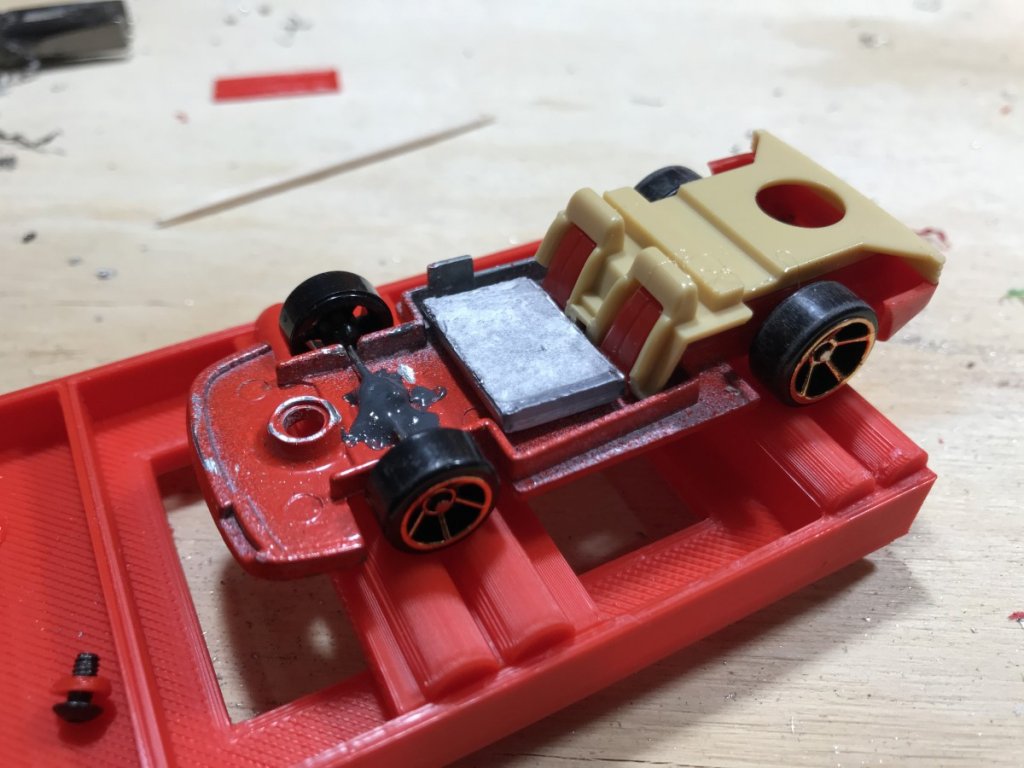

Once the epoxy set, I could flip it over and work on getting the interior and weight into place for testing. I used hot glue to place the weights so they'd hold during test runs. Hot glue is great because it holds well enough but can easily be pried off without injury to the car. Just pops right off.
Next step was some test runs. I used drilled some screw holes into the body posts and then followed Matt's directions for "force tapping" with some 2-56 screws and it worked great. I didn't drill down far enough at first, so I used some small plastic washers to make up the difference. It turned out nice and tight. It's wonderful to have the ability to button up, test, and take apart without much hassle.

As for the build, you might actually be better off removing the front weight on the seats. Ideally you want the weight as far back as possible so if you can put it with the rear weight that would be best, but if not, just removing it completely might help.
