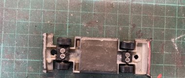

I only tend to glue mine in place for two reasons, one I broke the damn tabs off when removing the axles, or the casting seems to wobble about when racing due to the axle being too loose, so gluing it in place stops it swaying about.
Of course, I also made those new axle holders (in a previous thread) where it clamps a pin in place and that is working really well - it's on Five-0 in the Canyon Outlaws, the current #1 on the list.
To me, it feels that the looser axle also allows for some axle rotation, so if the hole in the wheel isn't perfect or the axle isn't either, it then allows for a little extra leeway and speed, but if you lock the axle down and the wheel/axles aren't perfectly symetrical then you're more likely to slow the casting down.
