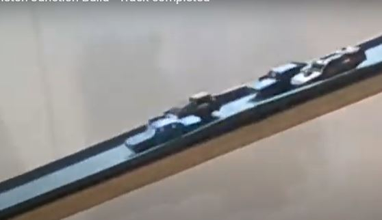

Piston Junction is coming along.
StarCorps Wednesday, 8/2/2023
youtu.be/b2dvjDze2L4
I need to figure out how to smooth the exits from the turns.
Feedback and ideas are VERY welcome.

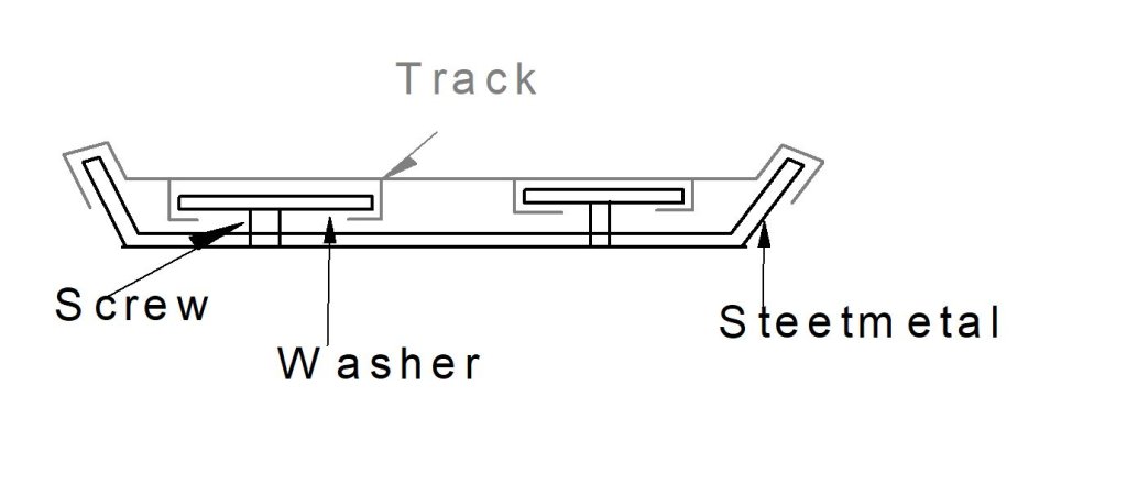

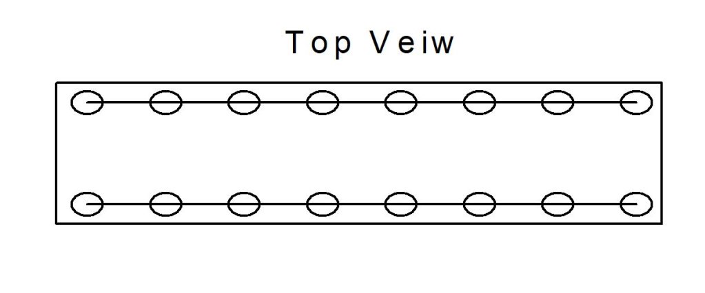

I would suggest, flat rigidness is needed under the track.  The crash track I've played with is very floppy, and resists holding a uniform shape consistantly.
If you look at the pic above, this is what I was fighting.  The connector holds the track shape only to have it flatten out right after.  I used extra (slanman) connectors in the track before and after and it at least lengthened the transition, and helped a ton.  When I finally build the big track, I planned on using some sort of rigid (probably 18-16 ga sheet metal) pieces to hold the sidewalls straighter and truer, and secure with 1" washers in the center (diagram below)
  • Yeah! I actualy ordered a lot extra to have more anchors, but I have not perminiantly installed them all because I am still working with the angles and flow. — StarCorps
  • But this is some great feedback! I really appreciate it. — StarCorps
  • youare very welcome — dr_dodge
