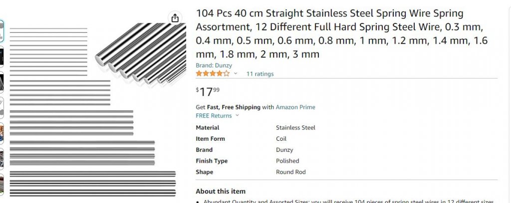

The death star (amazon)delivered these last week
for experimenting with springs
www.amazon.com/Straight-Stainless-Spring-Assortment-Different/dp/B0B491L6LV/ref=sr_1_4?keywords=piano+wire&qid=1672246468&sr=8-4
an other possibility. Works really good for me.
